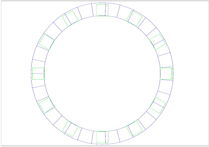

I don't quite follow the movement part and how rotating that doesn't effect what is being showed on the dial. I am attaching 2 diagrams. It's a drawing of the 515 movement with date and stem at 3h position. The second is the  same thing but rotating the crown to the 4h position.
First 3h
Second rotated to 4h

I'm not sure that we are talking about the same watch. As can be seen in the picture below (taken from the original post) the watch has the crown @ 4, and the date @ 4:24;  30° and 42° offset from the 3 position respectively.WATCH.jpg.232e50abe5c17a2436247b345d22513a.jpg
To bring the date window alignment concurrent with the crown (as would be the case with a watch that has both date and crown at 3) the date window in the dial would have to be moved 12° anticlockwise relative to the dial numbering, which would put the date at 4 concurrent with the crown. If you then move the dial feet 30° clockwise you would then have a dial that would result in both crown and date window at 3, however let's keep the date window and crown at 4.
The problem is that the date wheel detents which hold the date ring in the correct position to show the date in the window are spaced at 11.61290323° (360/31) intervals and not 12°, and the date jumper is fixed in the same position in the movement regardless of date window position. Therefore displacing the date window in the dial by 12° without displacing the date wheel printing relative to the date wheel detents by the same 12° will result in a misalignment between window and numbers of 0.387°.
The drawings below illustrate the problem, the first in general and the second in detail.
There are in fact 31 possible positions on a dial where you could site the date window without having to change the date wheel printing relative to the date wheel detents and they are at 23 minute and 13.548 second intervals. To put it another way the drawing below shows a date wheel that aligns correctly with a date window at 3, with possible date windows at all the other hour positions. Only the 3 position is correctly aligned.5b085843ae98a_DIAL3.jpg.b876159bb7f2b1cbd8e9a5536e713ce9.jpg
If the OP simply does a movement swap with a standard (date @ 3 position) movement without changing out the date wheel for the original there will be a slight but noticeable angular misalignment between the window and the date wheel printing.
