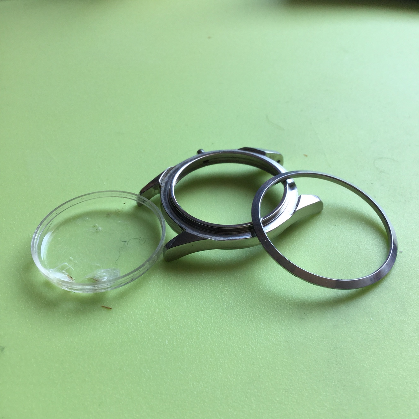

I have a few watches waiting for replacement crystal where the design isn’t the usual snap-in for which I have used my claw-like tool for removal and insert.
These are presumably much more precise as they fit snugly onto an edge in the case and are kept in place by a ring that is pressed on top.
A photo is attached.
My assumption is that these crystals must be defined by the inner diameter (and possibly the edge thickness) that goes onto the case.
Going into ex. Cousins pages on crystals makes my head spin with the huge variety that seems to exist and I thought I might save myself from learning the hard way and ordering the wrong ones by asking you guys...
The watches are ordinary Citizens and Seikos, so I guess it shouldn’t be that hard if you have been there, done that a few times...?

If I get you right, this means I should look for replacements designed for these specific cases rather than looking among the more generic types from Sternkreuz and others?
The one in the photo actually belongs to a Citizen Newmaster Jet Autodater with its rather special auto-winding design. I tried to Google for the various numbers I see on the back cover but nothing relevant has come up. I even posted a question on a website/forum specializing on Citizen watches but had zero response.

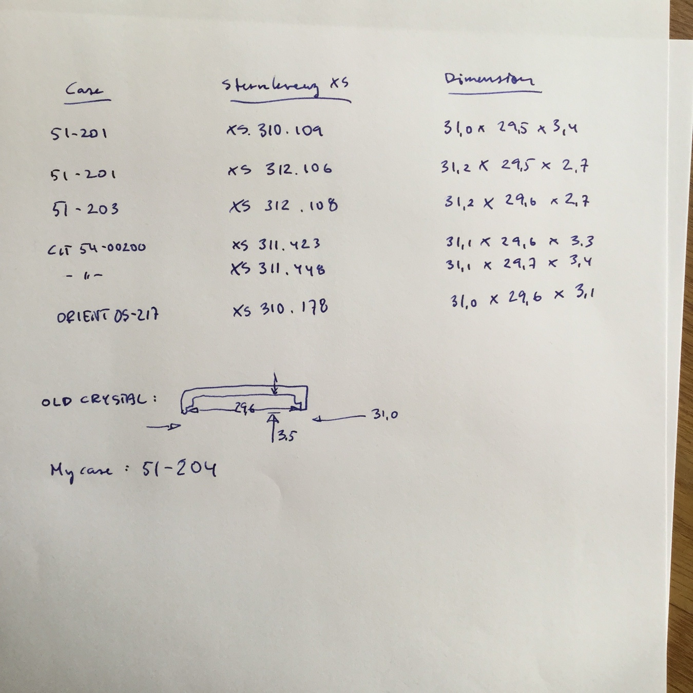

It appeared to be the Sternkreutz SX series that would be in direction of my Citizen that is marked 51-204 on the case back.
To begin with, it looked pretty bright as I found both 51-201 & 51-203.
But then obviously nothing for 51-204 :-(
Another complication is that my existing crystal has a quite significant inner height of 3,5 mm which (if really needed, which is hard for me to estimate) reduces the alternatives further.
I took some notes on what could be in the neighborhood of the original. You find it attached.
An even further complication is that my crystal has a magnifier for the date which in practise seem to reduce the alternatives to a very round figure ”0”. I guess I can do without that though.
I find the problem a bit strange as I have seen several photos of this watch on the web with the same 51-204 print on the back and it’s hard to accept that I should be the only one in need of swapping out a bad crystal...
I call these cup shaped. Rare, but do exists even as generic. I suppose that with the right equipment one could UV glue a ring under a more normal crystal.
Quote
The "cyclop" is not a problem, remove from another watch or buy on Ebay.
Yes, I think so...
I checked the Citizen pages crossreferencing to casings but that part only deals with casings as 54-xxxxx and none of mine 51-xxx type are mentioned.
The potential alternatives I found were all under the XS series and I guess my best bet is to try from these.
The generic snap-on type could have been an alternative if one could somehow derive the inner diameter but the edge thickness is nowhere to be found as far as I can see.
