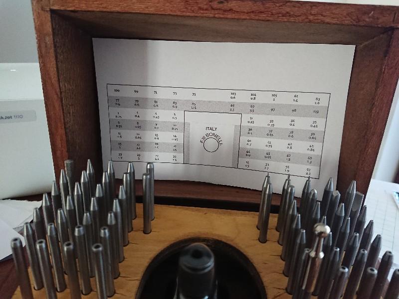

I've realized why I wrote that not all are the same size, because mine is not. Stakes are 4.5mm but stumps (of which I have none ATM) are 4mm. The numbering is also different from Boley. I took the chance to reorder the set and make a labelling chart.

Looks identical to what I have save the front two rows are all empty and there are a few of the stakes missing in the upper 72 positions. I recently organized my set and was struck by how much variance there was. Originally a K&D set there were about 7 or 8 Boley tools which didn't seem to fit in anywhere. Also I found that the tools with the capital S prefix follow a different system than the tools with an X suffix. Now that I have the remaining set organized according to a standard (see: K&D Table of Punches)--and primarily am using the X variety, I have a starting point upon which to build. I might even try making a tool out of left-overs should my skills get to that point.
