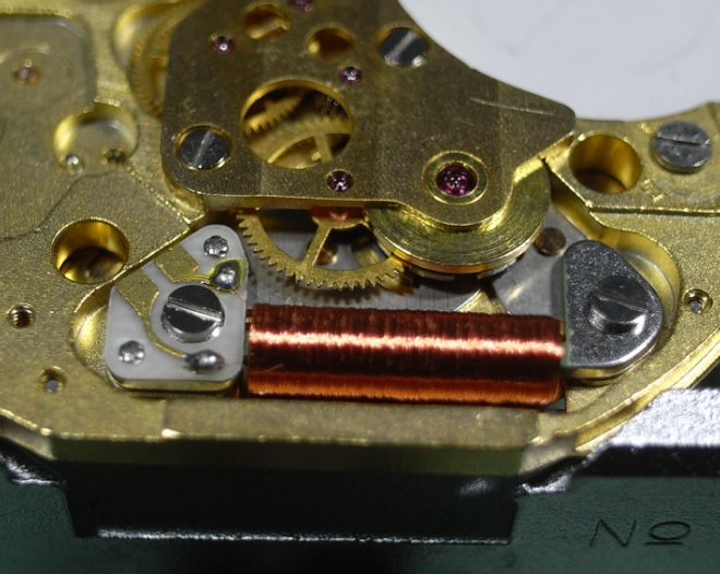

Remove the Battery Clamp and Insulator Ring.
Then remove the 4 screws that hold the Circuit Cover.
Note that there is an insulator under the cover.  It is very delicate, so great care should be taken when handling it.
Once the cover is removed the circuit is exposed; but before removing it, unscrew the 2 screws holding the Coil Protector and remove it.
Then unscrew the Coil, and remove the Circuit and Coil.
Place both the Circuit and Coil in a safe place to avoid damage, as this parts are obsolete, and if damaged you'll have to scour the internet for a donor movement ... good luck with that!!

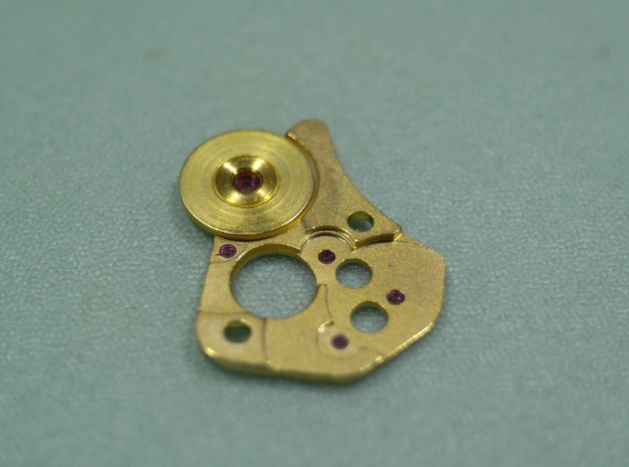

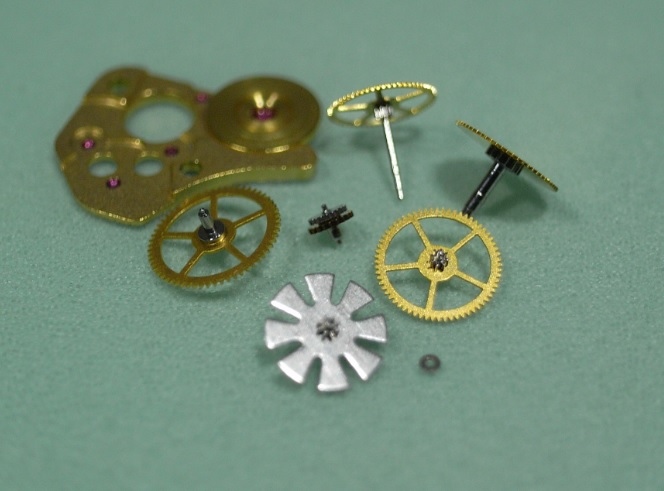

Next remove the Train Bridge
Here is a reference photo of the train. As you can see, the Rotor is a very different looking animal to the modern ETA rotors.
Carefully remove all the wheels, and store the Rotor in a safe place AWAY from the rest of the parts to be cleaned ... as this has to be hand cleaned due to it being magnetic.
Please Note: There is a very small washer that fits between the minute wheel and the extended pivot of the Second Wheel.
Be sure to identify it, and make sure it's put in the small parts container for cleaning.
Here's the complete train removed from the movement for reference.

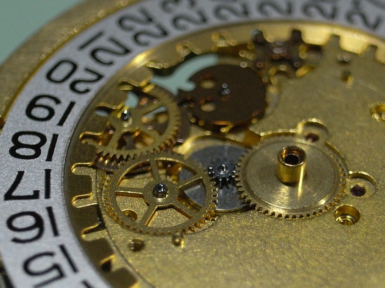

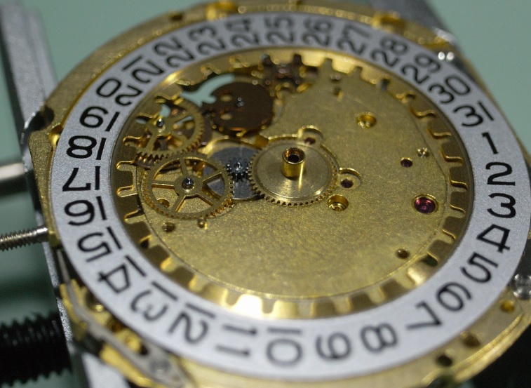

Flip the movement over in the holder and remove the 3 screws of the cover that holds the Calendar Ring.
As you can see that Motion Work and Calendar Work are fairly complex on this movement.
Make sure you take good reference photos and study them carefully so they are not confused with wheels of the train.
Remove the Calendar Ring.
Remove the Motion Work and Calendar Work.
Here's the complete Motion Work and Calendar Work removed from the movement for reference.

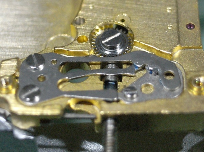

Flip the movement over once again to tackle the Keyless Work
Unscrew and remove the Setting Lever Spring.
Lastly unscrew and remove the Setting Lever, Intermediate Wheel and Yoke.

I started with the Keyless Work...
Lubricate the Stem and install the Sliding Pinion and Stem.  Also screw in the Setting Lever Screw.
Install the Yoke and place the arm into the slot in the Sliding Pinion, and replace the Setting Lever.
Install the Setting Wheel and fasten down.
The last part of the Keyless Work to be installed is the Setting Lever Spring.
Next install the train...
Install the Minute Wheel, being sure to replace the small washer.
Install the Intermediate Wheel and the Second Wheel Driving Pinion.
Next install the Second Wheel.
The lower jewel for Rotor is a blind pivot point, this needs to be lubricated BEFORE installing the Rotor.
Install the Rotor.
And lastly install the Third Wheel.
Carefully install the Train Bridge, be careful to check the free running of the train before tightening fully.
Next flip the movement over and proceed to install the Motion and Calendar Work.
Firstly make sure the Magnetic Friction Wheels (Cannon Pinion) are very clean.  Especially the flat plates between the wheels.
Install the Magnetic Friction Wheels (Cannon Pinion)
Then install the Calendar Setting Wheel.
Next install the Motion Work Setting Wheel.
Install the Intermediate Date Wheel.
Lastly is the Date Indicator Driving Wheel and the Hour Wheel.
Now all the wheels are installed you have to time the Calendar Setting Wheel, Intermediate Date Wheel, and Date Indicator Driving Wheel.  This will take some study to setup correctly without the documentation; but take your time and you'll find it will become obvious how these wheels interact with each other.
Once you have set the timing up, replace the Calendar Ring and Date Indicator Maintaining Plate.  Then gently hold the plate down with a piece of Pegwood, and with the Crown in the second position, work the wheels and test that the pivots are located in their jewels and the timing of the Calendar Work is correct.

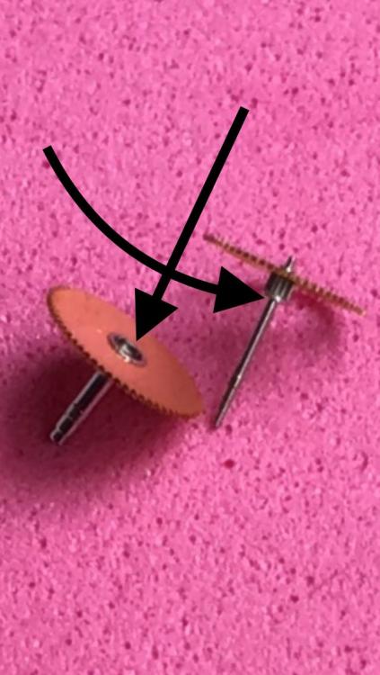

Hi guys, sorry to necro this thread as my first act as a new member. I promise I'll introduce myself properly soon.
Thank you for putting this together [mention=246]lawson[/mention]. It's given me the confidence to attempt a strip down, clean, and service of a non-running 1337 I recently obtained in a job lot. Hopefully gummy oils and not a failed circuit (coil tests ok) are the problem.
Anyway, I've stripped it down and cleaned the plates and gear train in my ultrasonic (excluding the rotor). I noted the need to dry clean the magnetic rotor and canon pinion separately as discussed above. I also noted the suggestion to pay close attention to the small washer(s) between the second and centre wheels. However, I did clean them in the ultrasonic. I've just found a service guide for the practically identical 1332 movement and it recommends removing the two washer between these wheels and dry cleaning them. The guide mentions that they're magnetic and should be placed so as to repel each other (presumably in place of lubrication). I've added the guide here. I hope I'm not breaking any rules re the size of attachments to be hosted by the site.
Having cleaned them in my ultrasonic, am I likely to have demagnetised them? Were you using an ultrasonic or a proper rotary parts cleaner, [mention=246]Lawson[/mention] and how did you go?

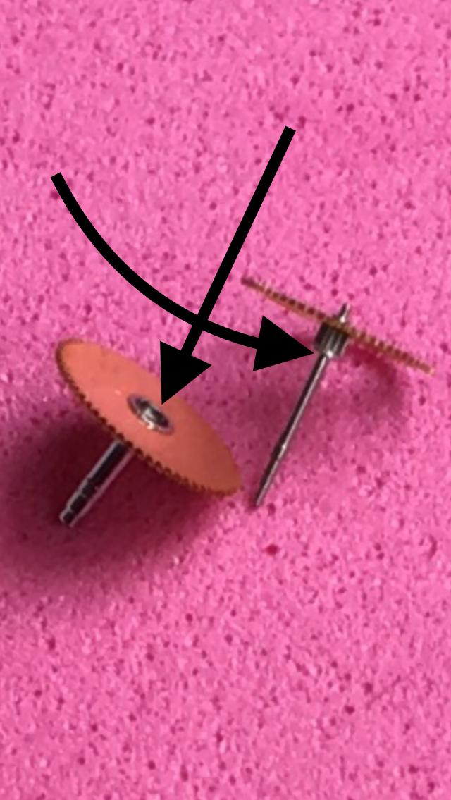

Hello matey!
I’m interested in why / how US cleaning would demagnetise these washers? Firing cavitated micro bubbles at something would be fine I would think, although I’m not up on physics to a particularly high level. Have you found that they are demagged or tested them?
Hello matey!
G'day Pip.
Well my thought was that if you drop a magnet you upset the highly regular polarisation of the elements and it loses its magnetism (sorry if I'm a bit vague on that, high school science was a long time ago).
If the transducer is vibrating the sides of the unltrasonic (again, my assumption which may not be the way it works) and the parts are sitting inside a jar likewise being vibrated, might that vibration not transfer to the parts, having the same effect as dropping a magnet - messing up the ordered polarisation of the elements?
I haven't had a chance yet to have another look at the parts yet - will have to wait until the weekend - to see what's going on magnetism wise.
