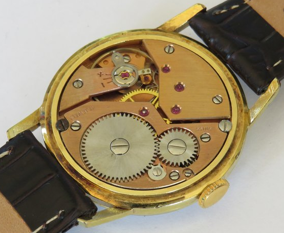

An "Uno" branded 17 jewel gents dress watch.
It was just a few pennies over the 404 club qualifying boundary, but I rather liked the look of it.
Uno was a brand name of both " Dimier Frères & Cie."  and "Fabrique d'Horlogerie Chs. Tissot & Fils", both of which are/were quality manufacturers.
Probably from the 1960s (or possibly late 1950s).
There were no pictures of the mechanism, so this is completely pot luck, however I found a nearly identical watch online which contains this Peseux 192A.
So I'm hoping this one is the same. Time will tell.

There were no pictures of the mechanism, so this is completely pot luck, however I found a nearly identical watch online which contains this.
Well, it finally arrived, and it isn't a Peseux 192A, however it is in fact an AS 1130 with a very similar finish. I'll post some pictures once I have had a chance to take a look at it in more depth.
I have the AS 1130 "Wehrmachtswerk" UNO running like a champ (+10s/d 0.1ms beat error and around 260 degrees of swing). When it arrived it was gummed up solid, so much so that I feared the balance was damaged. I'm going to wear it for the next day or so, to let it settle down.
