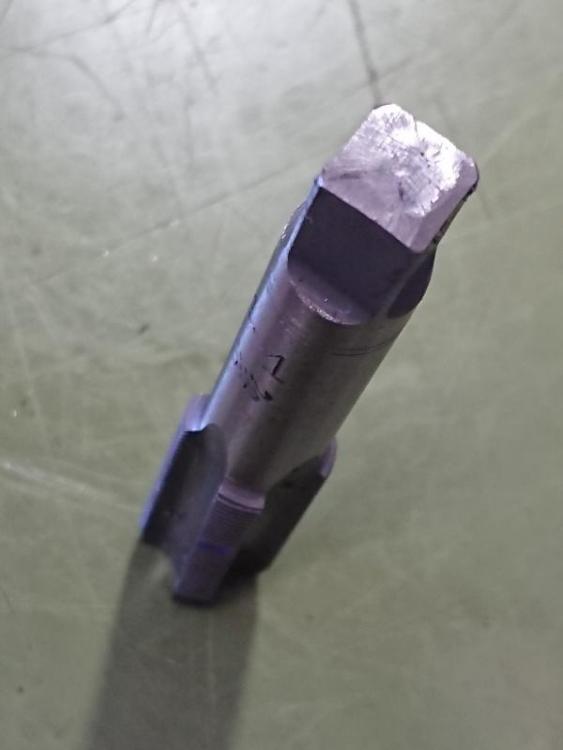

Stupid tap adapter
No center hole for a tapping guide on this guy or its two brothers, it's fully hardened so forget about drilling.
After a long time rummaging, I came up with turning of a cup sleeve. No standard wrench fits the square perfectly, but that's not a big deal. Took an almost short time, no casualties!
