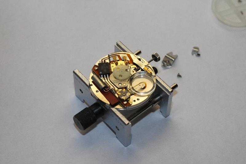

I have replaced a couple of crystal oscillators to get a quartz running, the only problem is that sometimes a modern crystal isn't the same shape as an old one as seen in the photos. Mine is the top one (original crystal), the other I got off the internet.
There is an adjustment, I think it's a variable capacitor to tune the oscillator circuit - also shown in the photos. Not sure if they bother with more modern watches?
IMG_0002.thumb.JPG.8cdf526c1a567fc0d6bf19a4c7465f97.JPGwp93138960_05_1a.jpg.cdd7e340ae8fd51ab63d881c91c2d6a7.jpg
These are vintage quartz watches. The date code on the first one is 1972.  For sure, I can see replacing crystals on these because they can be tuned ("pulled" as we say) with the variable capacitor.  The modern quartz watches (at least some of them) have programmable memory on board the IC which is used to make the adjustments.  There are no adjustments on these.  If you replace the crystal on one of them, It will not be as accurate as it was before...but it will at least work.
usually all the early quartz watches had a trimmer capacitor for regulation purposes.  modern watches the quartz crystal usually oscillates fast and they use some sort of digital regulation system. Program at the factory either one time or with a eeprom. Either way it doesn't really matter to us the timing machines that used to be able to program these only existed over a narrow window of time and I don't think they ever release the programming algorithms. On the other hand if you do have a timing machine that can pick up the quartz crystal oscillation it's nice to know that it's actually oscillating at somewhere near the correct frequency.
'72 from the Motorola chip? Yes it's a Girard-Perregaux from that era.
Getting it to work is better than nothing, it's next to impossible to find a circuit for some old models.
