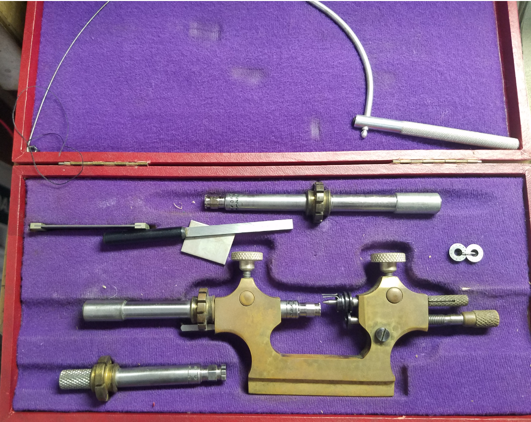

I have this tool (for the most part).  Several years ago when I was contemplating selling all of my Dad's stuff, this was first on the list to sell.  I changed my mind...glad I did.
I have the tool (from the video) in different variants but don't use it. I wonder if anyone else does (except for YT videos). You do not see, what happens, if you drill or just polish, how deep you are, if chips are coming etc.
I rely on my lathe, no issue esp. with 'big' drills like 0.3 mm ?
I'm reasonably sure the tool has been discussed in this group somewhere. Plus similar tools for the same purpose. Then I know there's a couple of additional videos on YouTube like this one.
https://youtu.be/FBZWZfbxeJw
19 minutes ago, AshF said:
Jacot tool
I suspect now that you have the name if you do a search we've covered this tool before. Then the unfortunate problem with this tool is it takes a lot of practice to get really really good. But if you're really really good it produces a super nice finish on Pivots.
