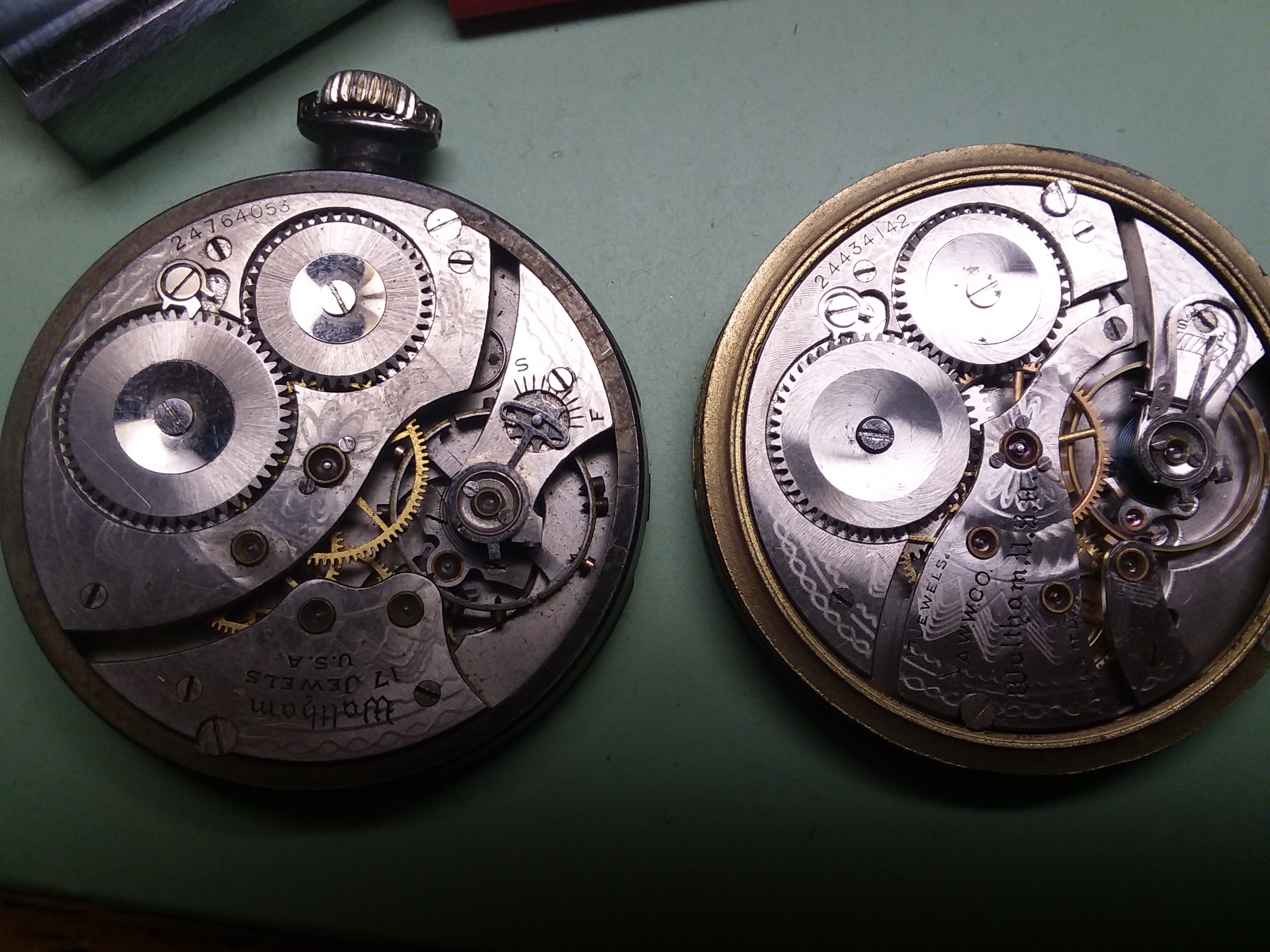

Found these in the stash, I guess they'll be sacrificing themselves...

Did you already look at both Balance Staffs? Are they both broken? ?
Have you a lathe? Only asking as some staffs are riveted on and the rivet lip needs to be cut off by using a lathe. There are tools out there that will punch the staff out, they do work but can occasionally damage the hole in the balance wheel.
Unless of course they are friction fit staffs then you are home and dry with the staking set mate.

I haven't really examined them up close yet. If it's anything more than a basic swap I think I'll look for a different one. I want to start with the simple (if I am even allowed to call it that) stuff.
Search the web for info on wether the cal. You want to use to practice on is a rivet staff or a friction fit, that way you won’t destroy the hole in the balance wheel forcing out a riveted staff thinking it was a friction fit, yes I’ve done that !!!
