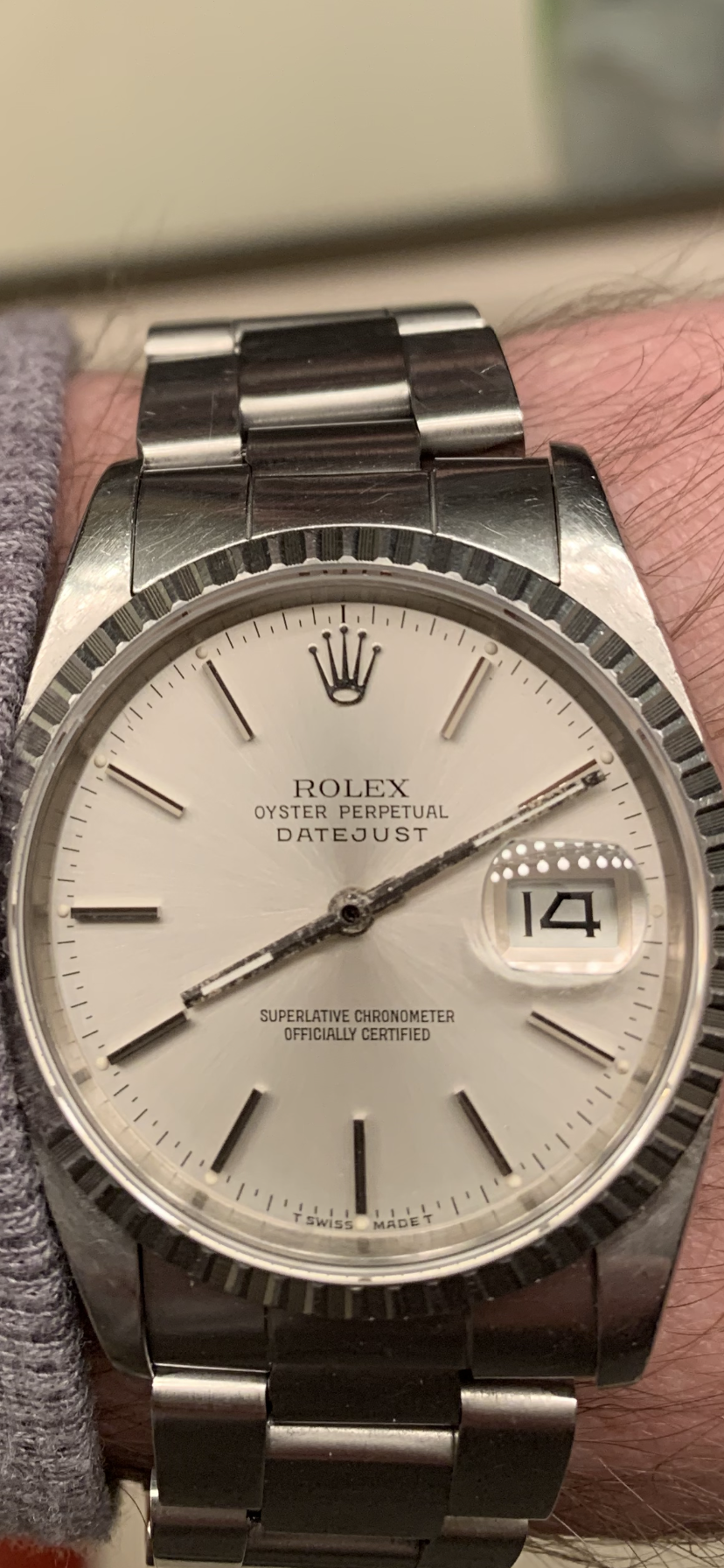

Hi all. I recently got an IBM 25 year service award Rolex handed down to me from my grandpa. It is a 1989 Datejust 16220 with 3135 movement.
When i got it the dial was spinning in the case when i would wear it and the second hand was off. Using YouTube videos, I got through replacing the dial with no issues. However when it came to the second hand, come to find out part of the second wheel stem was broken off in the hand. So i ordered a new second wheel and used Marks videos on YouTube to attempt that job. That’s how i got here.
But i didn’t take my time and didn’t let the main spring wind down first. I jumped right in and when i took the train wheel bridge off i realized my mistake. At that point the watch started unwinding rapidly and the minute hand hit one of the markers on the dial. Once the dust settled and i put it back together the watch isn’t working correctly. When i try to wind it, the clutch wheel on the main spring barrel turns but so does the main spring barrel which doesn’t allow the spring to wind. When i pull the stem out to hack position, the hands turn but so does the clutch on the main spring barrel as if it was trying to wind the watch. I have had front (date wheel side) and back (main spring barrel side) apart with no idea or visible sign of what is wrong.
Thank you for any guidance you can provide as i am stumped and didn’t feel comfortable continuing to remove parts trying to find out.
First pic is dial change prior to second wheel replacement. Other 2 pictures show current state.

What is going on here? Broken teeth?

No, it looks like that in the pic but that was just some black grease like substance that was on the top of the wheel when i opened it. Currently that is cleaned off. Ratchet wheel works great and the are no broken teeth.

Then check if pallet fork is installed correctly and that both jewels are present.
If that does not help - take the entire movement apart - clean it and visually inspect all pivots, teeth on each wheel.

In all of my tear down I do not remember removing the pallet fork or even seeing it.  I google'd it to find an image and definitely didn't remove it but that doesn't mean it wasn't dislodged or broken when the watch unwound and the hand slammed the index.
It seems like whatever is supposed to "clamp" either the main spring barrel from spinning when in winding position or clamp or disengage the winding rotor when in hack position isn't working properly.  Does the pallet fork play a part in these mechanisms?

I am reading your comment "When i try to wind it, the clutch wheel on the main spring barrel turns but so does the main spring barrel which doesn’t allow the spring to wind."
Do all other wheels turn? If so - pallet fork is your main suspect. If they do not, hen tale of the mainspring, remove the lid and check if mainspring is hooked to the arbour.

Yes, all wheels turn when I try to wind the watch and all wheels turn when in hack to change the time.  I thought the same thing, that I had a broken main spring, so I did remove the barrel, opened it and the spring is attached to the arbor.  To check if the spring was broken somewhere, I closed it back up and installed the screw that holds the clutch wheel to the barrel and used a screw driver to wind the spring in my hand.  It would wind and then it would unwind as expected (I've never done it before so have nothing to compare to but seemed ok)
So it sounds like pallet fork should be my focus.  Can you provide guidance on where it is located (date wheel side or main spring side).  I will watch Mark's videos that he has for working on the 3135 movement and how to access it but knowing where to look will help identify if I should watch video 1, 2 or 3.  Also, what would you expect to be the main failure mode of the pallet fork; broken or dislodged? (What should I be looking for when I access it?)

If all wheels turn while winding, then your pallet fork is not doing what it supposed to do. You can see it from the back side - next to the balance wheel.

Thank you for this drawing.  I ended up finding the pallet fork using Mark's video's online and it was in place and not broken.  While doing this though, I did find that the sprocket that it drives which then in turn drives the second wheel was off center and wasn't working.  Correcting this corrected the watch not being able to be wound.  So now it runs.  However, now I have a different issue.
In position 1 the watch winds and runs.  In position 3, unlike prior issue where the hands and main spring barrel turned, now the stem wont turn at all.  When I put a little pressure on it to turn I can see the hour and minute wheels move a little but will not turn.
Any thoughts on what next?  I thought something might be jammed but when I use a 20x loupe when the watch is running I can see the minute wheel running so that at least is working correctly.

Despite the "F screws" I was able to check the pallet fork and it was in good shape.  it ended up being the sprocket that the pallet fork drives which works with the second wheel that was not in position.  I am not able to wind the watch and it runs.  The problem now is that when the stem is pulled out to position 3 to set the time the crown will not spin.  It is jammed up somewhere which is different than before as it spun freely.  Any thoughts on this one?
