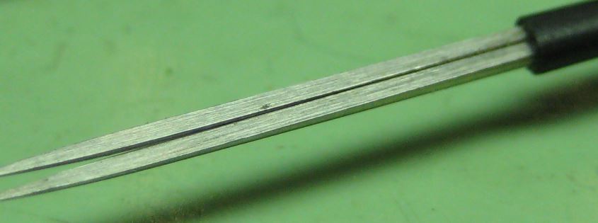

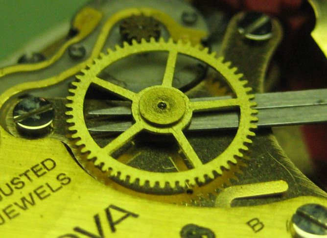

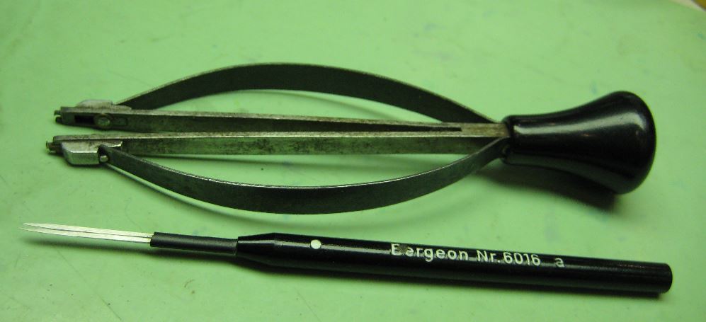

the tool found way up at the top of the page looks like I have two of them. One here at the bench at home and one at the bench at work. then the other tool is only at work I feel deprived here that I don't have one at home also.
Then the real question becomes which one do I grab when I have to take one of those wheels off? It's always nice to have options because a lot of times one tool just isn't going to cut it. But I'm guessing I usually grab the one that I gave an image for then if that doesn't work I use the other tool. On the other hand maybe I just use whichever when I grab first.
But maybe I could do an experiment today. Did occur to me I have a watch that has a wheel like that's that does need to come off maybe I'll see which tool I grab first today if I remember.
what I will try to remember to do is to take the other camera to work today. I have a specific camera I use whatever I'm doing watch photos. The problem with the picture of the tool it doesn't really show how it really works. so I think getting a picture would be a lot easier than trying to explain it the tool works really well.

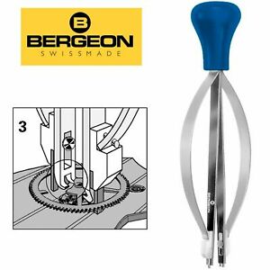

That would be great, as Cousins have this tool -
cheaper than buying both the 5 and 6 spoke tools, but I can't figure out how it works.

I'm attaching pictures so you can see what the other tool looks like. There are two protruding needles which actually look like sewing needles ground on one side. what we can't see is how their attached to the base. Because they're both free to rotate a little bit and move around which is the key. As you can see it goes under the wheel flat side up. Then you just rotate the handle a little bit each the needles rotates and lifts  the wheel up works really well.
