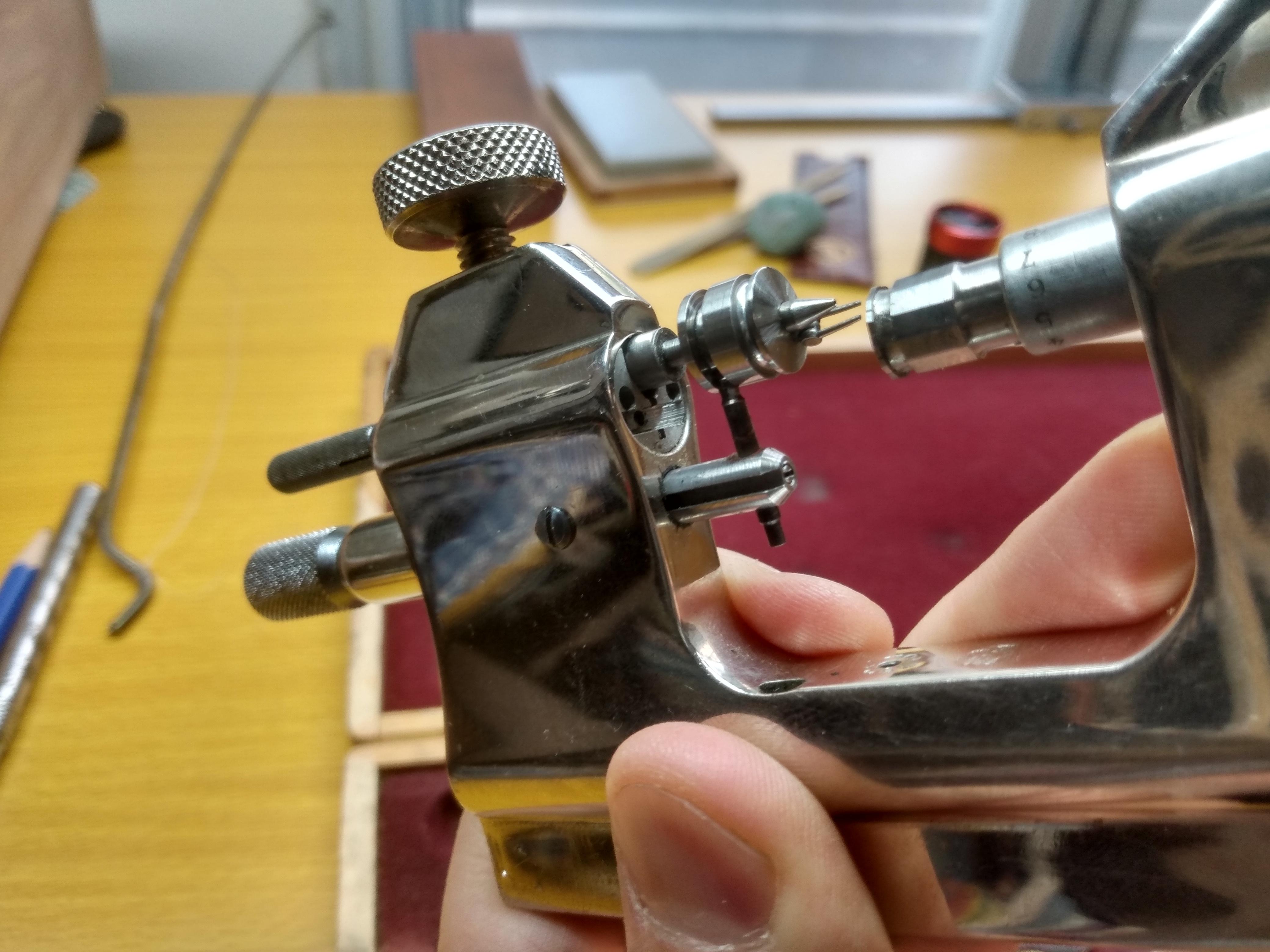

@nickelsilver almost 2 years later, I have a follow-up question: what is correct alignment between female centre and tailstock runner bed? If they are aligned like I would expect them to be, then I think a slight taper would be almost inevitable. If the spindle centre is aligned with the middle of a groove (halfway between top and bottom), then if the pivot protrudes above the level of the bed, as it must to file or burnish, then it seems to me the necessary result with a horizontal burnisher is a tapered pivot, since at the "far" end the pivot is lifting off the bottom of the bed.
Indeed, this is what I am getting. Although the degree of taper with short pivots is pretty negligible, I find that if I try to burnish a centre wheel, the taper is quite noticeable, and the only way to avoid it is to compensate by rocking the graver.
I know that tools with adjustable head/tailstocks exist, although they are not common. Is the purpose of this adjustment to avoid the problem I have just described? Or should I be able to avoid it with the classic, non-adjustable tool? I am fully prepared to admit that either my tool is defective or I am doing it wrong.
Thanks in advance.
The way the tool is made the headstock runner is aligned to the center of the opposing notch, yes. Horia (Steiner), usually, marks the notches so that a pivot made in that notch will match the nominal same jewel, i.e. have just enough freedom: a 10 notch will produce a pivot a bit less than 10, 0.950-0.975 or so. The idea is you continue to burnish until it won't anymore, so now the pivot is level with the top of the runner. At any rate just a few microns difference even if you don't go that far. So you're right, that anywhere outside of that will be off, and should make a taper, but in practice the taper is so slight it's unmeasurable with any normal equipment. A few microns height difference over say 3mm, measured over a length of perhaps 0.3mm, is invisible. If you are getting visible taper there is an issue with your tool.
It is definitely more pronounced on center wheels, true. Especially as the sizes between notches tend to skip by 3 or 4 hundredths. For larger work like that it's really nice to have one of the supplemental tools that works with the jacot tool using a carbide wheel, or a Pivofix or similar. All very expensive of course- but nice.
Edit- just sketched it up, with a 0.01mm height difference from center, the total taper over 0.3mm is one micron. But- if using the tool "properly" where the burnisher sort of bottoms-out on the top of the runner, even that gets evened out.

@nickelsilverthanks very much, that is very informative. Yes, I think I may just need to be more aggressive and really bottom out the burnisher. But I think it's possible the tailstock runner is not sitting entirely level.
So the tools with adjustable tailstock. This is to correct this issue?
Is it ever appropriate to rock the burnisher inward to compensate? Particularly on centre wheels I sort of feel like I have to do this.

The adjustable ones I have and have seen have had the headstock adjustable; it is to correct the alignment, though it seems some might use it for making tapered pivots on purpose. But that seems iffy in my view; the notch in the runner and runner top are parallel, so it would be a fight. The runner that most tools have for 4th wheel pivots has the notch tapered, as those pivots are tapered on the end. That makes sense.
Depending on what tool you have you don't have to have an adjustable headstock. The Horia/Steiner tools, later design, are adjustable. If you have one of those I'll post how to do it. All this is also a reason these tools are numbered on the runners to match the frame, they were ground and adjusted as a set in the factory.
One thing I've frequently seen is the simple runner for the headstock can be quite bent. If you have a lathe that takes collets and can get it in there you can bump it back true.
For center wheels, if you find you're getting a noticeable taper (and you know the tool is good), it's no crime to tilt the burnisher. I have an industrial pivot  burnishing machine and a Rollimat (meant for clocks) that I'll turn to personally, and if the (center) pivot is very worn I might touch it up in the lathe with the cross slide to get it clean and straight before finishing.

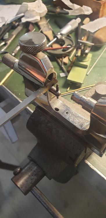

Ah excellent, that's a nice Steiner there. The little jack screws you see set the height, but different than first impression. By tightening them down, they force the V block in the head upwards, raising the spindle. To lower, you loosen, then tighten down tight with the normal knurled screw on the runner, this forces it down. To make adjustment side to side, you can tilt the whole block, using a tool in the two holes. I have several of these and some don't have the holes; there you need a tool that fits the slot where the jack screw is, but it needs a little recess for the screw. You can see I made a decent tool for the holes, and a quick-and-dirty one for ones without holes- but it works!
The Steiners with adjustable height headstocks don't have the jackscrews, as they aren't needed.
To see what adjustment is needed, it's nice to have a wheel fairly large in diameter, not too long of an arbor. Set it up in the tool (in the correct sized runner), and check if it's nice and square to the runner, looking down and from the side. That's about as scientific as it gets. If this was a larger machine tool you'd check stuff with dial test indicators and such, but simply no room here. If you get it so that your test wheel (make sure it's running true to itself first, haha) can be taken out an put back and it's always lined up, you're all set.
The only thing to really pay attention to is "nod" of the spindle; if you make adjustments to the jackscrews unevenly you can tilt the spindle, so that it hits correctly at one distance but not at others. Easy enough to check, pull the spindle in so that the tail runner is as far forward as it goes, check, do the reverse, check, adjust. In practice I automatically try to use the head spindle in more or less the same position if I can.

@nickelsilver that's awesome, thanks so much. I'm gonna try it tonight with a big pocket watch third wheel I think. Looking closely now, I do actually think the adjustment of the jackscrews is uneven, which may be causing my tapering problem. Thanks very much again!
Yes a third wheel is good- especially as they often have the wheel quite close to one side of the arbor, so get that side near the tailstock runner for the visual comparison.
@nickelsilveryeah so with the third wheel, up/down looks good. Left/right needs a small tweak so I need to make one of those tools. Actually I tightened down the brass screws that grip the headstock spindle (left and right of the main knurled knob) and this seemed to help the lateral alignment a tiny bit. But still needs a slight adjustment. Thanks again for your help.

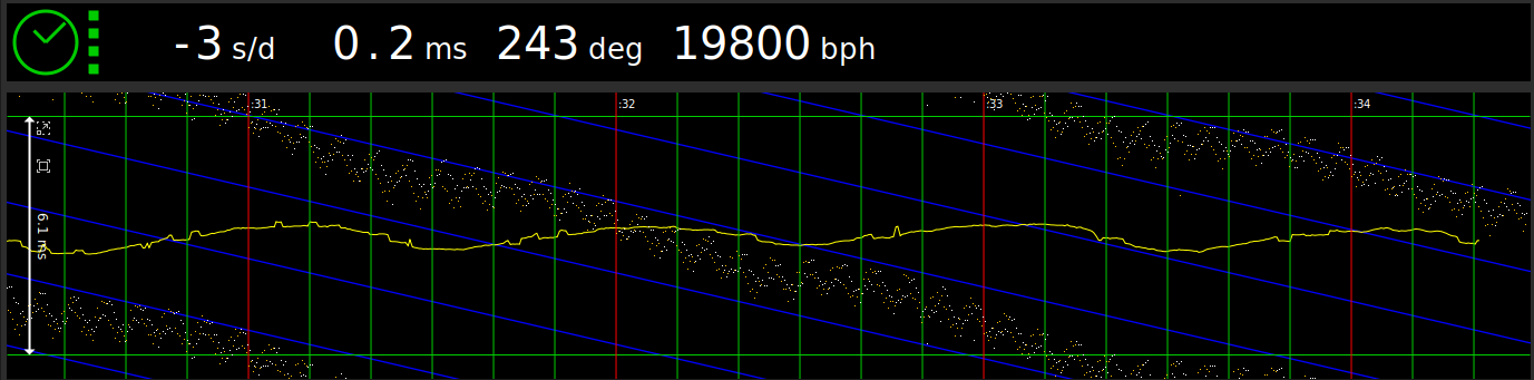

What does this plot look like?

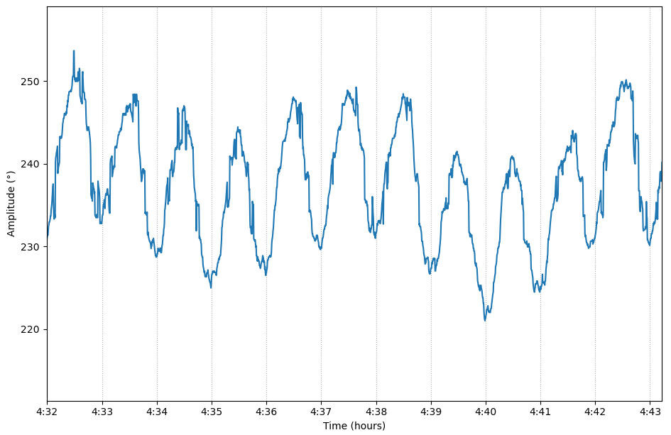

I've been trying to get tg to show this kind of data.  I've got a Seiko 2539A that seems to have a lot of out of round wheels.
Here's about four minutes' worth.  The line is amplitude.  The short length oscillation in the time plot is 30 ticks long.  So likely caused by the escape wheel.  But there's also a cycle in the amplitude that looks like it's one minute in length.  That's probably the fourth wheel.  It looks like there's also a cycle in the time plot that's one minute in length as well.
I can plot the amplitude over a long period of time.  There's clearly some kind drop in amplitude that happens every 2 hours.  There's also something else, where the amplitude slowly drops over a period of a bit less than two hours, then jump backs up before slowly dropping again.  I wonder what could cause that?
Zooming in over a period of a few minutes, the cycle with period of one minute is clearly visible.

What's interesting with a mechanical watch is it will average out all those problems up to a certain point. So over time everything tends to average out. They can be a problem depending upon  the rate of the cycle if it's a short term on the timing machine. So in other words  you time a watch you are watching it you'll see things going up and down in.. Or if is like it work where Rodda six position timing and every time it's a little bit different because each time it's in a different power cycle.. But you put the hands on and they usually keep time.
The problem with things that occur over long periods of time is it's not the gear train typically it could be the mainspring barrel  yet figure out the gear ratio and how many revolutions that makes per whatever. Then you'd have to go to the dial side of its running a calendar
by the other thing that becomes important is does the amplitude variation cause you a timing problem that you're concerned with? The words you see that there is your amplitude variation but if you do a time plot at the same time as amplitude plot are you seeing a dramatic timing problem because of the timing stays relatively consistent then it's not really a problem..
