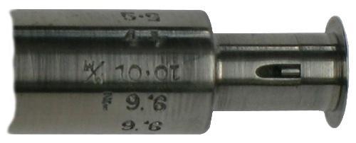

Does anyone know where I can get the interchangeable bits for a Jacot pivoting tool from? Does anyone also know the proper name for the bits with the sizes written on them? Any help would be appreciated... D
There were many makers of these, and they aren't interchangeable. Even from a single maker, they were each matched sets, and if you needed a new part, depending on the part, it would have to go back to the factory.
They are comprised of the main body, and runners. Runners are the parts with notched index that have the beds on one side, that the pivot sits in, and lanterns on the other side, that allow working the pivot ends. Some tools have a runner for larger pivots, often called a center wheel runner, which has beds at both ends. This would be the only notched runner not condsidered "matched", and usually aren't numbered to match the tool. The small simple shaft that carries the pulley doesn't have a specific name (Horia just calles it "cylinder"). These are much simpler and not matched to the tool.
Horia is the only maker of these tools now. They took over the Steiner brand, often referred to as Hahn in German as their logo is a rooster. A single notched runner new costs more than most complete and usable second hand Steiner Jacot tools you might find. You can however get small parts like the pulley or drive finger from them at a reasonable cost.

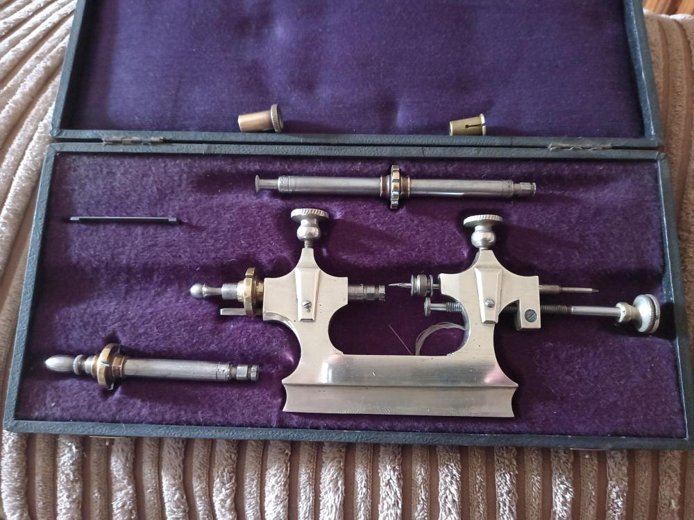

Thanks for the swift reply. I didn't so much mean interchangeable to different sets but interchangeable between the parts in the set. But as I'm looking for extra bits for mine I obviously did hope there were truly interchangeable peaces! But it dont look good. I brought a set off ebay very cheap. Its still boxed, complete & VERY clean, but the flanged part the has sized holes right through the flange is chipped on one side which takes out two of the smaller holes! And the smaller of the two bits where the pivot lays in the slot is very worn in places! But OK for £41 I guess?!
 Many thanks.....
It looks in decent shape, but the single-ended runners, one of which is in the tool the other lower left in the pic, are 4th wheel runners (they have longer tapered beds for extended 4th wheel pivots), and are wrong. Or rather, one is wrong- a tool like yours would be supplied with one of them, and there would be another double-ended runner. You can see the decorative knob at the end of your 4th wheel runners are different from each other; which one is correct is a guess but if you check the notched index there is probably a number, and it will match a number somewhere on the tool body.
That's a bigger issue than your chipped lantern. You are missing half the possible sizes the tool was intended to provide. A chipped lantern isn't too bad, you don't need an exact match of the hole to pivot, just one that lets the pivot through well enough to round the end. If you have a lathe that works too- when I make a staff I finish the pivot diameter on the Jacot, then the end in the lathe.
