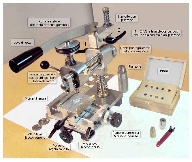

No. The way it's done is with a crown (hollow) mill on a lathe or boring machine. I know becuase I am being taught by a Master watchmaker that developed the below machine exactly to do that. The hollow end mill is hand made with a triangle file and then hardened. One only cuts just enough tube to grab the stem safely. I hope you can find someone that can do that for you.

Do you think your guy can do it? I’ll pay whatever he wants. My only other option which is something I don’t want to do is basically grind the end of the stem down and re-tap the outside of the tube then use a stem adapter. Or Solder the stem directly to the tube. Both these options would be what I consider rigged and I am a stickler for details especially when it comes to these extremely rare watches

Answered in PM and for the record not for money.
My other observation is that on lathe, even a "model engineer" one with a collet chuck it is trivial to cut 1 or 2 mm off the tube.
