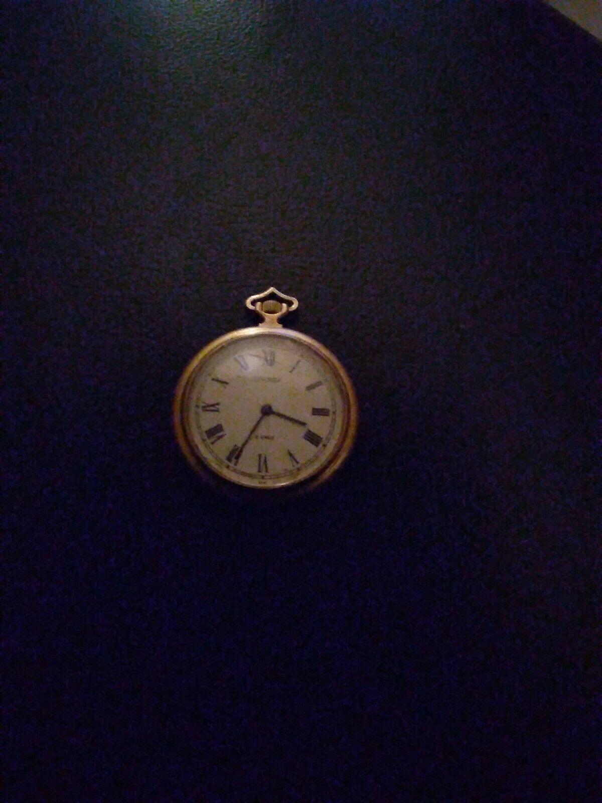

A USSR Sekonda Pocket watch, for a pocket money price, hoping to join the club is on its way.
Most probably a 19 jewel Raketa 2609.HA, however the picture on the listing is pretty terrible, so that is  just a guess.
EDIT: The nearest I can find with Google is this, so perhaps my initial guess wasn't 100% correct.

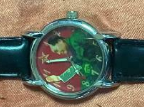

Oh dear, when will I learn?
Another Mao, this time waving, not smoking.
This was in a batch of 13 described as "various watches bulk sale all need batterys"
There are at least three mechanicals, including an Avia and the Chairman Mao, and a couple of quartz that look interesting.
I scored the lot for 0.99p but the postage brought it up to about a pound per watch.

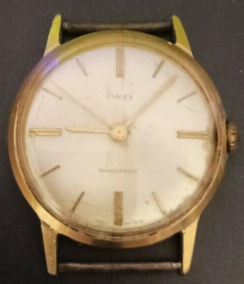

Another 1969 Timex Marlin joins the club today.
It needed a lot of cleaning and a new crystal (and a fresh strap and pins) as you can see in the "before" picture below.
It is not quite as pristine as its sibling on the left in the first picture, but the pair of fifty two year olds are both ticking away nicely.

I already took a look inside that one, and it had the usual low grade Chinese standard movement with Mao's arm attached to an extended shaft on the balance fork. The hairspring was gummed up and bent as a result of the half baked attempt to lubricate it.
It had more oil in it than some of the smaller members of Opec, so I'll need to clean all of that out. I got it running (sort of), but I suspect it will require a lot of work to get it working well.
Who's sorry Mao?
I got it working reasonably well, considering what it is.
I also remembered I had a small bundle of Chinese "Hing Yip" "watch band-strap" "real leather" straps, so I chose something suitable from the mix and here is the result.
Here is my other Chairman Mao for comparison.
.. and here they are side by side, both sporting the worlds finest "Hing Yip" bands.
I have seen a couple of other designs of Chairman Mao watches, but the smoking one seems to be relatively rare.
