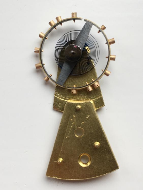

I have had to untwist the HS and reshape, it’s not perfect on the final coil but at the time it was time to step away from the bench and have a break so I still need to address the finer points on it so bear that in mind when addressing the picture, although I have to say I have had movements run with worse looking hairsprings than this, so although maybe a small/large factor in the non running a think it’s not the only cause.
Ok a bit more tweeting on the HS, now flat and  pretty much true ( professionals here hold back ).When installed firstly without spring the balance freely moves with air from the blower, so no jewel/pivot wear on the balance staff.
HS installed back on the balance and placed in movement with out the pallet in place and total free movement in all directions with no binding.

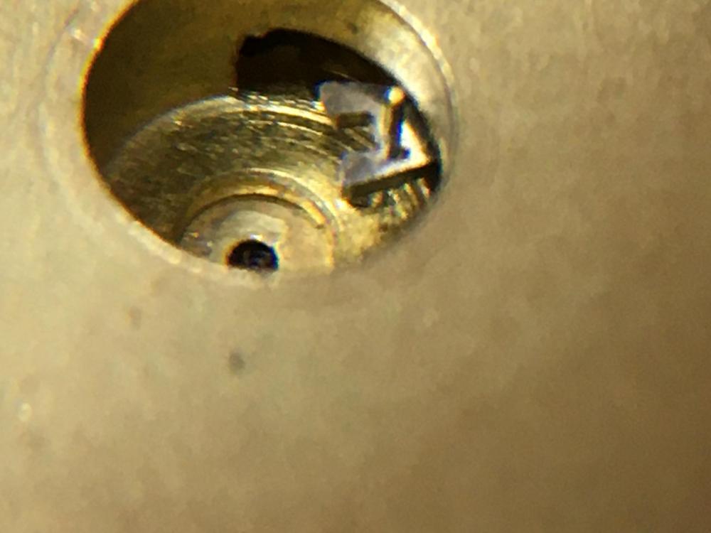

Installed pallet and balance and same problem persists, I’ve looked with the microscope thinking the roller table or pallet fork pin (as mentioned ) might be rubbing.
I cannot see either of them touching but saying that I cannot get a good angle to see properly, I’m looking almost straight at the roller jewel. On the subject of the roller jewel it is meant to sit between the banking pins when at rest isn’t it?? Asking as I’m head scratching now as to what is causing this problem.
I did try the other balance complete but get this, as mentioned before it is attached to the opposite side of the balance cock to the other and the roller pin sits 180 degrees opposite my one!!
Now looking at the guard pin it is in position and doesn’t look bent. So I don’t think it’s that either.

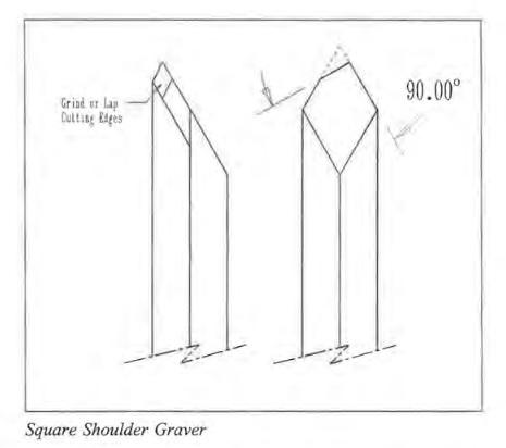

I would suggest, as a former teacher, to concentrate on making nice smooth cylinders first, in unhardened steel (or even brass). Then make nice smooth cylindrical pivots (of any size) with nice square shoulders. Then try hitting a specific diameter for simple cylinders, then specific diameters for pivots. Then do the same with hardened and tempered (blue) steel. I understand making an actual part is more motivating than making "dumb" parts, but you will find that in a few hours you can reliably make those cylinders and pivots. Then making the part will be easy. Then you'll be really motivated to make all sorts of stuff.
The image is taken from an article in Horological Times, this shape of graver can really help to avoid undercutting a shoulder when making pivots.
 Nickelsilver, could you show me an actual phot of this graver please, I have had a go at making one but just don’t seem to be able to get an edge on it. Thanks.

Gentlemen and ladies ( if we have any ) I do believe I have some success. A day of manipulating the hairspring and lots of coffee we have the results of my endeavours here for you to see. Thanks to everyone that gave advice and hints and tips and the asked for criticism, all very much appreciated.
There were many failed attempts at making the pallet staff and some very successful ones that I broke the pivots off when burnishing them, I have learned a lot about turning by hand on my very old 6mm Lorch lathe so I’m happy with that, even happier that I’ve also got quite handy on the Jacot tool, so another skill learned ( still a long way to go on all fronts though ) but i am after all just a tinkerer and not a skilled watchsmith.
Enjoy my failures, there’s a picture of most of them sat in tray, I’ll keep all them as reminders that you just gotta keep trying.
