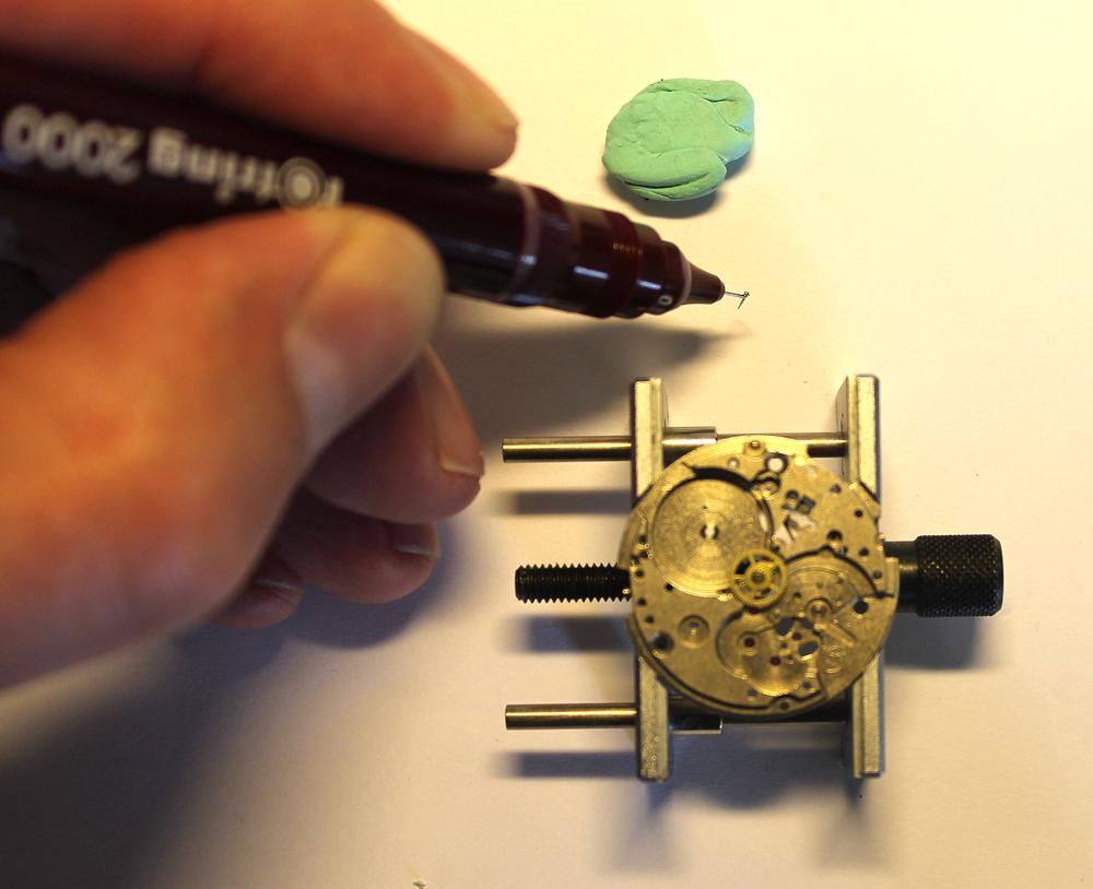

Usually yes, but in this case, I decided not to as I was thinking that it might create drag reducing amplitude. Anyway, I may very well be wrong about that and perhaps a tiny amount of Moebius 9010 would be beneficial at the contact point and on the arbor. Anyway, I was thinking back to this post when I serviced the movement. Also, this post might add something to the discussion, but I'm not sure.

There are many ways leading to Rome and whether to lubricate or not can be up for debate :)

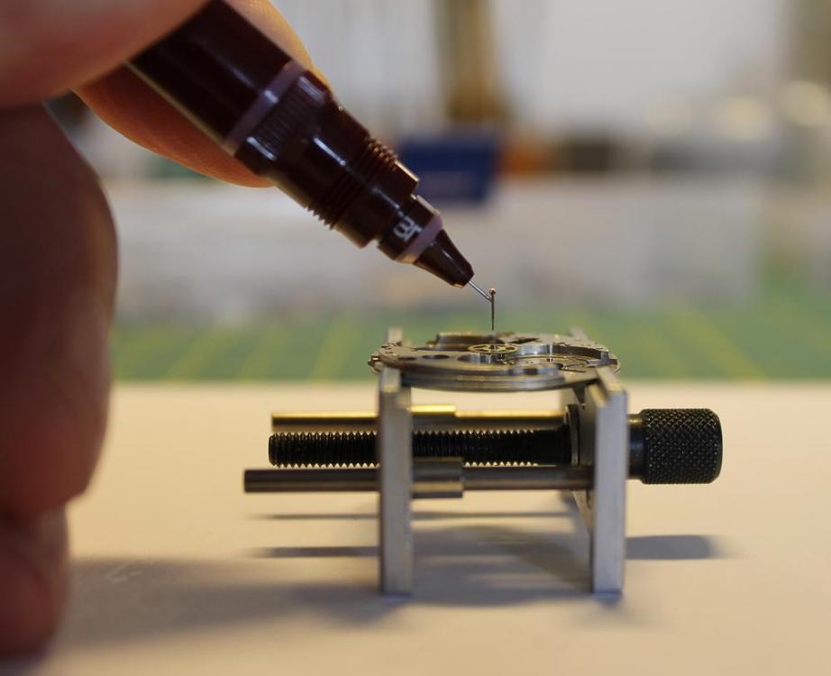

I normally do lubricate the seconds pinion and indirectly the dog-leg leaf-spring. For this job I'm using a 0.13mm new, but old-fashion Rotring pen with some light oil in the reservoir. I'm not using Moebius, but Dr.Tillwich 1-3 oil.
Just for the purpose of demonstration I took an empty 2409 main plate with the center-wheel inserted.
Normally the small tip of the Rotring pen is wet enough, due to the capillary working of the oil, to pick up the seconds pinion;
You can run the pen past the pinion and this will lubricate the pinion, if ever so slightly.
I than insert the pinion and push it carefully down the shaft of the center-wheel. The gently push on top of the seconds-pinion will lubricate the top of the pinion ..... and therefor indirectly the tip of dog-leg leaf spring.
The dog-leg leaf-spring can cause a variety of problems such as irregular amplitude, low amplitude, "dropping" second-hand when tilting the watch or a jittering second-hand. It needs therefore to be adjusted such that it just touches the top of the seconds-hand pinion, easy to be lift up but enough "push" to provide just enough friction to let the seconds-hand to run smoothly.
Anyway, it's up to the watch repairer to decide how & what ....
Just my two cents :)

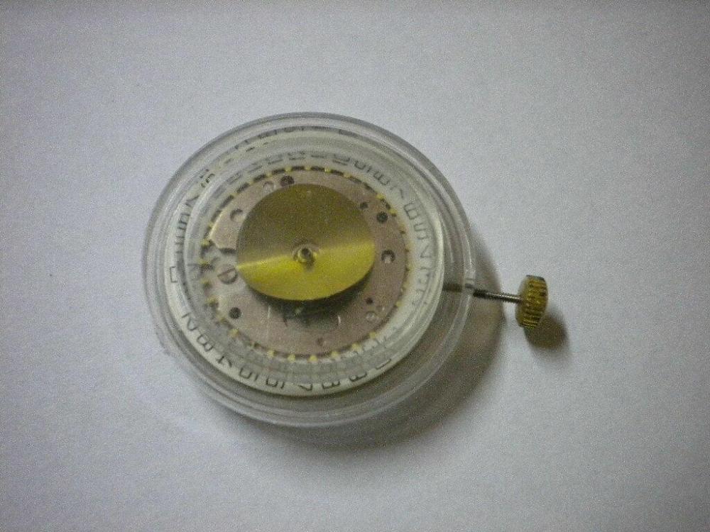

Hey!
Thank you for sharing this! I believe I have a Amphibia with the same movement. I am just getting into watch repairing.
My watch makes a terrible grinding noise when winding and refusing to run. (This noise first appeared after I took the stem out and reinserted it) I hope the movement isn’t completely useless now as I can’t see many parts online.
TIA !

Please see my reply here.
