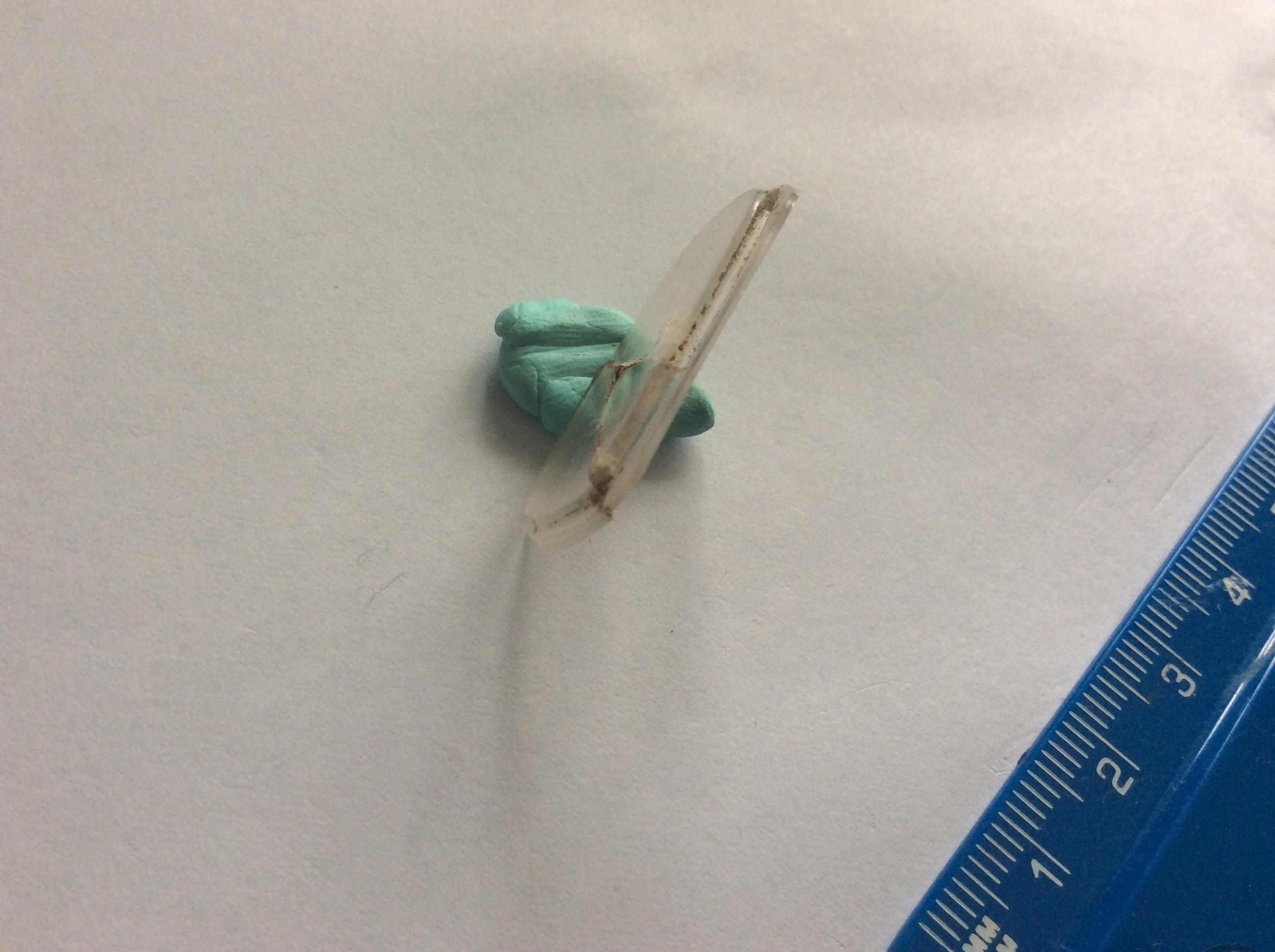

I picked up an interesting watch recently. I just liked it because it was something different. Surprisingly,  it ran when I gave it a short wind. There was some water damage and the screws that held the dial on were a rusty mess. Luckily I managed to get them out without damaging the dial further. I have just touched up the affected areas with some blue modelling paint, it will not be seen when it’s in the case. I’ve stripped it down and cleaned it, ready to go back together now. All I need is to find a couple of screws to hold the dial and somehow make a crystal to fit. I sure someone must have been in this situation before. There is no way I will be able to fashion a one with the same lip around the outside. My plan so far is just to cut a crystal as close to the shape of the opening as I can and hold it in with some Hypo Cement. What do you think, would that work?
its been done on other forums.  my only change would be not to use any standard glues.    use epoxy,   3 or 4 dots around a well fitted crystal.  god luck,  vin

That’s a nice little jump movement. I have made up a crystal before but it took 3 iterations before getting it to my satisfaction. I modelled the crystal using a 3D cad package at work then sent it to a cnc milling machine to be cut from a solid block of Perspex. The hard work was progressive polishing with wet n dry then final polish with polywatch which gets very hot.
The finished crystal was bonded into place with hypo cement. It’s not hard with the tools I used but you may be a better raw material craftsman than I am. Good luck. Regards Deggsie
I've used old CD's in the past to make temporary crystals or patterns. No cost.

Well I had some time on my hands and I managed to make “something” that resembles a crystal. I had a flat glass crystal lying about so with nothing to lose I began messing about. I lay the case on top of the glass and scribed the shape with a scalpel. After that I just kept following the marks with the blade. I was surprised when it eventually broke away along the line. After a good bit of shaping and smoothing with some 320 grit and then finer stuff it fit the hole reasonably well. It would have been perfect but one edge splintered slightly and I can see the chip like marks. I bonded it in with some Hypo cement in case it’s not permanent. The case is a bit bashed up anyway so it’s not like it’s mint condition. And like a fool I tried to polish the case a bit and rubbed right through the chrome in a couple of areas, I forgot it’s not a solid lump like a Seiko! Never mind it looks not too bad when wearing it.
3F6DDBB7-FB49-480E-8430-FB02F0CA48B5.thumb.jpeg.73e6a5f6ae6ba86d3804d4357758a457.jpegE8E68209-91E7-4F7C-9724-BD1077349D1F.thumb.jpeg.6afabe6eb24b0fc4086e826f7ede35af.jpeg
