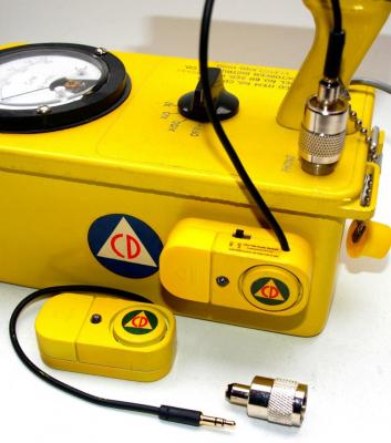

  14. Funny you should mention that...right now, my obsession is with Russian wrist watches...around 2011, only coincidentally about the same time as the Fukushima Daichi disaster, my obsession was...wait for it...geiger counters and related radiation detection gear. I still have a fair bit of that stuff around, though I am not sure I have a complete counter up and running at the moment.. The Fukushima thing, while a tragedy for a whole lot of Japanese folks, was actually quite fortuitous for me...I was unemployed at the time and struggling to keep my house. I spotted a market niche for a Geiger counter accessory...an inexpensive external speaker for the old US Civil Defense CDV-700 Geiger counter, which is very common here and a whole bunch of them got shipped to Japan about that time...they are good old detectors, but they don't have a speaker. So, I invented this: A clone of mine currently for sale, with a cute little CD sticker added... A simple modification to a $.99 window alarm, paint it yellow, add a $5 (ouch) connector to hook to the Geiger counter head phone jack, sell for $25. Sold several hundred of them, mostly to Japan, along with a pile of CDV-700s and parts and other Geiger gear I had accumulated right before the big meltdown, and before the copy cats (like the one above) kicked in. By then, I had saved the house, had a proper job again and the nightmare was over. :-) So...yeah, the Chernobyl-thing had actually occurred to me...lets see if I can get my hot-rodded DP-5V up and running and confirm or refute this theory... http://www.neozap.com/Rad/DP5Bgeigerreview.htm
