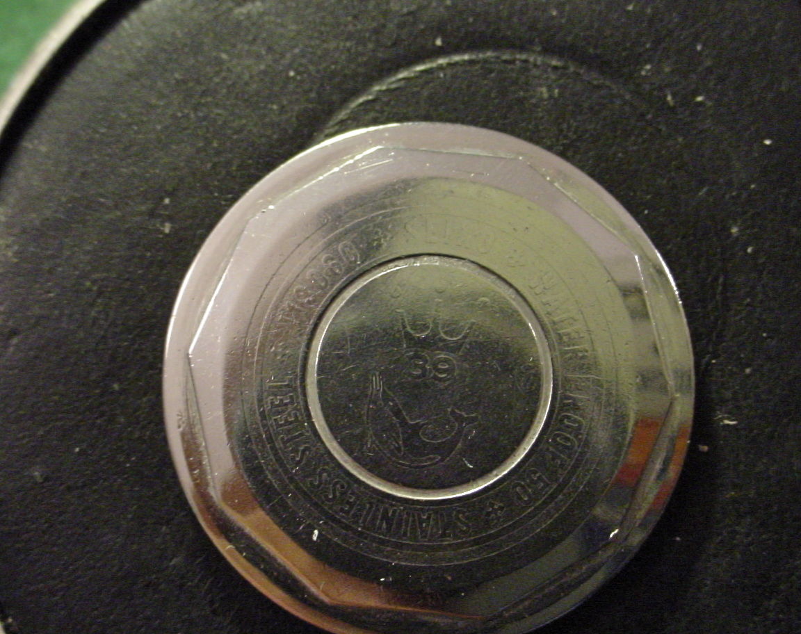

  1. I picked up this vintage 39 jewel Seiko Self Dater automatic at the swap meet today . The seller knows I'm a watch collector so when he saw me he called me over and pulled it out of a bag he had under the table . I am not familiar with this model , but what I do know is: It's waterproof and has an old seiko model # J13060 , which would date it at least to the late 60's . It has a Seikosha 39 Jewel movement , and the numbers 302389 stamped on the winding mechanism and 395 on the balance cock. The winding mechanism is the widely used by Seiko "Magic Fingers" , or something like that mechanism . The case back cover has the vintage Dolphin on it , but has a Crown over the Dolphin and the number 39 under the crown . The inside of the case back has the Seiko Stork in a square emblem that may tell where it was manufactured , ...I'm not sure of that , It also has the number 341 stamped , which may be the serial number . I will have to get more info on some of these facts . It also has a Swiss-like 10 sided case back that was really tight and I couldn't budge with a rubber ball case opener . Here's where it gets good ........ I crazy glued a SS nut from a plumbing fixture and let the glue set up ..... I kept a steady pressure on the nut with a crescent wrench , and finally the case back started to break loose from the case exposing a clean gold colored movement . I removed the crazy glue and the nut with acetone,..slowly and patiently so as not to damage the case back . Thus exposing the info on the case back.... As I said , I'll have to get more info on this model and see what I have .
