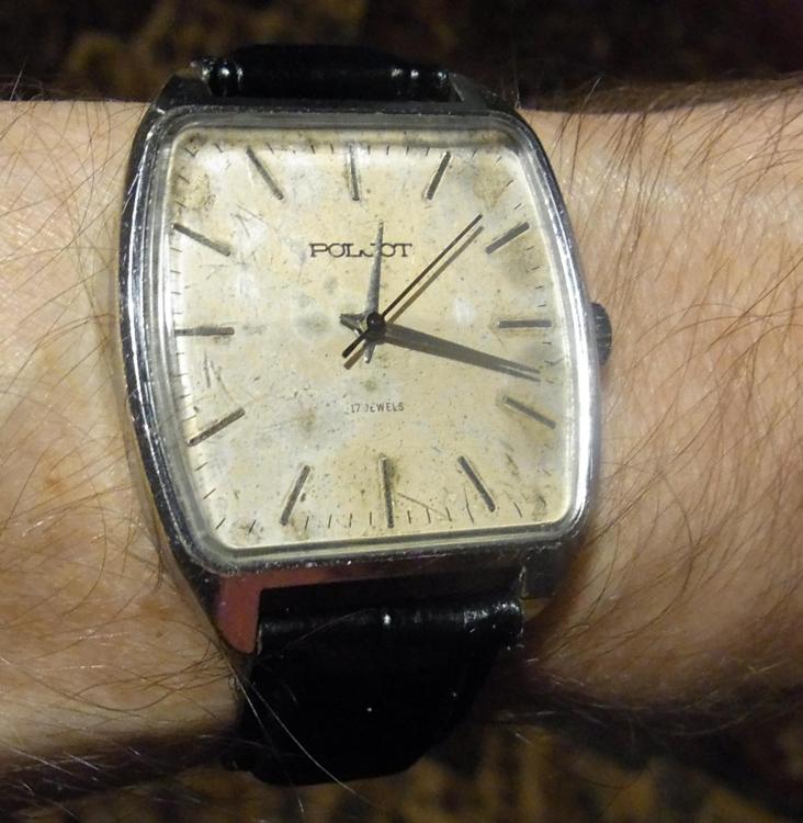

Another soviet ere watch got brought back from the dead. This time a Poljot 2906H based watch with a square face.
If patina is your thing, this has it in spades. I did clean up the face and hands too, but there is only so much you can do without stripping it back to the metal.
It had keyless work issues and needed a clean and service, and a replacement second hand. It could also do with a crystal, but I doubt if that would be easy to find, so the existing one got a deep polish.
I happened to have a steel Poljot band in the junk pile, so I popped it on that.
Half of the dial and one hand has been cleaned in this image. It did make a difference, but it is far from perfect.
The thing is running nicely though, so it seems to have really appreciated a clean and lube.

Just for completeness the Poljot is running reasonably well, if a little on the weak side, with a swing between 215 and 250 degrees.
Beat error is OK, and perhaps I could get it down a bit, but the adjuster is a little sticky, so it tends to overshoot and undershoot.
The timekeeping though is consistent, with positional error of -30 (crown right)  to +20 Face up which stays fairly constant over 24hrs.
Not bad for something that was a complete mess when it arrived.
Furthermore it is a very comfortable size, and despite the "character" on its face, also easy to read.  None of the pictures I have taken do it justice, those silver accents and hands are gleaming following their polishing and the patina on the face has a strangely marble like quality. The photos also appear to show a haze on the crystal that is possibly an infra-red artifact, as visually the crystal is glimmering and clear.
