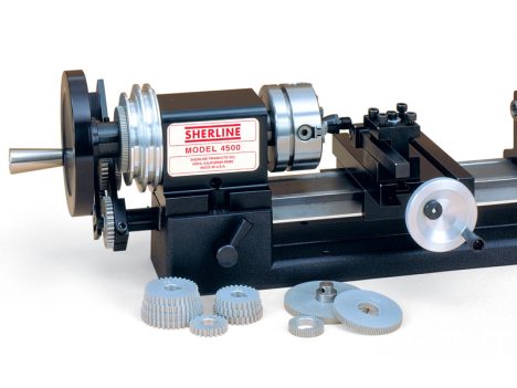

One (or two) nice things about Sherline is they have a screwcutting attachment, which could be nice for making casebacks and many other things,
Correct.
This low-cost attachment enables you to machine thirty-six different unified thread pitches (Pitch range from 80 to 5 threads per inch) and twenty-eight different metric thread pitches (Pitch range from .25 to 2.0 mm). It also allows you to cut them as either left-hand or right-hand threads.

This is what I use and love it, but my small Sherline is a Model 4000. Very accurate and refined compared to the Emco SL that I had.
