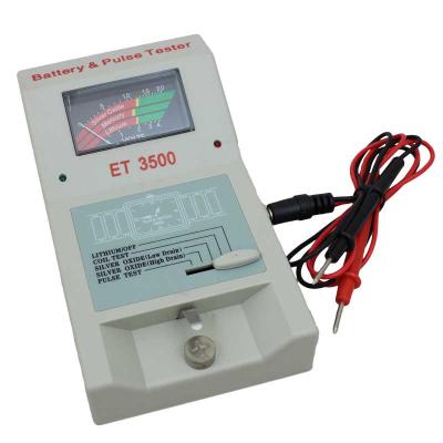

As gauges for battery replacement are based on high and diameter, no battery can -- in itself base on voltage -- damage the watch since all voltages are the same. A broken circuit (due to a nick while replacing the battery using metal tweezers), a faulty contact (pushing the wrong height battery and bending the contacts) or similar may be the problem. Also, there are inexpensive watch testers that could help out determining what is the actual problem.
This is one that comes to mind (once a good battery is in the watch):

I would think looking at that picture this requires a 370 battery. If it came to me, I'd test the circuit with a tester simular to the one already shown to diagnose any electronic fault & then run the train with a cyclonic to free any debris & then oil the jewels. 9/10 a "faulty" movement isn't it just need TLC.
