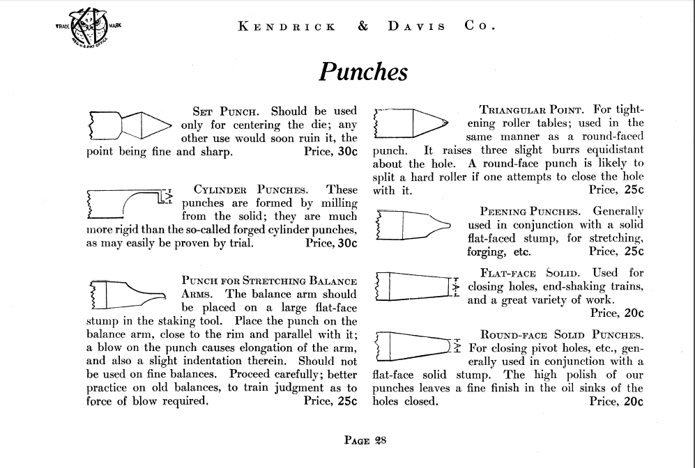

Aloha Folkvisor ,
You have a staking set so check to see if you have the stump [crotch ] , and punch [ peening ] , used to tighten the cannon pinion . And don't forget to insert something inside the pinion to maintain the round shape . I use a Lei needle we get here in the Islands to make flower Leis , but a heavy duty needle set used for leather or canvas would work .
You want to use a small brass hammer so you don't distort the ends of your punch  . Use light taps , but the needle inside the pinion is insurance against distorting the shape .
Go to pg. 75 for Info......
StakingToolsAndHowToUseThem1910FullTextSearchable.pdf
58bdb1b854ffe_ScreenShot2017-03-06at8_52_58AM.png.6fc82947e8a9b023dc12215f502dfd2f.png
58bdb1d873c66_ScreenShot2017-03-06at8_54_03AM.png.c434222a2a13bcab066dcf8686f0e628.png

Perfect--@ricardopalamino

Hi
I think I actually succeeded in tightening it. At least it turns the the centre wheel now and I'm hoping the watch will set as well.
I had to hit it a bit harder than a light tap. I held it with a pair of tweezers and that seemed to work fine. I actually used the sharp point punch and while I held the pinion on a flat stump. Anyway, it's tighter.
