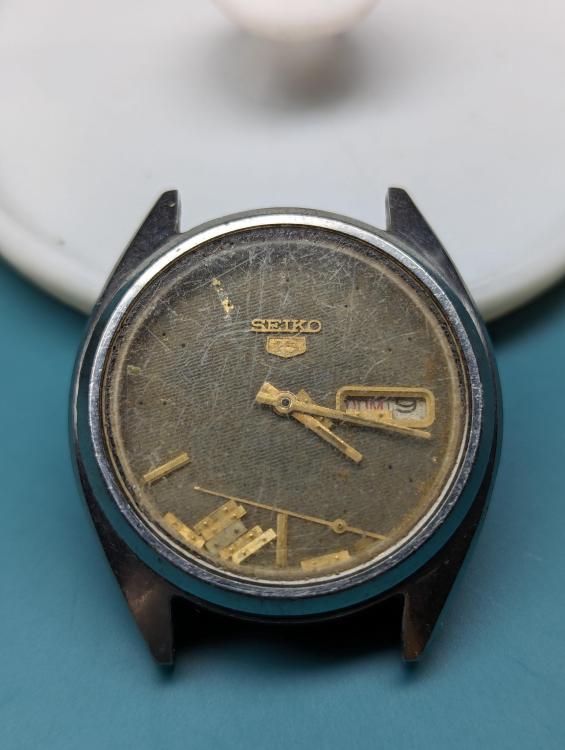

Just thought I would add a side note to my recent restoration, I used some super glue gel instead of regular super glue and found it far better to use on replacing the dial markers, here's how I did it in case anyone is interested 🙂
  1. Positioned the loose dial marker in its correct position on the front of the dial
  2. With the dial marker held in by friction I turned over the dial, so the back was now facing up
  3. I then opened up the super glue gel and squeezed a small blob out of the tip of the tube so it was just visible on the tip of the tube
  4. I then used a tooth pick to scoop up a small blob of gel from the tip of the tube
  5. I then dabbed a small droplet/blob of glue onto the foot of the dial marker that was sticking through the back of the dial with the tooth pick gel
    1. Being gel the glue stayed where I put it with little risk of running through to the front of the dial
    2. Being gel it has a slightly longer setting time, so you have time to play with it a little before its too late
  6. After it dried I moved onto the next one
  7. for good measure I also re-glued the markers which hadn't become free, just in case they were thinking about it
Hope this helps
I don’t think I’ve ever seen a dial lose the markers en masse like that. The conditions to bring that about must be interesting…
Well done as always Waggy!
14 minutes ago, RichardHarris123 said:
You shouldn't use super glue, it can off gas and cloud up the crystal.  I leant that on here.
…a good point but for a watch literally rescued from the bin I’ll allow it…👩‍⚖️
Thanks for the information, after reading your comments I thought I should get better informed on the subject. To summarise what I found:  it appears that the off gassing can only occur when the glue is active [3], or put another way the clouding/blooming/chlorosis can only occur up until the point the glue becomes inert, usually 24 hours [2] or exposed to moisture [1].
I think I did replace the repaired dial/crystal in less than 24 hours, so your concerns are well justified, I think in future I'll leave any superglued product out in the open air for >>24 hours just to be on the safe side and confident it is 100% cured and safe to re-install.

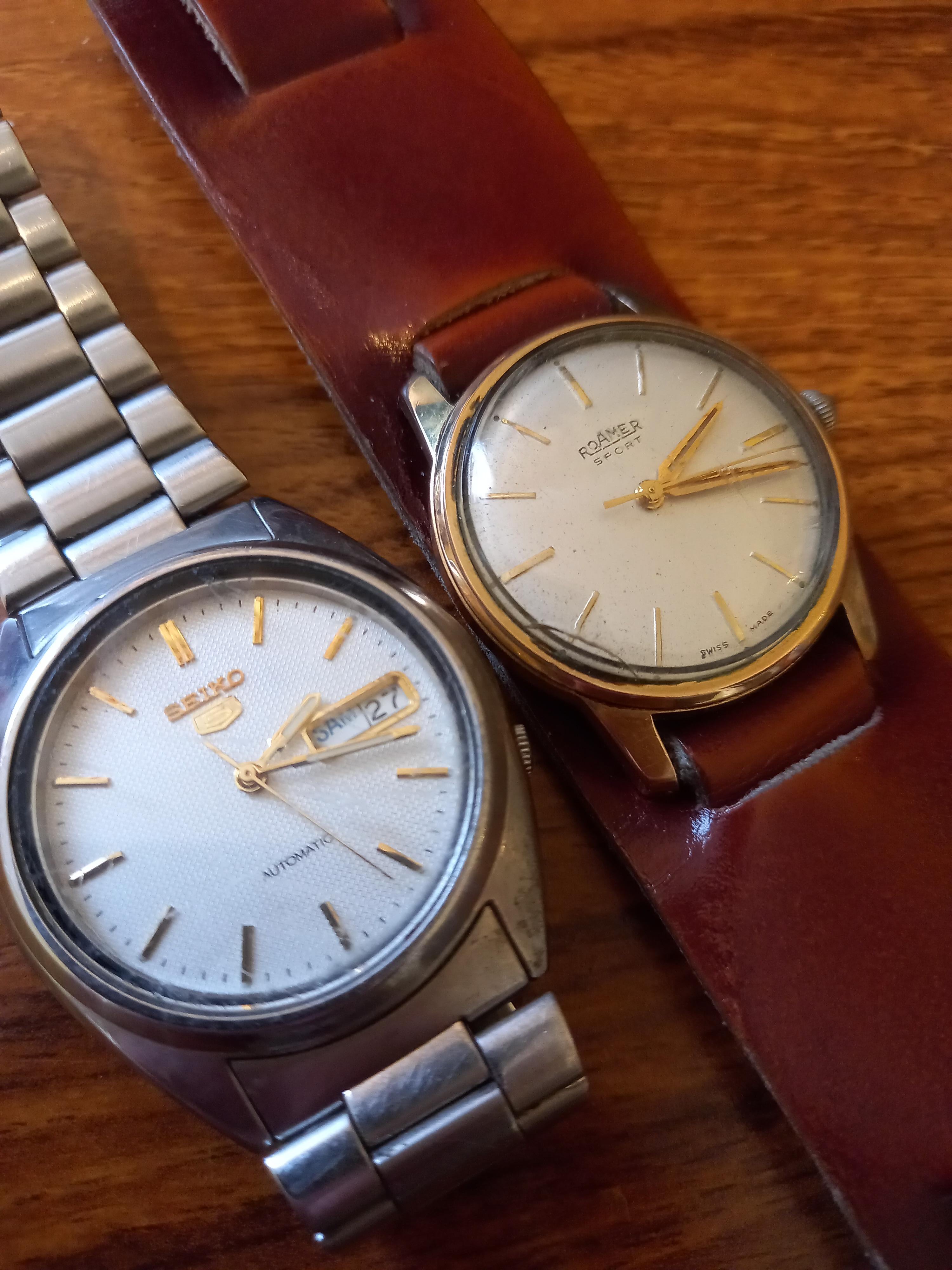

Just back from the Ayr Antiques fair. Spent my January spends. £40. Two watches. Both running.
Roamer Sport. Back marked 49 and numbered 9253. Winder. Cracked glass  +4s 212 deg   0.8ms  52 deg 18000
Seiko 7S26 0480 F, view thorough back. Time set for AM. Day still changing. +27s  177 deg   1.7ms   52 deg 21600.
Will service the Seiko.
Happy bunny.
