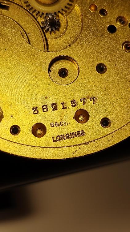

Starting work on my first pocket watch today, the one on the right. I got a nice surprise when I looked at what I thought was dirt above the seconds dial. Just missing one of the case screws that I will need to find. Going to replace the acrylic dome with glass as I don't think acrylic was around in 1935 (the date on the silver case). I paid £55 for it and thought I might have overpaid but not sure I did now. Steve.
Nice find, is it running?
Yes, pretty well considering. Just finished dismantling. That wasn't enjoyable. Canon pinion was unbelievable tight. I had to drive out the centre wheel eventually. Also yoke spring screw had sheared. Managed to get that out with a bit of teasing. Movement was full of old sticky lubrication. Some wear on barrel and centre wheel bushings that need staking out with the staking set. Looking forward to getting it all cleaned and assembled.
I've watched video's of people struggling to dismantle, I wondered, why not soak in penetrating oil first?  No doubt someone will tell me off. Hehe.

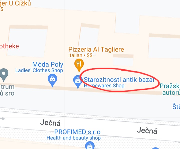

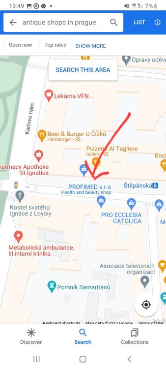

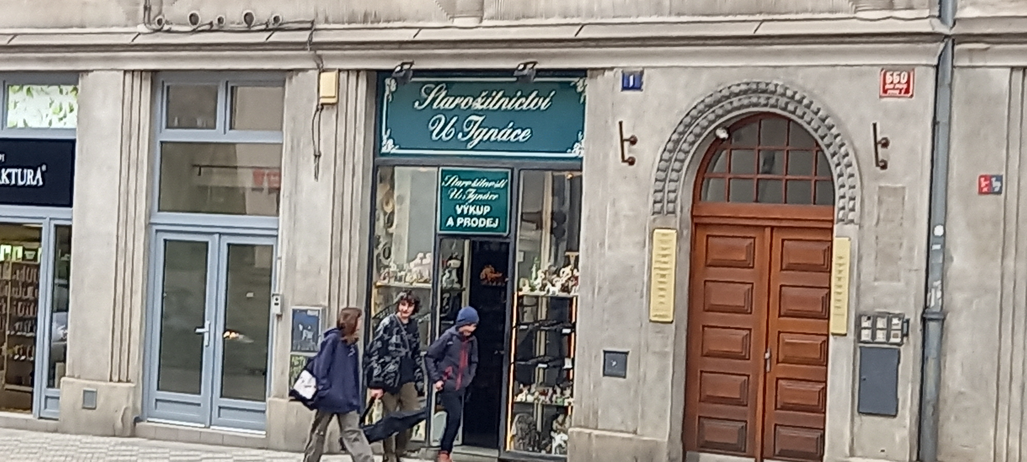

So the missus and me have spent a few hours today searching Prague for a vintage watch shop that i spotted on our first day here. It had a few Prim watches in the window that i liked and wanted one to remind me of our trip. Thinking i would return later in the holiday we retraced our steps but just couldn't find it anywhere. After giving up and heading back to our hotel in a different direction stumbled across two old traditional antique emporiums just 200 yards from where we were staying. These are the fruits of my luck today. A nice 1950s Prim dress watch and a 1940s art deco Certina with a KF 330 movement that was almost spotless inside. The two together was just over half the cost of one I'd chosen in the more upmarket antique shop I'd seen earlier this week. After leaving the two shops i looked up and thanked my watchmaking ancestors. 🙂
Do you know the address?  I'll visit when I'm there.
Absolutely matey i have photo of the road name and area on a map where we are staying. We leave tomorrow but if i get chance i will get a photo of the shops tomorrow.
The old town in Prague is full of antique shops most have watches. One was a proper old rummage your way through stuff called the Bric a Brac but his prices were way over. This is one of the two shops the other is about yards along on the same side but not listed on the map.
These were the best 2 shops unless you want to spend some serious coin.
