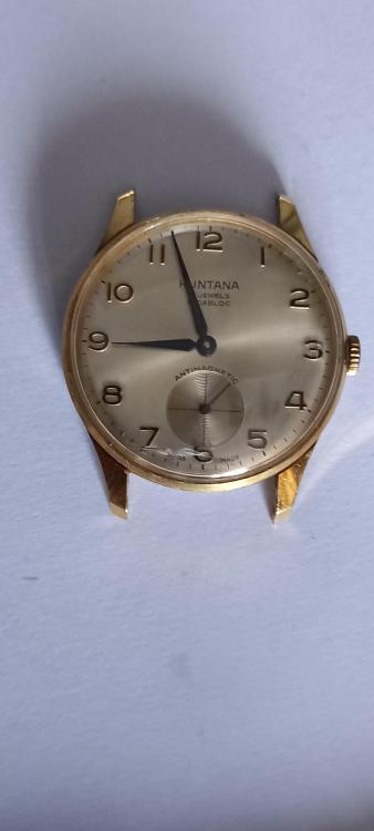

Morning UK,  and hello to the rest of the world. I hope you are all well. Today i have a nice swiss piece,  er watch that is 😉 . This is a Huntana ( cool name ) not running as yet but will probably be my next project. Inside is a Unitas 6325, as you will notice from the photos it has a hairspring issue ( just a bit lol ) but hopefully my superhuman skills can straighten this out. Besides this the watch has more to worry about than a dodgy mangled hairspring as you will see in the last photo lol. This is a bit beyond me and more in line with a visit to the doctor and a course of antibiotics. As a precaution during its repair i will be keeping my mouth firmly closed ( yeah yeah hard to believe   " Whaatevvaaa " ). And I will not be wearing my usual #  going commando # style of attire. Yes Gert and Richard you know what I'm talking about. And no Richard i wont be using 20x mag on my scope, bigboy needs wide-angle lens just to fit it all in 😆

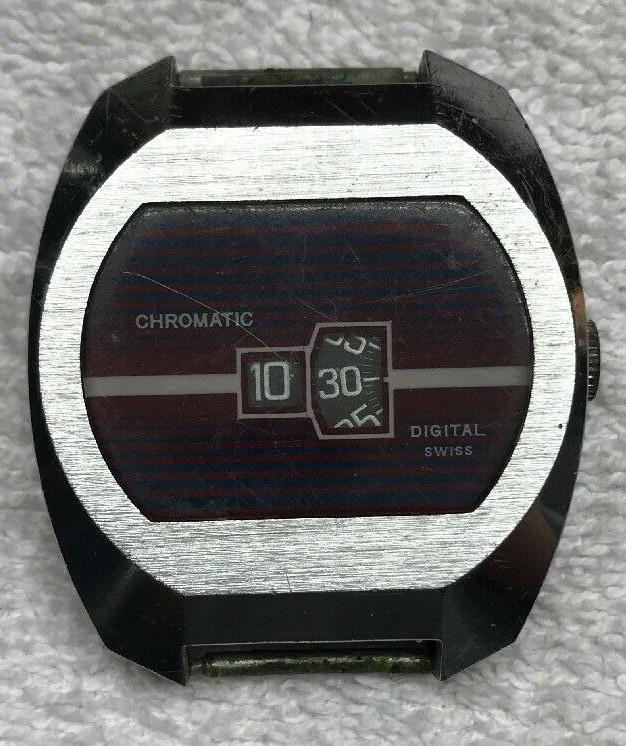

Today I decided to give my EB8800 based "Chromatic" "Digital Swiss" an airing.
Like it Andy . You have some really cool 70s watches. How are these to work on ? I keep looking at the jump hours, they're not often in good condition.
That particular jump hour is based on the EB8800, which comes in a whole bunch of different versions. Strictly speaking mine is an EB 8807. More details about that family of calibers here.
http://www.ranfft.de/cgi-bin/bidfun-db.cgi?10&ranfft&&2uswk&EB_8800
There are a couple of EB 8800 teardowns on WRT.
One here for example (this is an 8815 - jewelled - date version, but the basic mechanicals are the same).
The EB8800 is reasonably easy to work on, though the single bridge construction is a bit fiddly. Spare parts or rather spare mechanisms are easy to find on ebay, generally cheap as chips, and most of the parts are interchangeable between versions. There are jewelled and un-jewelled versions, but all are simple pin lever mechanisms.
The EB8800 does have some common failure points. For example the spring "bridge" that holds the mainspring barrel in place and the barrel itself tend to wear, resulting in a mechanism that will partially wind, then explosively unwind.
Swapping out the barrel and the bridge and anything else that has been damaged in the process will probably result in a working mechanism.
There are a number of other Jump Hour mechanisms. Search for jump hour or digital on -> http://www.ranfft.de/cgi-bin/bidfun-db.cgi?10&ranfft&&2uswk
The use of digital displays goes way back in the history of watch making, but they became very popular around the time that the first LED, and later LCD digital watches arrived on the scene. James Bond's LED Pulsar from Live and Let Die in 1973 has a lot to answer for in that regard.
This is what it looked like when I bought it in Feb 2020.
Not great shape, non runner, and a bit scratched up.
With a little bit of effort, a service and a clean and polish it came back to life nicely.
The crystals are custom, so if that is damaged, it would be pretty difficult to replace or repair, but other than that there is nothing particularly difficult about working on them.
