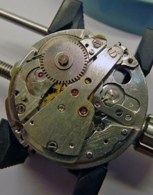

So far so good, although the rotor sounds a little rough (not uncommon on these). Lets see whats inside:
Bit grubby with a scraping rotor, but the bearings seem OK, so the rotor gets bent upwards slightly - don't frown, it's what Seiko recommends!
Out of the case, dial & hands off, strip down the dial side. Note the broken setting lever spring, I have a donor movement from a previous project and will replace this:

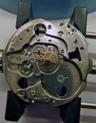

Turn over & rotor off:
Remove the winding gear:
Strip down the above, a bit of wear on the magic lever but appears to work fine, clean lube & reassemble:

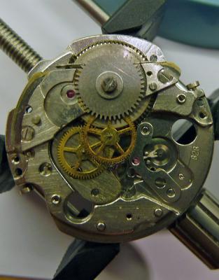

Onto the main stripdown:
post-80-0-85418800-1457206066_thumb.jpgpost-80-0-20739100-1457206071_thumb.jpgpost-80-0-53386600-1457206075_thumb.jpgpost-80-0-93160000-1457206079_thumb.jpgpost-80-0-37013400-1457206084_thumb.jpg
All in bits & cleaned:

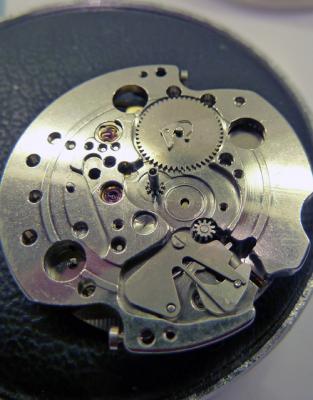

Lower Diashock dismantled, cleaned then reassembled:
Then it all goes back together:

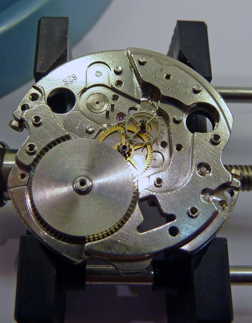

On to the dial side, setting lever spring replaced:
post-80-0-17426700-1457206229_thumb.jpgpost-80-0-58108000-1457206234_thumb.jpgpost-80-0-22170400-1457206240_thumb.jpgpost-80-0-15017400-1457210051_thumb.jpgpost-80-0-18601500-1457206583_thumb.jpgpost-80-0-08179900-1457206587_thumb.jpg
Into the case, reattach winding gear, rotor  & caseback on:
post-80-0-32648300-1457206591_thumb.jpgpost-80-0-09512300-1457206596_thumb.jpgpost-80-0-19572200-1457206600_thumb.jpgpost-80-0-03835900-1457206604_thumb.jpg

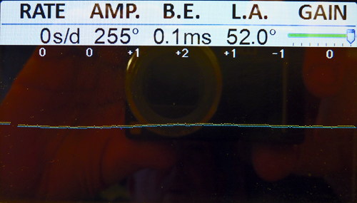

Jdm - timegrapher reading as requested:
Taken dial down, there is a little variance on other positions & I will give it another look in a week or so once its bedded in. The original readings before service were: Rate +/-13 seconds, Amp 194, BE 1.2
