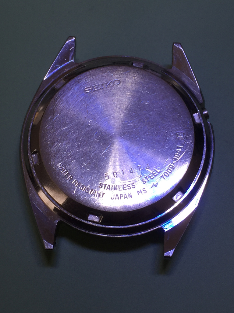

With  Seiko's  on the back of the case there are a series of numbers. Its the two hyphenated numbers that you need in order to get the correct glass. You will need your glass press to fit it. If you could upload a photo of the back that would help.

A picture of the watch will help, as Bob says it may be the wrong caseback. Also what are the numbers on the dial?

Hi Guys, This saga continues, having spent more on broken crystals than I paid for the watch I think it's time to show you the watch and parts and try to find a solution. Bob, I am using the hollow dies.
The watch it self I have serviced and oiled, tested and regulated and that seems fine.
So as you can see from the images I am now at the stage where I know that if I try and insert the crystal it will just crack again, I also purchased replacement glass gaskets but they are completely different and don't fit?

Hi alienfox,
I'm a little confused with your measurements.
I marked the total diameter that includes the gasket thickness + the crystal diameter together on the case. I believe the crystal is the wrong one (the one in the envelope = 31 mm). So, if the gasket available is not the same thickness but its diameter is equal to the total diameter - as the one I marked in the picture -- you should subtract the new gasket thickness from that total measurement to obtain the new crystal diameter. I always order, from the supplier, the next measurement and the previous measurement available in addition to the one I supposedly need.
Off the top of my mind, the crystal you are looking for (if you keep the old gasket) shouldn't even be 30 mm...more like 28 or 29 mm. The thickness should be close to 2 mm if I'm not mistaken...The divers usually take 2 mm thick. That is, you should expect the crystal not to be completely flush with the case but depending on models, it will protrude from an unnoticed bit to quite a bit. I believe your model is of the former type: a tiny, almost unnoticeable bit. This is not written on stone, since some models (not many in this brand) have crystal just under the bezel...the bezel acts as a protector...somehow, I believe it is not your situation. Either way, it won't affect the watch, only the looks...but you should have (based on your measurements, you call it "case recess") a 2 mm thick crystal which is the depth of the groove where it fits. The gasket, specially those aftermarket, should be a little under that thickness allowing for deformation (about 1.5 mm?).
Sometimes suppliers have a combination crystal + gasket that makes up for the total diameter that you need but, in my mind, is the wrong gasket for this model, i.e. that combination is with the L gasket and you should be looking for an I (i) gasket.
I hope this helps,
Cheers,
Bob
PS. With the replacement crystal that you have, since it is too big, if you are using the correct dies (to push it on the edges) you should be either destroying the crystal (literally) or the press with excessive pressure.

Does the technical manual for this watch not quote the crystal sizing? Or is that obvious
According to boley the crystal part # (Based on the details on the caseback) is 310W17LN00.
HOWEVER as one caseback fits LOTS of different cases, this might not be correct info.
