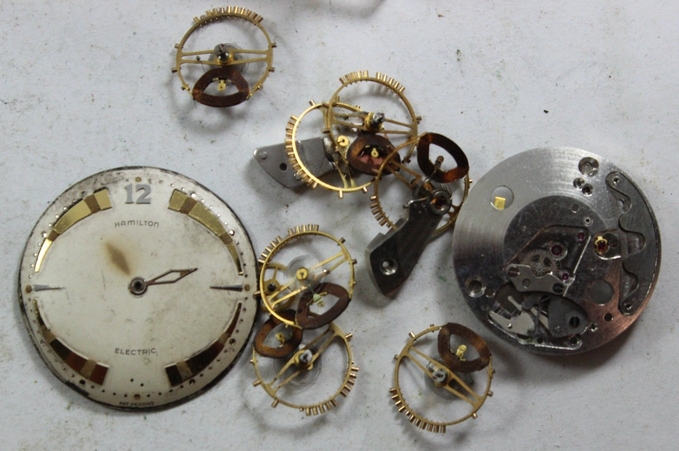

Sometimes , but not always . I'm talking about Hamilton Electric watches . I will remove the hairspring when I am switching to another balance because of broken pivots , or the coil is not good on a balance but the hairspring is , Also to rotate the Hairspring on the balance because when the crown is pulled to the setting position it hacks and stops the balance . The balance has to be in a position that when the crown is pushed back in , the hairspring has to jump start the balance swing being that its an electric watch .
Otherwise I leave the hairspring on and use the glass eyedropper to place the cleaner directly on the hairspring being careful not to get the coil wet with the cleaner . Coils are varnished covered wires , and if  they touch each other that can change the resistance , or possibly short the coil .
  As I had mentioned , I use a fine cosmetic brush , or a fine artist watercolor brush to carefully clean the hairspring and the contacts on the balance shaft .

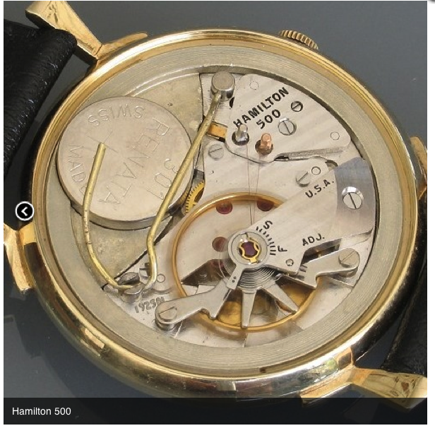

How does this electric watch have a balance? Do you have a picture of the movement. And I am not sure how you clean an electric watch with a circuit board, resistors and capacitors and coils. I can see cleaning the few hour, minute and second wheels.
Sent from my GT-N5110 using Tapatalk
These watches are pure electric , not electronic . No circuit board , resistors , and the coil is on the balance .
