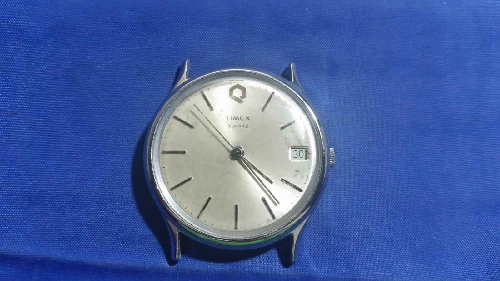

Just acquired my first vintage Timex quartz in the form of an original Falcon Eye. This one has one of the early quartz timed electro-mechanical movements in it. It was sold as a non-runner, hopefully it just needs a cleaning and a battery. I see these were prone to battery leakage, hopefully not this one. Overall it looks fairly decent. The gold finish has unfortunately been worn off the bracelet by some previous owners. Hopefully I'll be able to find a suitable replacement.

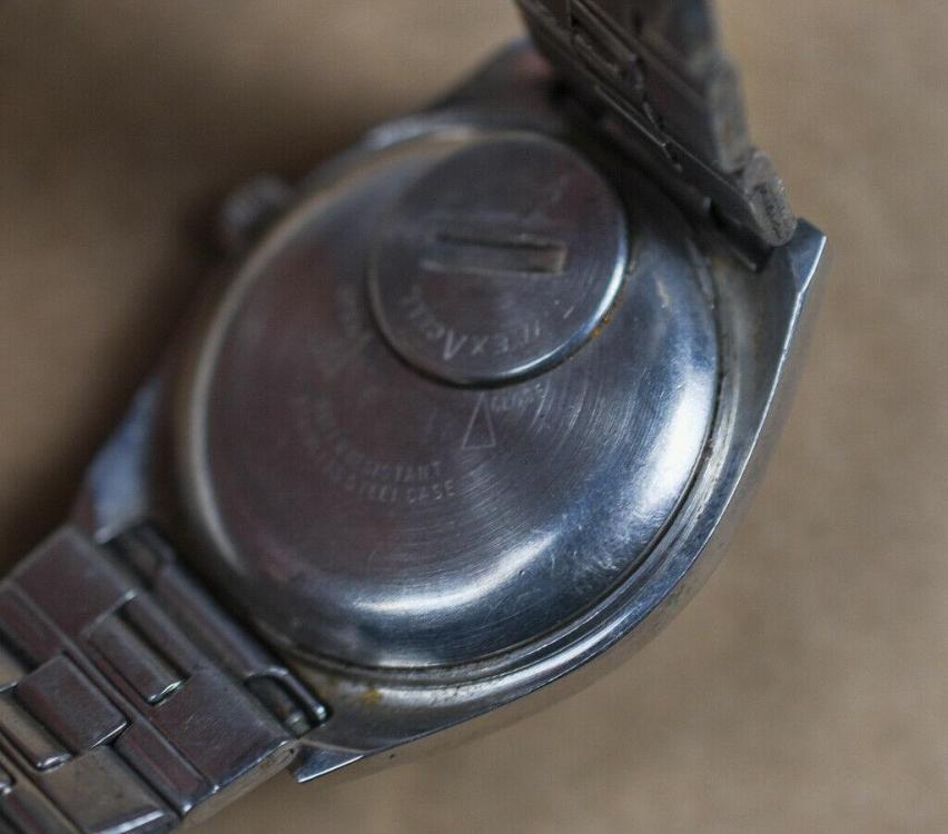

2 More Timex quartz watches on their way to me. The first is slightly more modern and I believe has a more conventional stepper movement. There is a recessed pusher on this model, I assume it's to advance the date? The second has a quartz regulated electronic balance with a Day/Date feature similar to my Falcon Eye.
here is that recessed date(?) pusher.
Day/Date Quartz regulated electronic balance model
