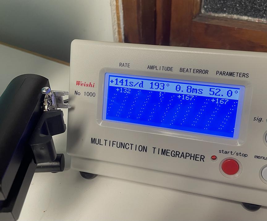

Attached is the initial timegrapher reading before working on the movement. The hairspring does move freely when I adjust the regulator. I think I'll try opening up the curb pin to give the hairspring more space. I know that's crazy tricky to do without wrecking the pin (I've tried on other movements in the past) so if anyone has a suggestion on how to do it, I'd greatly appreciate it.

oh and a note about the amplitude here in the timing machine. For instance the image I snipped out below notice the lines they look? In order for the timing machine to be believed you ideally need to lines they don't have to perfect lines but they should resemble two parallel lines not the snow globe affect as @Neverenoughwatches calls it or like this. Timing machines especially the Chinese one will try really really hard to give you an answer although in this chick a Figure out the rate of all that's why you get the little plus symbols it's out of range or cannot be read at all. But if you have that where we can't figure out what the graphical display is telling us that means the numbers are worthless. So you have to be careful on interpreting timing machines there are definitely some issues going on here.

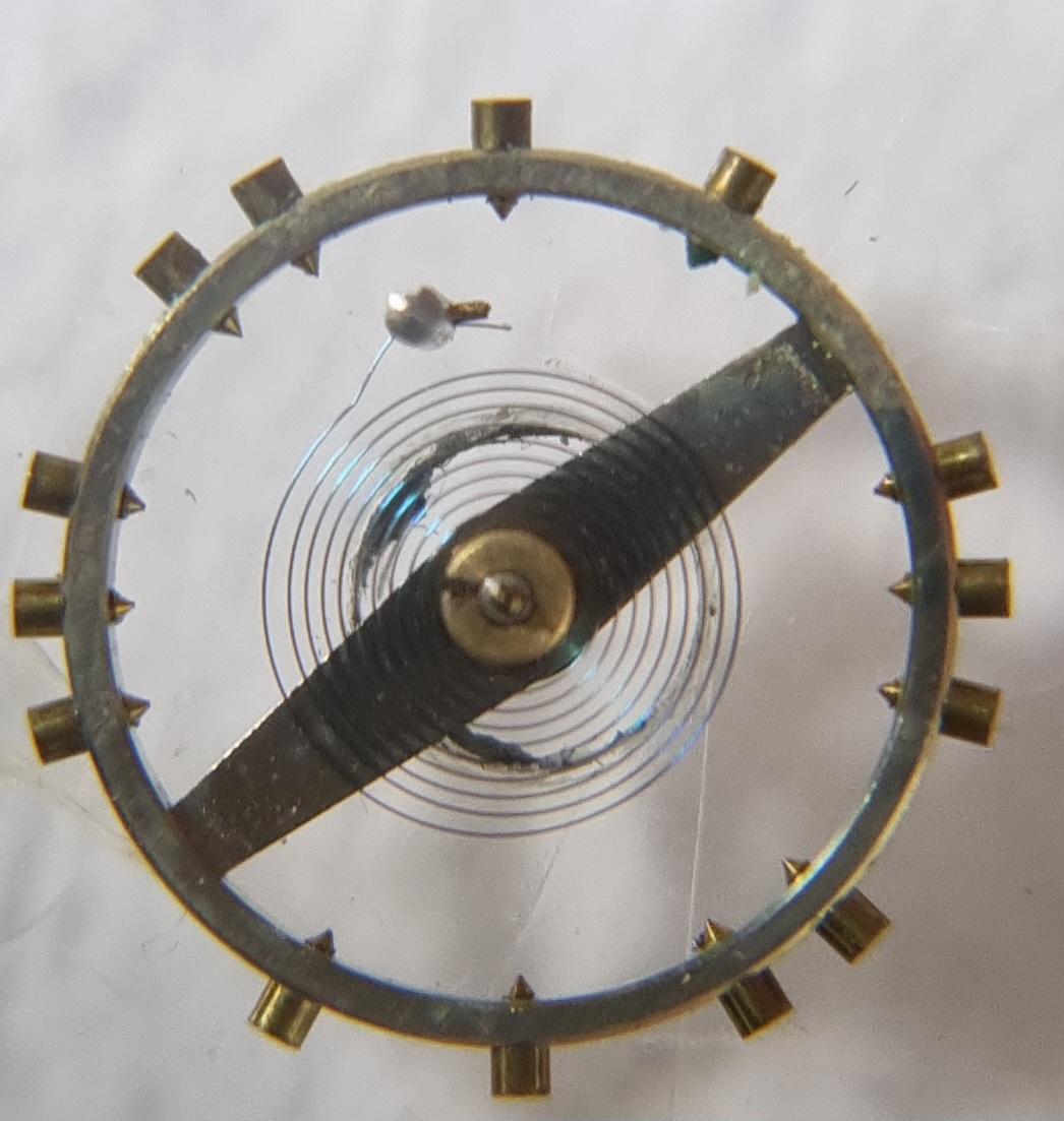

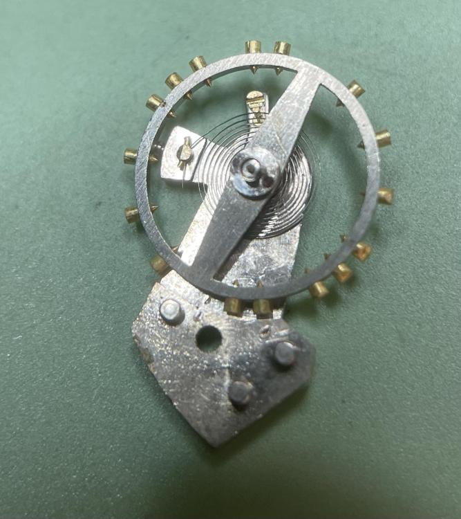

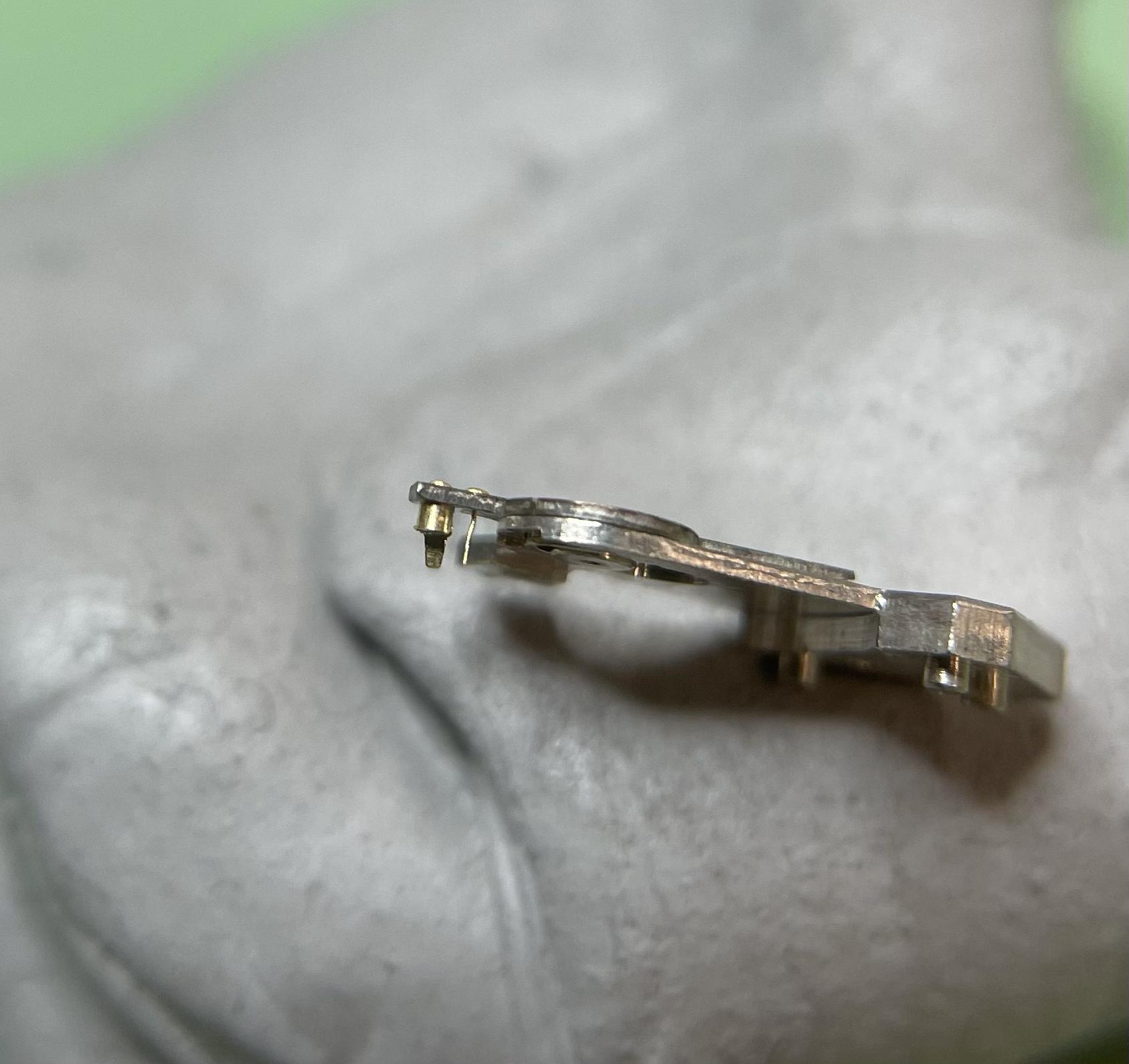

These are the best photos I could get. There's one of the curb pin and it's kinda bent - could that be the culprit? Any observations will be appreciated.

Difficult to say from these pictures. But here are a few observations.
here, it looks as if there is a possibility of the second coil (counting from the outside / the one that is within the regulator pins) could touch the regulator pins as well when the watch is running. See red arrow. That could effectively increase the rate of the watch (shorter effective length of the hairspring). Have a close look with your loupe/microscope when the watch is running.
...but on this picture of yours it almost looks the opposite. Very hard to say.
Have you looked from the side to see if the hairspring is flat and not touching anything?
Lastly, on this picture, you can see that a previous watchmaker has tried to increase balance endshake by creating bumps in the metal under the balance cock. So you know that the watch has been through some things. Possible that someone has replaced the balance staff or even balance complete (in old watches, this can often lead to timing issues when the hairspring is is a bit shorter that the original or the balance wheel a bit lighter).
Either way, you'll learn a lot from this one! Good luck!

 This is not making your watch run minutes fast, but I would unpin the hairspring to repin the stud at the most end point of hairspring.
When installed the coil looks bad.  I'd be concerned if tg showed this watch running accurate, concerned that my tg might be feeling unwell. 🙃
Rgds
As @Knebo suggests, the second coil could be hitting the regulator pin. I also think the coils could be bunched up on the other side to the stud and touching.
I agree with @Nucejoe that it would be sensible to repin the stud nearer the end. It looks odd that there is so much hairspring protruding past the stud.
What I'd do is remove the hairspring from the balance and repin the stud near the end. Then install just the hairspring back on the cock. You can then see if the collet is sat over the jewel hole, and make adjustments as necessary.
(Depending on your skill levels, repinning studs and tweaking hairsprings can be tricky, but it's a good chance to practice and improve)

I haven't done much hairspring work but isn't the terminal curve incorrect?
Yes its incorrect, thats what throws the coil out of center.
@DanB  terminal curve is at a radius equal to the distance from balance jewel hole ( or balance pivot) to midpoint of the regulator pin-boot. The coil should remain concentric and unaffected by moving regulator pin along the entire length of the terminal curve, here's how it usually looks.

Does anyone think that the (mis)shape of the pin is a problem (see attached photo)? Looks like at some point in time someone working on the watch tried to make an adjustment to it and it ended up like this. That's not something that's within my capabilities to straighten out.
