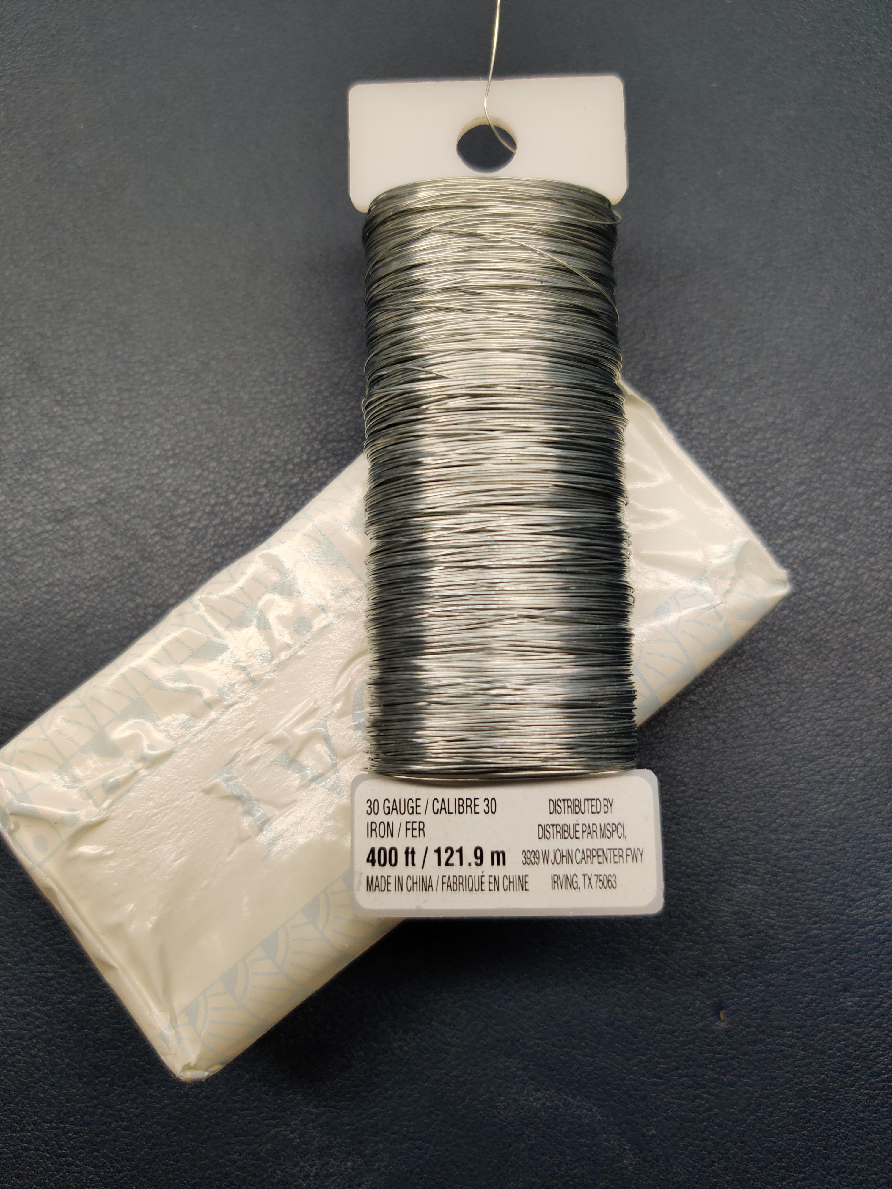

Since I'm starting to turn soon, the above is helpful, but does sound a little messy.  Does anyone use the technique that Tanaka uses at time index 40:28?  It appears he wraps the part in wire, drags it in some soap, indirectly heats, and drops into water.  He still has to scrape it with a fiberglass brush, but it doesn't look like too much work.
I remember seeing that video, and it is similar to what I've been doing. I just use boric acid or Borax slurry for flux, and mineral oil for quenching.  I think I will try soap, just to see what happens. The boric acid/Borax leaves a glassy coating which is a pain to clean up on a small part.
