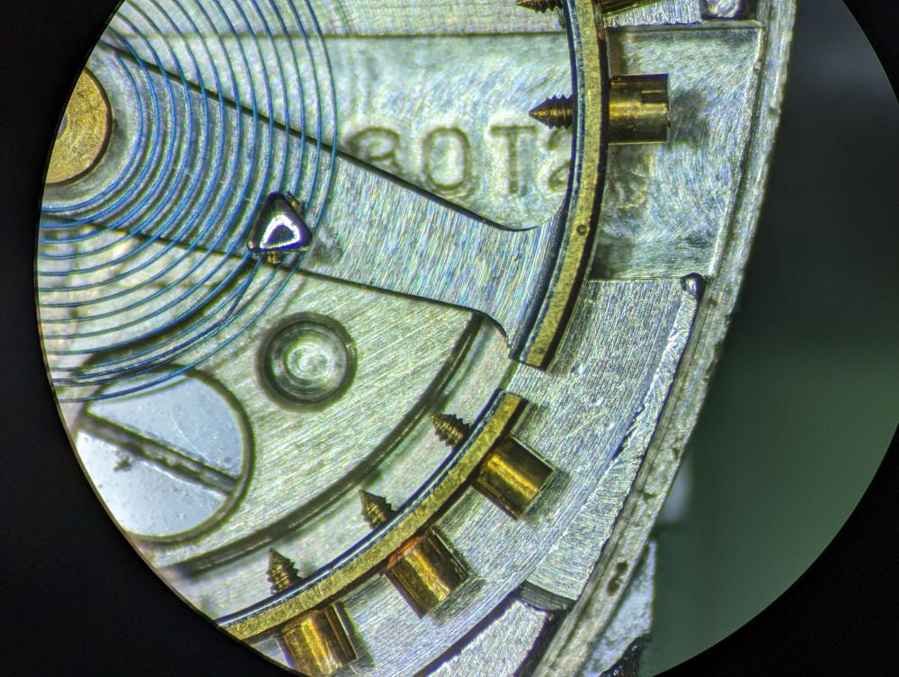

The current issue with this project is that we are running too fast (+240 seconds/day) and after investigating possible causes (magnetism, hairspring fouling, insufficient amplitude, squeezing of the balance wheel), I decided, with the advice of members here, to look into adding timing washers to slow it down.
I found a source of washers online and ordered some.  Meanwhile I have acquired a microscope and now can observe the current state of the balance in closer detail.  I noticed that there are three timing washers installed already in the neighborhood of the balance arm (on each side, making 6 total).  Here are some photos:
You can see the location of the screws with washers installed in the second photo.  Notice from the second photo that they are not installed closest to the arm, as I have seen recommended.  They are installed at the second and third screws, clockwise after the cut in the wheel.
I see two washers on screw 2 (one brass, one lighter colored metal), and one brass washer on the next screw.
One question I have for you, is whether I should add even more washers onto a balance that has already been fitted with washers?
Thanks as always.
No problem fitting more washers. What does your set of washers look like? The old nice sets had different sizes for different sized balances, with an approximate correction per pair of washers, like 30s, 1m, 2m. I know there are few examples available new these days, and some I've seen aren't particularly well graded, so you might need to check the poise (dynamic poise) quickly after each set added.

Thanks, I don't have the washers yet, but I did not manage to find one of those nice graded sets, so I will have to sift through them.

If you are using timing washers you need to have them on the same screws equel on both side of the the balance wheel. Can't you adjust the hairspring to slow it down?

Re-pinning the stud can easily lead to disaster (as I recently found out) - one slip of the tweezers and goodbye hairspring. Washers are much safer.
If it was my repair I would re- pin it I have never had any problem you just need to take your time and have a good strong eyeglass. Adding timing washers is not the way to go.

The last two hairspring I tried to re-pin: the first the spring broke off at the stud (where it had been tweaked a lot) as I pushed the pin out, the second  the tweezers slipped as I pushed the pin in, resulting in the same effect as the first 😟
Fitting timing washers hasn't caused me problems.
I agree that re-pinning is a more elegant solution, I just don't have much experience/confidence/luck doing it.

I can see now there is a debate about whether it is better to add timing washers or re-pin the hairspring.  I have never done the latter, but I can report that adding the timing washers was not difficult for me and I am quite pleased with the results.

I would say its swings and round abouts depending on what you are more comfortable with. Wouldn't adding timing washers also involve poising the balance wheel as well. And if the hairspring has only a very short extra length coming through the stud there may not be enough to slow the timing down. And as Mike says repinning can risk breaking the hairspring, then you have a faster watch or no hairspring at all.
My understanding here is that adding the washers symmetrically, on opposite ends of the wheel, will not alter the poise as the torques will balance during any repoising.  In other words the moment of inertia is modified, but not the center of mass.

providing you have the proper set of timing washers. In other words all the washers and one bottle are identical then poising is not an issue. They just go on opposite sides of the wheel they will balance out and everything will be fine. Providing there is no problems along the way. Or a bimetallic balance wheel some of them can be super soft and unscrewing and screwing back on screws and how you hold it may be enough to distort your balance wheel. It just depends on whether you have a soft one or not to use had to be really careful when you're doing this same as you need to be careful of the hairspring and not distort it when you're playing with the balance wheel.

You have had bad luck, yes it can depend on the hairsprings condition. Get hold of a few old movements and practice on the hairspring removal you will soon get the hang of it. Use a a pair of tweezers with very fine points I used  Dumont tweezers number 5. Good luck.
Providing all the timing washers are all the same in size and weight and the timing screws are all screwed back in at the same depth no  poising is needed.

It's my fault really. I didn't bother to make different length tweezers. Next time I will file some tweezers down. As I only have timing washers for small pocket watches, I sometimes have no option but to move the stud.
It also depends on the watch - if it's one where I can always find a new hairspring, I might tweak the stud. But if there's no chance of a hairspring replacement my first choice would be washers.

That is no question here.
Repinning is possible with flat hairsprings.
The above watch has a Breguet hairspring however, where repinning is forbidden and only use of timing washers is possible.
