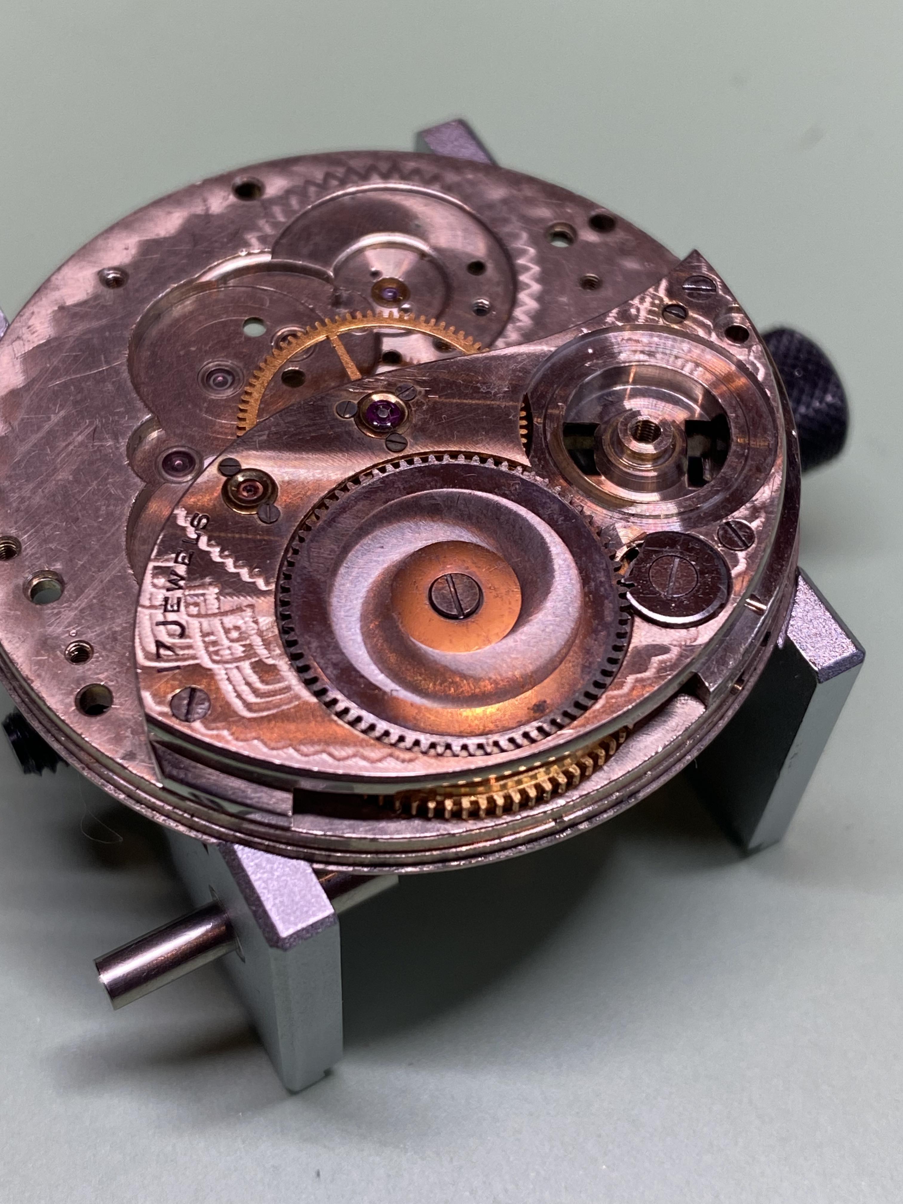

I’ve read through some old posts tackling this same issue, but after trying the various suggestions (except Coca-Cola) I’m at an impasse.
Tried (1) penetrating oil; (2) ultrasonic cleaner; (3) isopropyl alcohol in case of locktite; (4) heated kabob skewer tip and applied to screw head; (5) unscrewing clockwise as if crown screw.

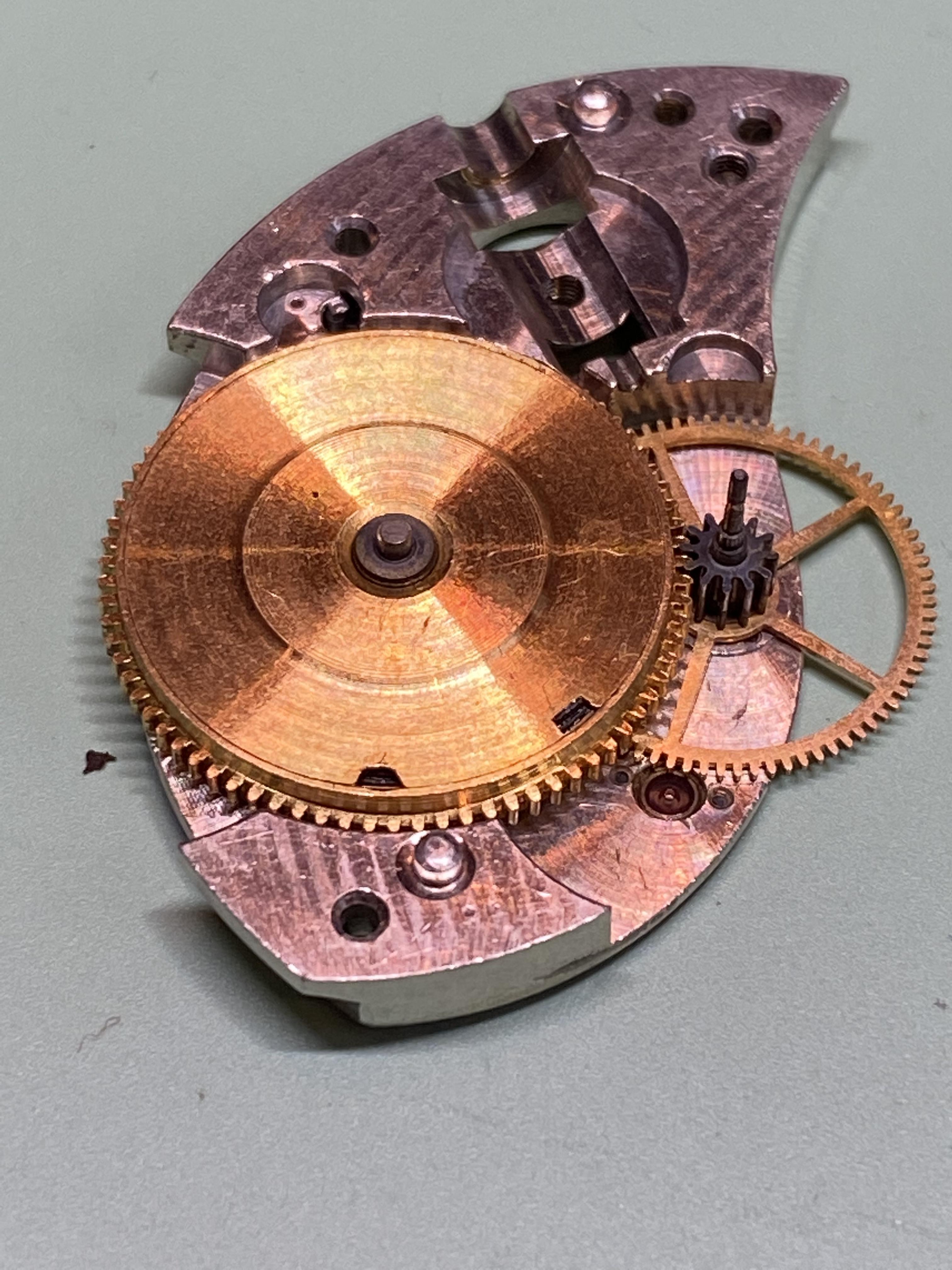

Unrelated, but there is no tension from the mainspring if wound, so I assume it’s broken or has come off the arbor (guessing broken since the crown stem was sheared).
Some pictures in case it’s helpful
Thanks all!

There are a few options if the penetrating oil doesnt work. Weakest to strongest also bere in mind some of these can be hazardous so precaution is needed. Gloves and ventilation. All will require neutralizing afterwards with water and then an ipa rinse, careful with shellaced watch parts with ipa. So first off citric acid either from lemons or a powdered form. Next acetic acid, vinegar contains around 5 percent which is enough to work well with a soak. Next up oxalic acid found in veggies, can also be bought in powdered form apparently but I've never used this. An old favorite next with the forum guys is coke cola with contains trace amount s of phosphoric acid. That is the last of the milder rust removers. So now the big guns and tbh I don't think I would ever use these, but worth a mention just for the hell of it. Sulphuric acid and hydrochloric acid, extremely hazardous and caustic in their concentrated forms and will eat through most things including rust and watch parts and body parts. 🔥. Last but not least a good proprietary rust remover, evapo rust is supposed to work well. Not Rustins rust remover which works very quickly and is pretty aggressive.
According to a Harley Davidson mechanic that I knew many years ago, "bee's wax has a smaller molecule size than most petroleum based penetrating oils" and therefore should soak into tighter places.  I have never tried this but if this is true, used with the soldiering iron trick, it might work.  Repeated heating and cooling cycles.
Shane
ok the would would do this is to sharpen a screw driver to the correct size of the screw head, and using a reasonable amount of downward force unscrew. if you have already  soaked the screw head i dont think you will gain anything by soaking the whole barrel im afraid. Again let us know how you get on.
The barrel arbor might have a worn out hole and the last watchmaker used Loctite to secure the screw. I have done it before too.
Drip some WD40 on the screw and leave it for a couple of hours. Then using the closed tips of your tweezer to pick up some acetone by capillary action and drip it around the screw to soften any rust or threadlocker. After a couple of minutes, you can try turning the screw very slightly. Be careful that the screw might have a left hand thread, so turn in both directions very slightly and see which direction has more give.
I just removed a very badly rusted dial screw using this method this morning.
This is I suspect is what I call a reverse thread. If it is the screw has just been over tightened. This is broken screw territory so be careful.
Soak in Coca-Cola for 48hrs, be generous with the àmount of Coca- Cola.
None  of the stuff you mentioned penetrate the screw thread as well.
In my engineering days we used to release screw/bolts fitted with loctite or rusted in, by giving the screwhead a tap with a hammer.
Maybe try this by putting the barrel with arbor on a metal block, using a wide screwdriver with point dressed to have a flat end and snug fit (but not wedge fit) in screw slot and tap lightly with a hammer. Just a few gentle taps though, nothing heavy or the screwdriver might split the screwhead.

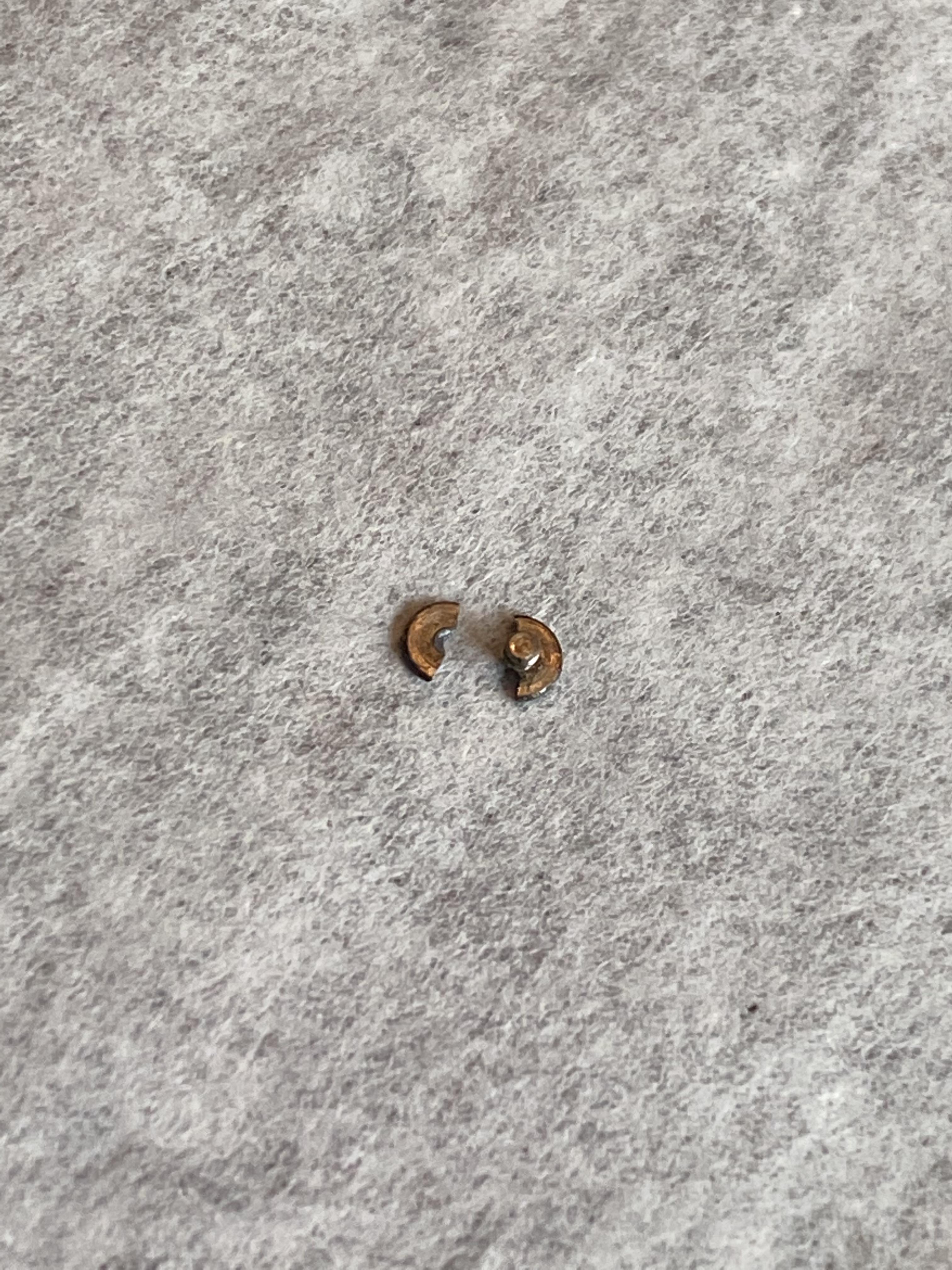

Drum roll please….. 48 hour Coca Cola soak did the trick and I was able to unscrew it fairly easily.
Fairly easily because, new to me (as is so much with this hobby), the screw head split in half as I unscrewed it!
Thanks to all of your help I’m one step further toward what I hope will ultimately be a successful service and return to service.
