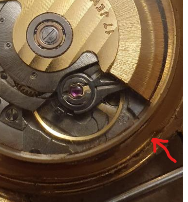

Looking closely around the edge of the back, is there a small lip anywhere, i.e. a slightly larger gap at some point?
Maybe near the arrow ?
If not, possible a front loader, as there's no case clamp.
 When there is no grip point for Jax or similar tools, its then a pop up or front loader.
Some watches put the lip where its hidden by the strap.
I think its a pop up and first time I see an ETA behind one, interesting as screw slots look untouched.

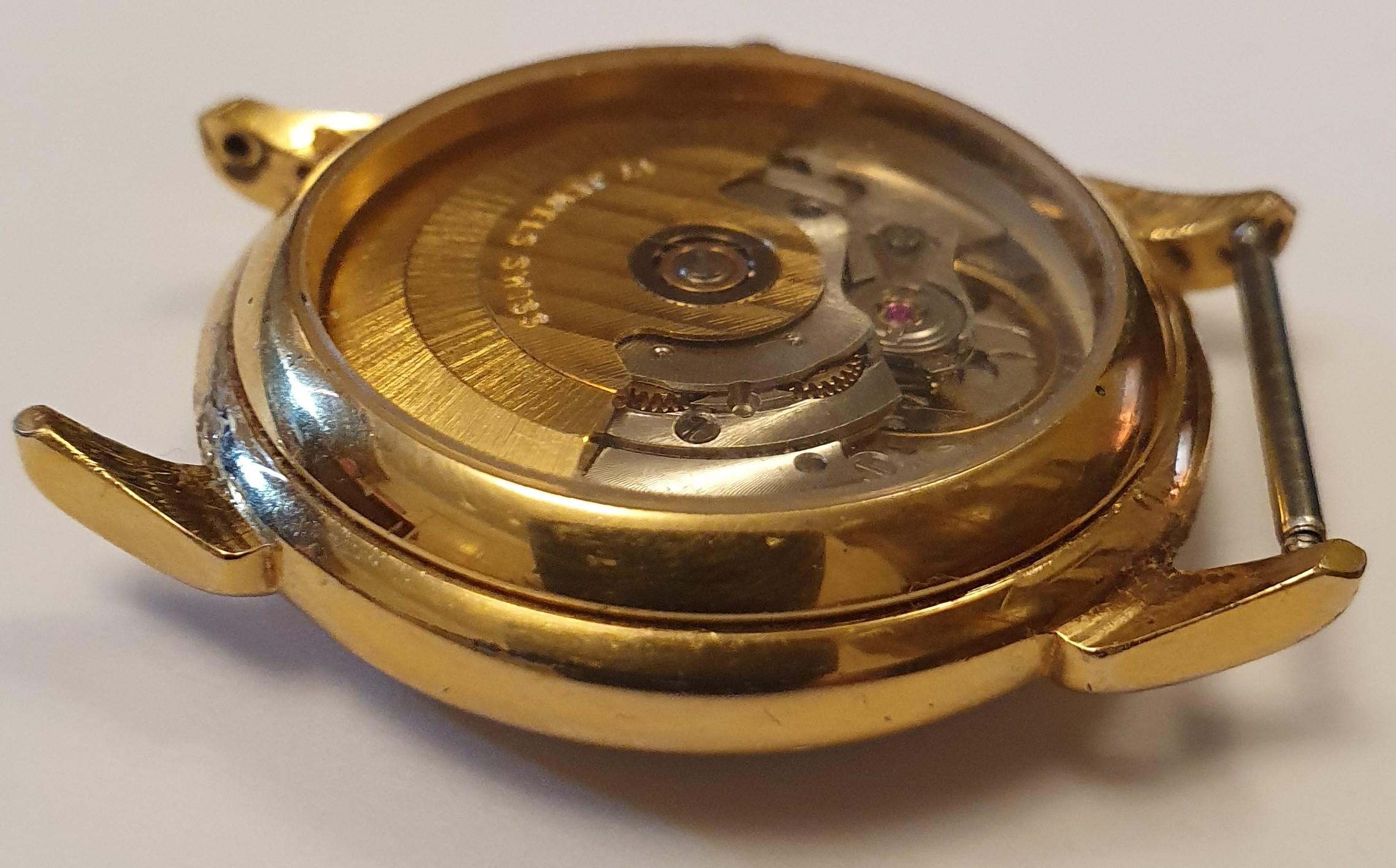

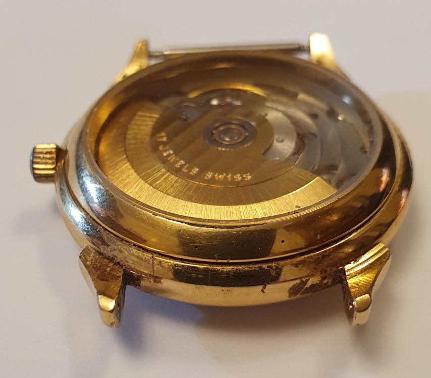

We need some slightly different pictures? It's hard to see what we need to see looking straight down. So we need some sideways pictures and maybe at a angle.
As @Nucejoe says, the screws look untouched, so the back has probably never been off, hence the lack of marks.
Rather than just dive in and try to prise it off, I would use a razor blade and work it gently all the way around the slot, just to get it started.
If the slot is not an actual slot, but just machined to look like one, then it's a front loader with a split stem. I've never seen one on an ETA movement.
I opened this exact model of watch today.  It’s a snap on back. There did not appear to be a lip, but enough of a gap to get a case knife in.

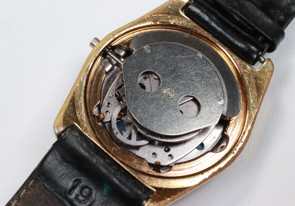

Well I have decided to place this watch on the todo list when I've have some practice on some other watches first. It's like this 30 to 40 year old masterpiece and the back looks like it's never been off just for me to come along at break it (not for me) I only paid 16 pounds for it but I was someone pride and joy some time. So I have bought a SAGA Timex auto movement to start on. this may also be someone loved time peace however it doesn't look so fragile.
Quick question how is the rotor removed I don't see a screw
3 minutes ago, Tiny said:
.So I have bought a SAGA Timex auto movement to start on. this may also be someone loved time peace however it doesn't look so fragile.
To save money these mov.ts used pressed posts and rivets, reduced parts count and more weird things. They are built very much unlike a normal mechanical watch. Not made to be taken apart and even repaired, the specifics of this simple fact do change from a model to another, but in the end they are an even poorer choice than a quality ETA for a beginner. If you enter Timex in the search box above you will get all the explanations and tips from the folks that know how to work on them.
If you really want it off grab it with something just rip it off.
