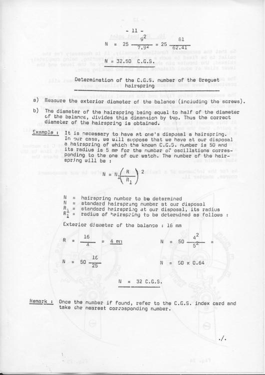

 Of those interested in the subject of this thread, some might not have come accross the following calculation method to  select the hairsprings you need. Their prices are considerable if you need one spring.
https://watchparts24.com/Balance-hairspring-with-roller-for-watch-movements-NIVAROX-New-old-stock
It provides you with a tabulated beat factor, which obviously has been worked backwards from original CGS No and dynamics of the oscilator/ spring.
Regs
Joe
What he does: he expands tables - that suppose the beat rate to be 18000 - to different beat rates.
You must still select according his table, with issues already mentioned. He avoids mentioning CGS, but that doesn't make things easier imho.
Frank
N.B. It seems - if I don't commit a fallacy  - his calculation is wrong.

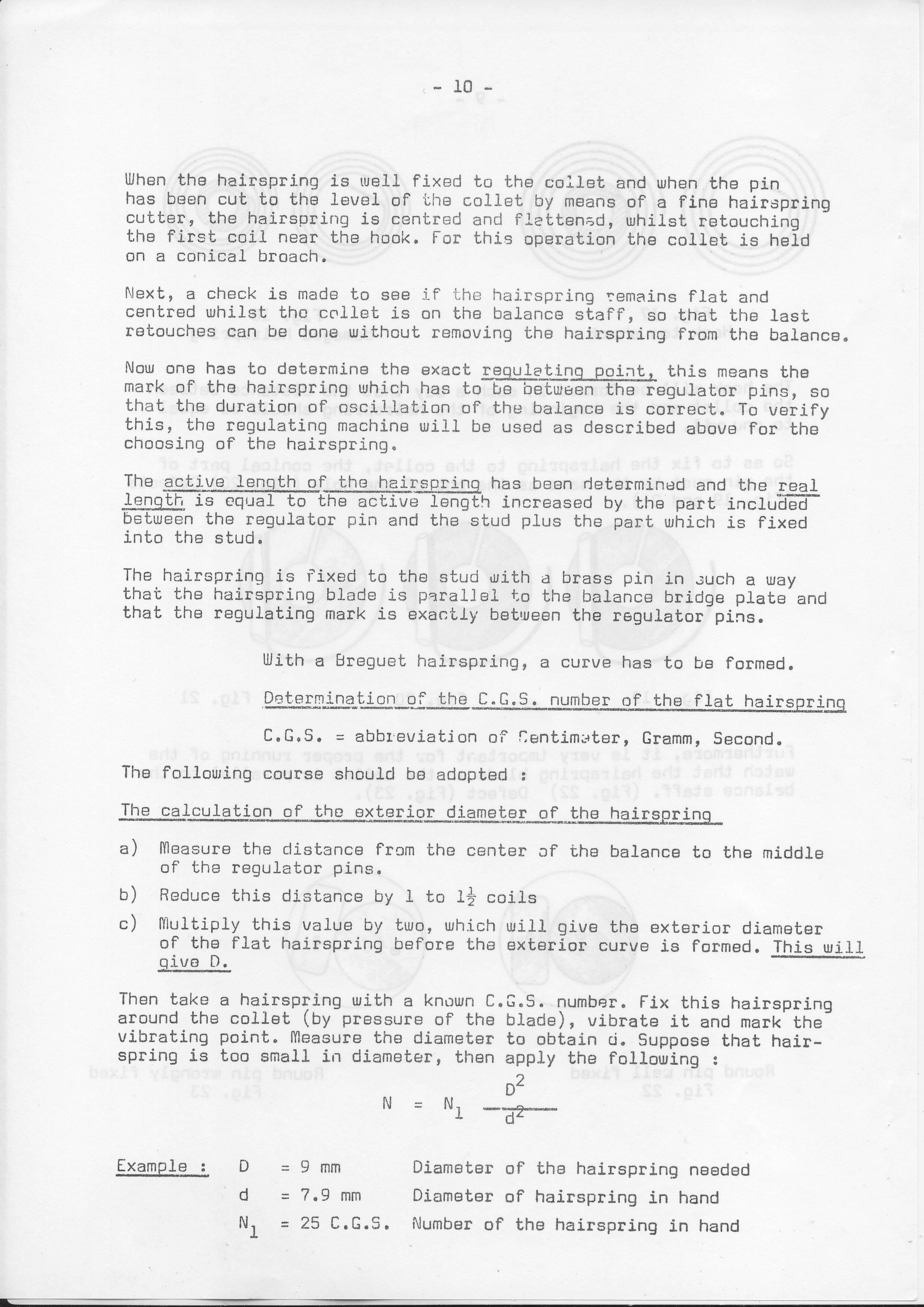

unfortunately I'm not a math whiz but I have a suspicion of what he's trying to do.
then if you look at the very bottom of his advertisement the fine print of "Please note: This is a raw hairspring that needs to be modified and regulated." which is a clever way of saying that it's still a raw hairspring you probably still have to verify by vibrating it and you of course you have to warm the terminal curve etc.
I have a suspicion what he's trying to do is adapt an existing formula. When you learn how to vibrated hairspring and one of those schools influenced by the Swiss they also teach you something else. Then as you can take and hairspring close to whatever you need as long as you know the CGS vibrated and do some math to come up with the correct CGS spring. To understand that I'm attaching some images some light reading for you math whiz.
