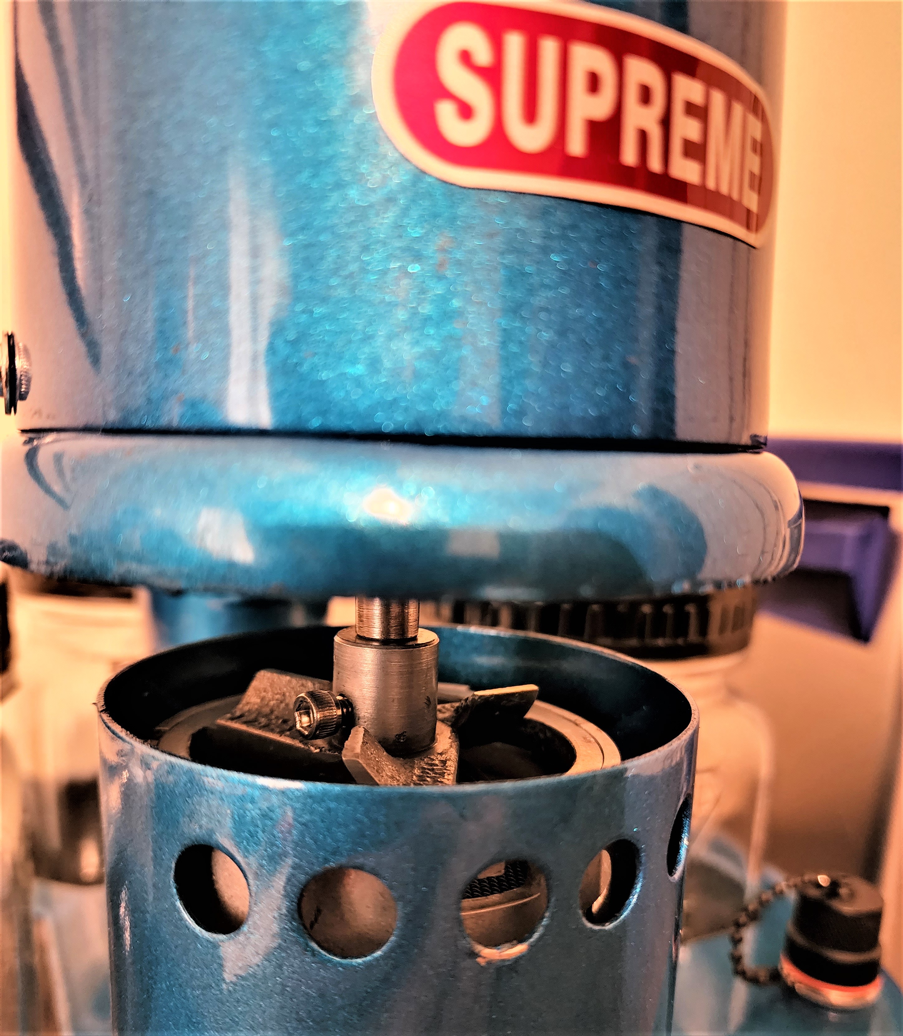

This is what it looks like when I'm spinning parts in the air. I have the parts reasonably spread out so the weight is distributed evenly. What do you guys think?
Mine would shimmy when I was in the spin cycle (in the jar, out of solution) causing the basket to creep up out of the jar, flinging solution everywhere. Then it died. Total waste of money for me as the guy selling it refuses to answer any of my emails.
Was your machine able to control the speed when it was in the solution?
Also, is the voltage correct for your country?
Yea. If the seller doesn't help me, hopefully Esty will. If not them I'll do a credit card charge back. Hopefully it never has to come to that.

What’s the quality of the baskets like? I’ve been uhm’ing and aah’ing getting one. I know full well I’ll end up rewiring it and making it safe, but the big thing is the baskets for me. I’ve read that the coating on them flakes off and end up in the watch parts - not sure if that was an isolated case?
Looking at the vid I would guess the basket is at fault or it’s not being secured tight. When fitting the basket it should be a a tight fit. I have owned/ used one of these machines for the last three years with no issues whatsoever..    As always it’s a case of the elimination process. Such as spin without a basket to see it all is true. Try a different basket etc etc. The pic shows the springs that add tension by pressing on the top of the basket .
