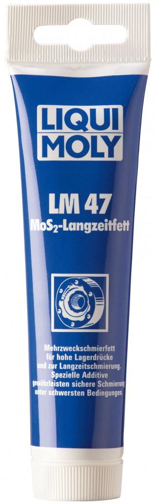

What do you think, can this be used as braking grease? [On a scrap movements for practice, not professionally] It is Molybdenum Disulfide grease for for extra long lubricity and high pressures. It has the same color and consistency as Kluber Chronogrease P125, and the main ingredient is MoS2, just like in P125. I am just curious, please don't rant at me 😄
Edited by Kramm

I have no idea, but I am looking forward to the results of your experiment!
I have tested LM-47 grease on an old Vostok 2416B automatic movement. The grease is thick and it really nicely adheres to the barrel wall. Under pressure from the mainspring, grease liquifies and because of that, it probably sticks the bridle to the barrel wall, not letting it slip until the very end. My conclusion is that this grease has good braking properties, and MoS2 should protect the barrel wall from wear. The only question remains how long will it last...
Langzeitfett - should last a long time!
Seriously, if you get the specified power reserve, and it doesn't spread everywhere, especially outside the barrel, then I don't see a problem with it as a cheap alternative for your own watches. If you remember, give us an update in a few months.
As an added question kramm, would you use this on the barrel wall only and leave the rest of the mainspring unlubed?
