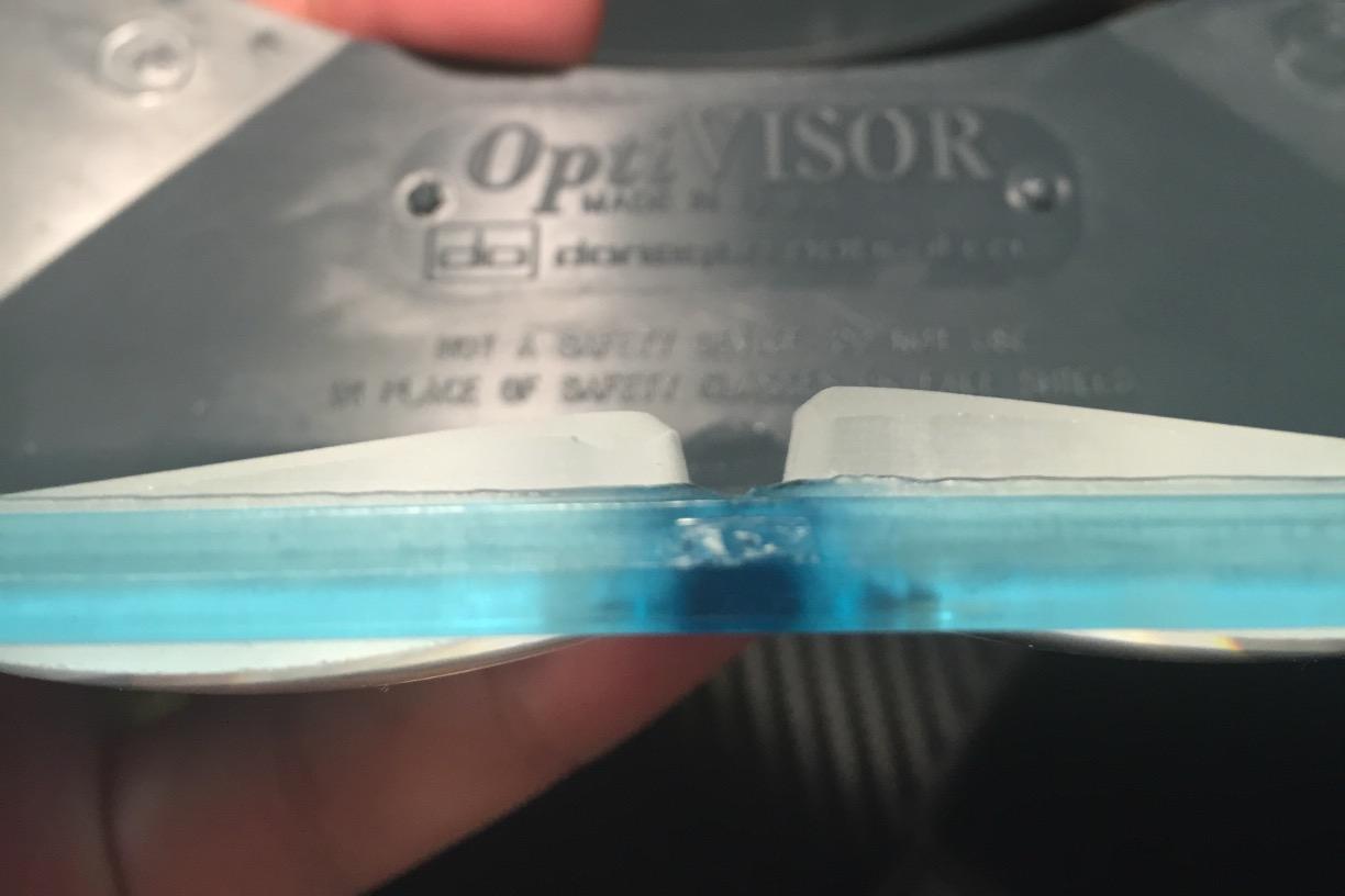

That AliX link is essentially what I got on Amazon. The stereoscopic lenses were just two lenses side by side without any prismatic compensation. Both eyes were magnified 3.5X (I assume), but the focus was not in the same place.
What do you mean by the focus is not in the same place?  You mean the image in both eyes do not converge into one coherent image? Or do you mean the focal distance is different for each eye?
Did you try the other lenses that came with your visor?
I found the same problems with cheap lenses. They may work for some and not others. I think I’ll invest in good quality glass.
When the focal length is short enough (i.e. with the 3.5X lens), if both lenses are arranged in parallel, the lenses are focused a few cm apart.
image of lens arrangement
If you look at the above image (it's an image from an Amazon review complaining about what may prove to be a counterfeit Donegan visor like I might be about to receive, so it's not the most perfect example), you'll see the lenses are positioned so that they meet in the middle and the object being focused on is in focus for both eyes. The ultra cheap lenses that came with the $8.88 visor I got had them totally parallel, so there was no way to be looking at the same thing at the short focal distance.
Edited by spectre6000
Ok. I understand now. That "toe-in" angle is called the convergence angle.
The visor loupe that I have has a built in convergence angle. Even though the two lenses appear flat, if you look at the left and right edges of the lens, they are thicker than the middle where the lenses meet.
But then, with a simple, non-adjustable setup like this, it doesn't suit everyone. If you are lucky and the distance between  your eyes (inter pupillary distance) is the same as that of the visor, then all is good.
Even if you get an expensive surgical binocular loupe, you have to adjust the inter pupillary distance to suit you. And in my case, even the convergence angle didn't suit me. After using it for five years, squinting through slightly skewed lenses, I decided to do what the factory warned against doing. I loosened the lock screws and set my own convergence angle. And I have been using them for the last fifteen years.
