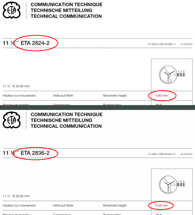

Yikes, they are proud of that one aren't they? I'm with you - I wouldn't pay that kind of money for that movement. Also it's a 2824 and my friend's case that he wants to build a watch around is for a 2836. I know the two are close but the 2836 is 0.45mm taller and I've read that the stem won't be perfectly centered on the tube if you put a 2824 in a case designed for a 2836 (though I've never done it).

Also, if the difference between a 2824 and a 2836 is the day function, I was under the impression they'd just be leaving those parts off. When I get around to it, I'll be removing the ghost day/date from the 2824 in my daily driver, and I'll just pull the parts and swap the detent spring. Why would there be a height difference?
Regarding using a Sellita this is a great suggestion. I looked up and found the SW220-1 is compatible with the ETA 2836. The height even matches at 5.05 mm. It's available in "Top Grade" for about $220. Very nice. Thank you.
Regarding the height difference between the 2824 and 2836, I would have thought the same as you - that the two movements differ only by the day ring and would be the same height. Perhaps the additional height is due to the circlip that holds the day wheel on?
In any event there is definitely a 0.45 mm difference in height according to the ETA service sheets. See excerpts below.

Well one advantage using a 2836 over 2824 even for date only is the instantaneous day/date jump the 2836 has. The 2824 has the date start tilting slightly for about 10 minutes before the jump. Some would say semi-instantaneous. But the 2836 flips both day and date Rolex style: absolute-instantaneous. Simultaneously. You blink you miss. It's pretty neat.
