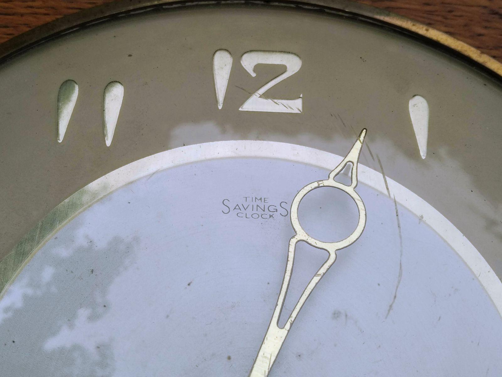

Hi Clockmakers,
look what I got! :) It does not work and I don't have florins at the moment but hopefully none of the situations will last forever. :)
link1 , link2

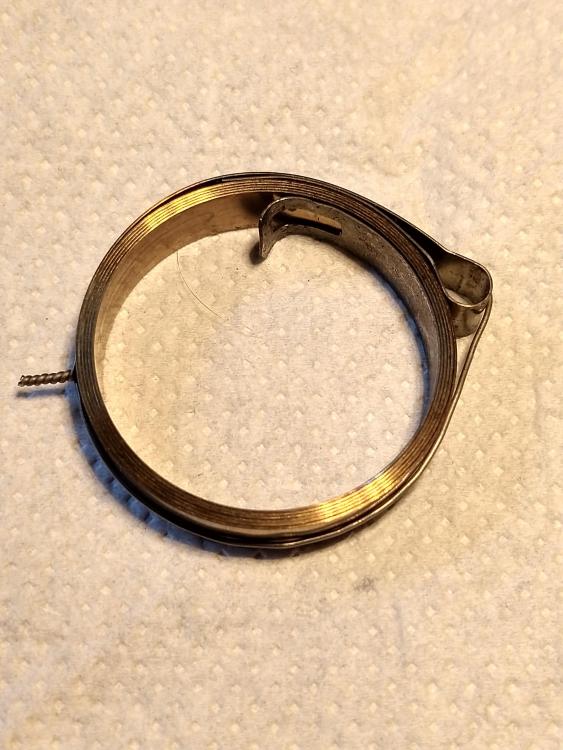

Hi *,
The main spring is broken and someone tried to fix it by wrapping sewing thread around it? Is that a common method to fix mainsprings?
I removed  the other half of mainspring, but how do i remove the arbor now to be able to remove the rest of the broken spring and replace it? I can see marks on the arbor do I have to grab it somehow?
Or should I remove the ratchet wheel? Its pretty tight.
I would go so far as say its a very uncommon method, I've certainly never seen or heard of anyone doing that before.
The end should just have a hook on the arbour and a hole in the spring so you should be able to remove it without dismantling any further.
Likely the thread is just making that hard for you to see.
I managed to figure it out. What pliers are the best to grab arbors without damaging them? I use sheet of papers trying to protect them. Pliers without teeth? Plus protection? I need to source a mainspring now and I cant find my bag of springs....
Use leather to protect the arbour when using pliers, seeing its brass you could have also gently heated it the expansion would have been enough to make it  very easy to remove.
The main spring just hooks over the post. Its the one nearest to the wheel with the arbor, so when it winds the end that hooks over the post is protected from slipping off due to the mainspring being close to it.
Sewing thread, orphaned earrings, long dead mice; you never know what you might find in a used clock.

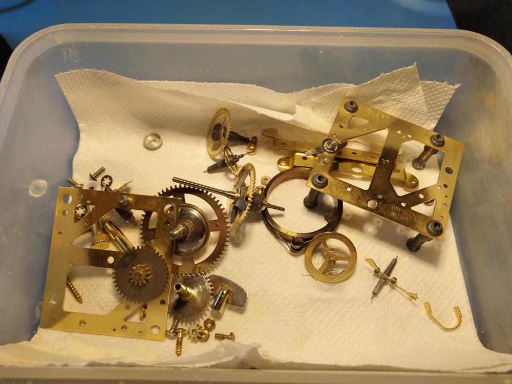

Or my favorite lifeshortener hobby, hairspring bending?
I tend to think of it more as an act of intense concentration. A bit of engineering Zen. Or possibly a test of character, how long can you resist the urge to put the spring out of its misery with a large hammer :judge:
I blame you for this, it says: Made in Scotland :D
The best I could do with the hairspring, not perfect, but after so many defeat I call it a draw:
The place where this wonderful piece of beauty was made, the person who operated the hammer did not have his morning haggis so M and S are missing:
The movement together:
I had no faith - plus a was lazy and did other important things as playing computer games -, that's why it was sitting on my bench and I did not touch it for a week or so, and i don't know if it is in beat, but it actually works!
