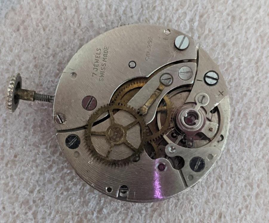

Following on from my post in the new member section, I've had a brief examination on my effectively 'spares or repair' Cal 292 movement by Oris.
In summary:
The watch appears stuck at 'fully wound' - the crown spins freely when winding it counter clockwise, but will not turn clockwise.
When pulling the crown, all hands rotate albeit with a very stiff motion. When tapping the watch, the second hand will increment a few seconds.
Also, I'm aware of the graveness of this mistake, but I accidentally unscrewed the 'set lever screw' too far when removing the crown and stem, and the watch is now stuck in the it's normal 'operational' mode (Argh!)
I've got a few questions to get started;
  • How do I remove the movement from it's case? I've removed the 2 case screws but can't get it out. Pulling at it with tweezers does nothing.
  • I wanted to look at the mainspring and movement train, but can't see how to remove the bridge underneath the fourth wheel (?).
Please see photo below of various screws removed, but not much else.

The movement is probably in need of a total service with cleaning and lubrication since the drive train is in a dead halt.
I see you got the stem out and been picking various screws away.. guess if you turn it around and take the crystal away with a crystal lift the movement will pop out through the front with a slight push on the back.
Just some theories i have since one can't see the front of the watch.
first thing I would do is put the screws back in  because if the watch really is fully wound up when you take it out of the case and those plates falloff all the mainspring energy is going to unwind really fast it's probably got break something.
then  from the link below you find out that the ratchet wheel is under the dial side.  More than likely from your picture  the move but probably comes out the front side..

Gears in the rocker arm could be damaged.
Ratchet wheel is placed under the dial.

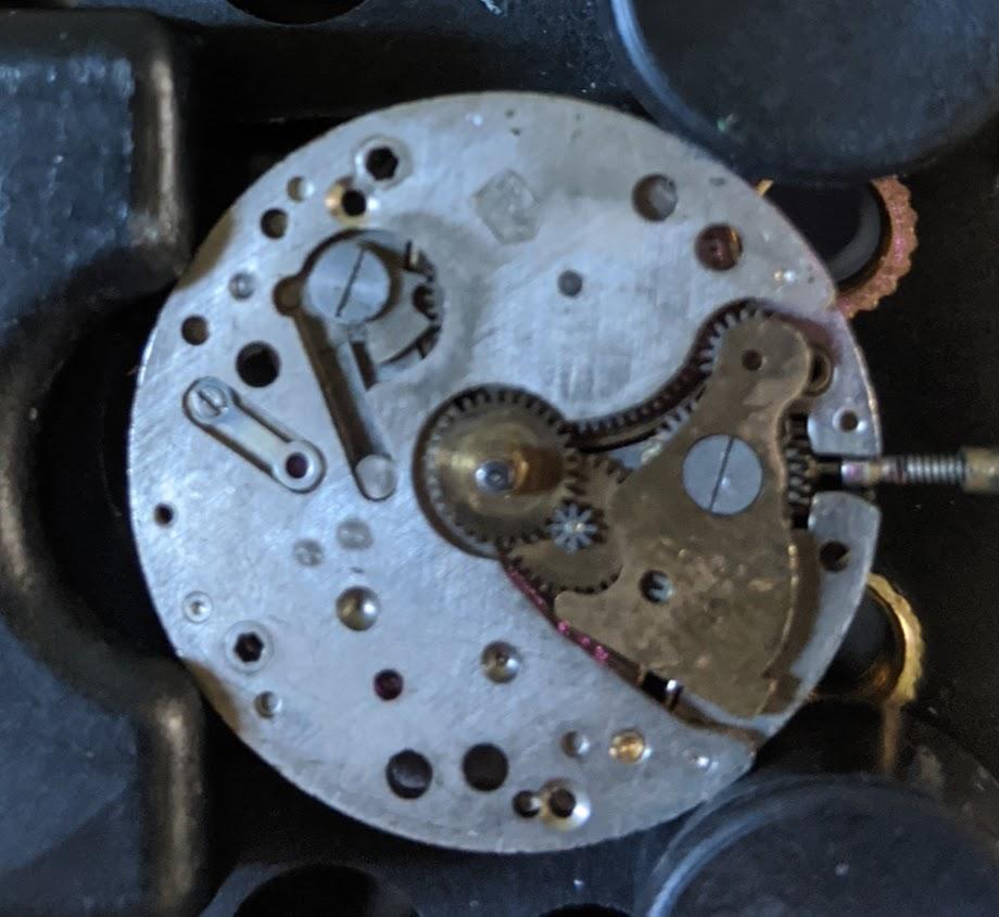

Apologies, please see watch face pictured below:
2 hours ago, Nucejoe said:
Remove the movement retainer ring, it dosen't just pop out you got to pry the ring out.
I've levered upwards in the void to the left of the balance wheel (about 9 oclock in the picture above) with some force, but felt no movement, assuming the is the right area?
Movement comes out thru the front. And as suggested, replace the screw in the plates (apart from the ones around the rim) otherwise the whole thing may come apart!

Please follow John's advice. Re-fit the plate screws and remove the crystal and try to remove from the front. If it lets go without any control the movement could be permanently damaged.
Click mech and ratchet wheel are on the dial side, based on your description that " hands move with very stiff resistance" the fault is in gears of the rocker arm which constitute a train to the ratchet wheel when in wind position and another seperate train to make a minute train in set position.
Bridge will slide out once the movement is out,  as explained screws to the bridge best be put back on. Please take pictures at each stage of disassembly to post if needed, so parts can be marked and returned to you, unless   @watchweasol   finds us an schematic diagram please. :lol:.

looking at the parts list at least they have a nice picture of the front and more important the back.  So I snipped out the image for you if you want to release the power you definitely have to get to the dial side.

Hi all again, minor update. I've managed to remove the crystal and hands without incident.
However, with the 2 x case screws removed (pictured removed at 12 and 6 o'clock in the picture), and the crown stem removed, but after pushing rather hard, the movement still won't budge! Is it possible I'm missing something obvious?
