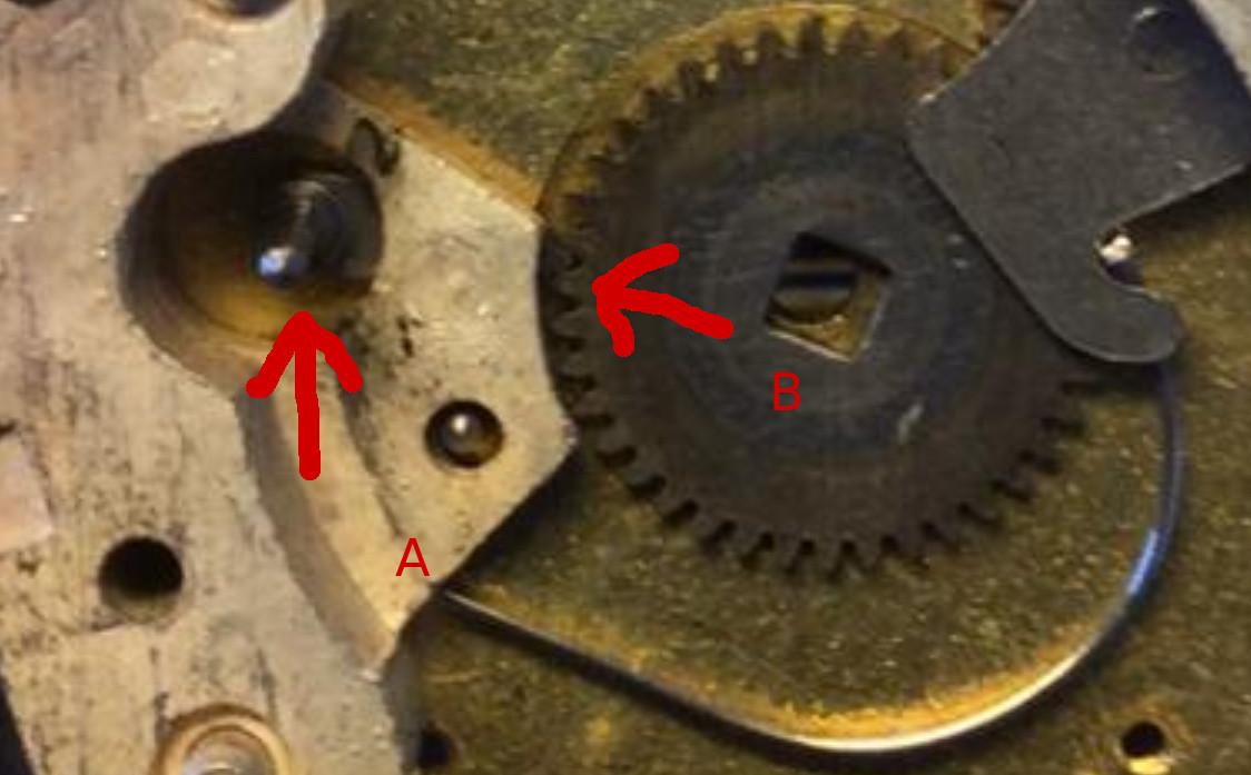

Have started to take the “mystery movement” apart and wanted to share some interior photos. It sure doesn’t look like anything I have encountered before.
For the moment I’m puzzled by the fact that there’s no obvious way to release the winding stem. There’s no corresponding screw or push button on the dial side that would losen the setting lever. Maybe it’s hiding under the “block” holding the keyless parts. But that seems very unintuitive somehow.
Please feedback if the added photos rings a bell with anyone.

I suspect you poke a pokey thing in to the hole in the top plate above "A"  and use it to disengage the latch at "B", but you do that *BEFORE* you remove the barrel. Currently everything is being held in place by that spring, and if you touch it at the moment, things may become airborne.
I get the feeling that re-fitting the barrel is going to be interesting. You may need to lower the tension on the spring slightly in order to get that square hole and the round hole behind to align as you refit the barrel. Looks like fun. :D

I think this may be what you are meant to do to let down the mainspring. Not sure if you push down on it, or twist it, but I suspect you press down while holding the crown, and let the crown unwind slowly at the same time, when the click disengages. On the other hand, perhaps you wind the crown slightly, while gripping that peg with your tweezers, then turn the peg a little further in the direction it moves as you wind the crown and the click will disengage.
All of this is fairly academic now, as you have worked around the problem anyway.
