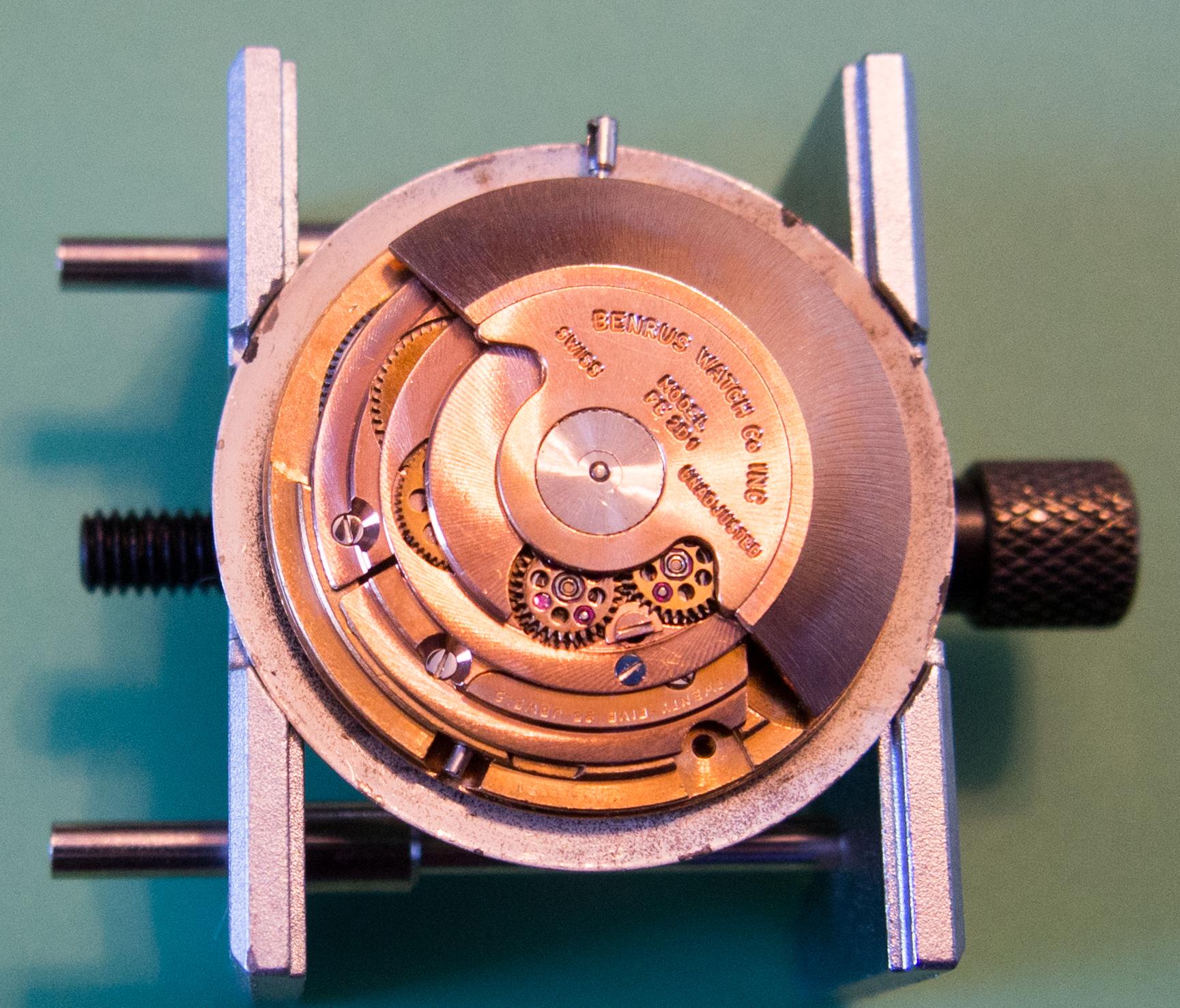

The rotor is signed Benrus Model FE 2D1. The Base plate is marked UI 2451. Which is apparently an ETA 2451. The auto-winding mechanism is affixed with blue screws - so, at least a somewhat nice movement.
I am not familiar with these. The rotor is super noisy. Don't know if that's normal for this mechanism. Or if something is wrong.
This one is going back to the seller for a "re-check". It keeps pretty good time but the timegrapher traces are all over the place. Even with the movement removed (from case) - and held directly in the timegrapher.

Here are a couple of pics of the movement...

Hi Paul, Looks clean.
ETA 2451 and its family are true work horse. Rotor should be quite, normally can,t be heard and hardly ever develops a fault, if no slack and falls under own weight, should be OK. If it rattles, check winder module, clean lube reversers.
If the rest of the watch looks good , could be for keeps.

Yes, I would normally (try to) do everything myself, but in this case, the watch was supposed to have been serviced. So, going to give the seller a chance to make it right. Having said that, I may be trying to sort some things after I get it back.
