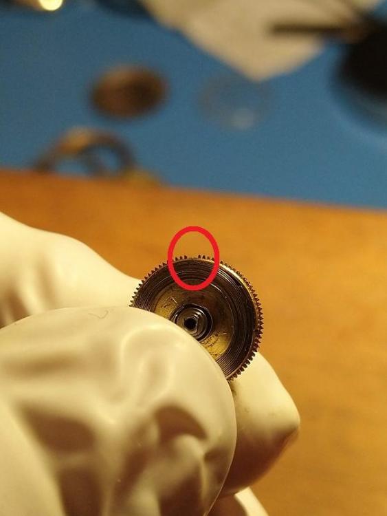

Could not go very far as I ruined the mainspring barell when I tried to put the mainspring back into its place. I must admit that I put the mainspring back with my fingers. I know that it is a bad habit and I just want to add a few more hints as why. I did not mention in my first CAL400 post, but i managed to put the mainspring into the barell the other way around when i put that together. Did not understand whats going on for a while, and with this one I pushed the lower wheel of the barell out of its place and I just cannot put it back, must source another one.
I wanted to make this one work as I like its dial. I have a Mainspring Winder actually, but i don't know how to use it or if I can use it at all for this kind of a job.

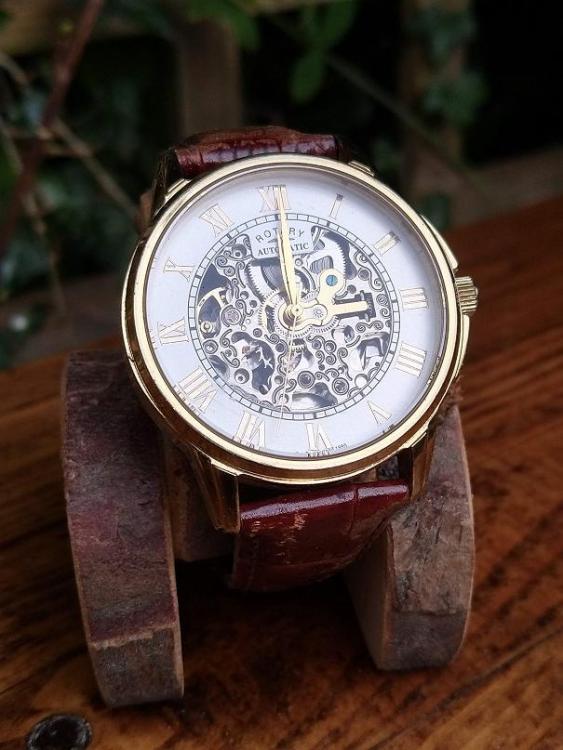

I was hesitating if I should buy this as it looked a clean and new example of a wristwatch but I liked the look of it and I had the impression that rotary is not too bad when it comes to quality. I thought it will be a win in 10 mins job but it turned into 3:10 am bed time instead. It was advertised as not working second hand fallen out. Yes it seems the watch was dropped, the escape wheel left its pivot, the second hand came off and the power released, as a result the train wheels and the main spring ate the second hand and bent it in a 90 degree angle. The shorter part of the second hand (forgot to take a picture) was stuck, I was very puzzled as how to get it out as the power remained in the mainspring locked the second hand in its hiding place, and despite to my 30-60 mins effort I could not pull it (that time i did not know that there is a part bent in 90 degree there), however after realizing that the escape wheel is not in place I managed to turn the train wheels in the other direction so the second hand was released. The plate screws were all kind of loose no wonder the escape wheel could come out like this, maybe they were worried about the screws as I managed to brake off one half of the screwhead of one of them with not much force. This movement seems like a Chinese low grade movement to me and has never seen the Swiss alps?  To be fair it is not mentioned that "Swiss Made", was it sold? Maybe its time to google it.
Edited by luiazazrambo
correcting it so it would make sense hopefully
I think I entirely failed to bid on that very watch. It does look good, but I too am in two minds about what it is.
It doesn't look like the very inexpensive Chinese skeletons, but it does look similar, which may be a mixed blessing, since if it is an auto version of the  "Chinese Standard movement", you can swap parts from almost any other one, including the non skeletonized versions, with a pretty high level of confidence that they will fit.
On the other hand, the quality of these movements varies from extremely good to extremely poor, so your mileage may vary.
https://www.ebay.co.uk/itm/001Classic-Automatic-Auto-Mechanical-Wristwatch-Black-Belt-Silver-Shell-wX/202771370401?hash=item2f361d91a1:g:m-YAAOSwRmNdVVvS
A quick study of "the cheapest new skeleton Chinese mechanical watch on ebay" (at a mere £5.99 new, shipped from China it is unfortunately £1.95 too expensive to get in to the 404 club), shows some obvious similarities and also some differences.
I do have one of those "Winners", a manual wind. These are pretty similar to the automatics. I picked it up used, so it did fall within the rules,  but I'm not at home, so I can't provide better pictures for you to compare.
There are some not very detailed pictures of it here->
I wonder if it is a "Fake Rotary", a Fauxtary (groan...). Good to see you seem to have brought it back from the dead.
Does it have an exhibition case back?
Yes it has. Everything looks rotary, the strap is rotary, the buckle is rotary, the model number is rotary. I believe you can get a new one around £100 mark. Maybe I am just un-experienced with watches younger than 50 years and maybe because it is skeleton and it gives me a different feeling. :D
I made a few pics, this is how I am going to sell some of the watches. I am afraid I have to do that if i am about to continue this nice hobby.
According to wikipedia:
"Rotary Watches' head office is now in the UK, and it is a wholly owned Chinese company. Rotary offers a range of timepieces manufactured in Switzerland, together with a range of less expensive pieces made elsewhere, usually with movements from Japan or China which are then assembled in Japan or China."
As mine is not "Swiss Made" it has to be the latter.

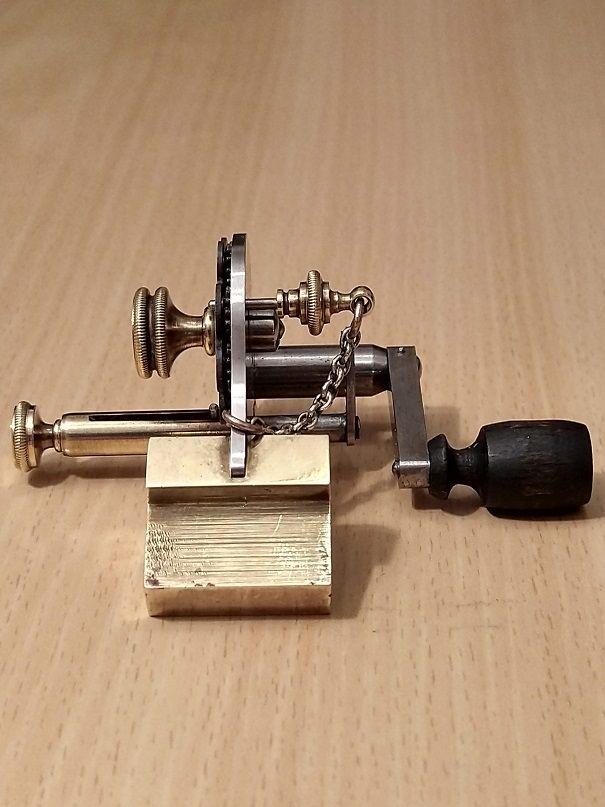

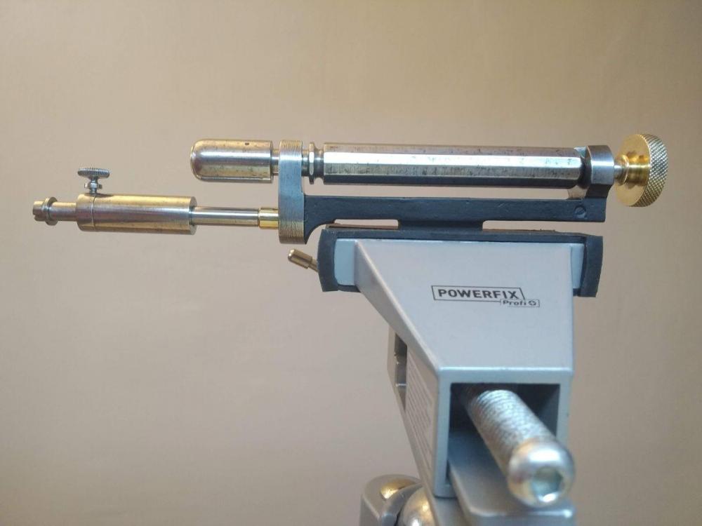

My next project is to clean up this incomplete screw head polisher. Actually I have already removed some dust and rust, but that was just some initial cleanup. What I don't know is that whats missing? Am I supposed to have those disks which actually do the polishing job with some paste? And what are those tiny bits in the red square? I watched a few youtube videos but I could not answer these questions.
correcting english

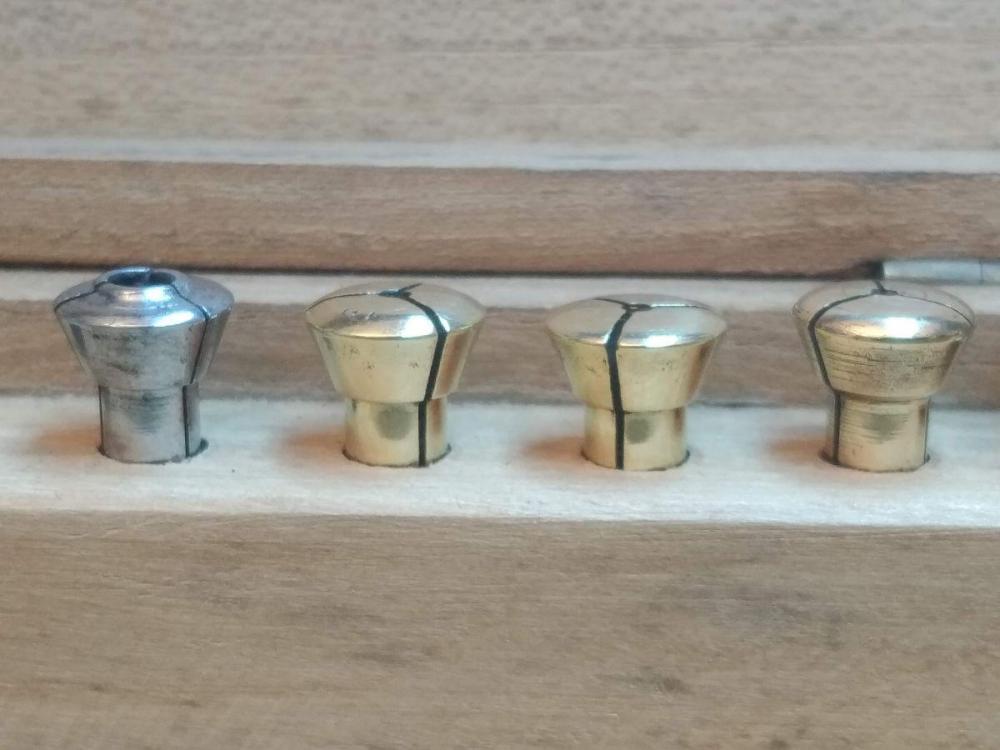

No this screw polisher does not have the wood, brass and steel polishing wheel, that is a more complex polisher.
Yours is made for using a file to clean the screw-heads, so not for getting a perfect mirror finish, but it can still acheive pretty good results.
As you rotate back and forwards the part holding the screw with one hand you run a file on the roller with the other hand to clean up the screw heads.
All that it is missing is a few more sized collets for clamping the screws.
The items in the red square are lantern chucks for screws.
The head goes inside the 'lantern' part with the threaded end poking outthrough the hole in the end. This lets you clean up the threaded end of the screw, very useful if you need to shorten a screw.
It is also useful to regrind / sharpen the balance wheel pivots on the cheap alarm clocks that just have conical pivots  that sit in cupped screws. You can do this on a watch makers lathe too, but the benefit of using this tool to do it is you can turn it backwards and forwards like a jacot tool to allow you to burnish / harden the pivots which you cant do on a lathe.

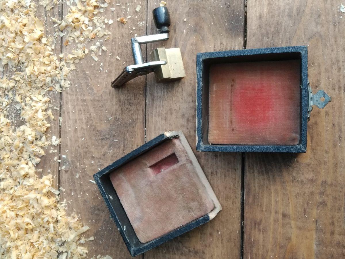

New project, a bow milling machine from Germany. Mr Deutsches Reichsgebrauchsmuster Nr 30400. Incomplete as two gears are missing, but will do my best to restore it as much as I can.
