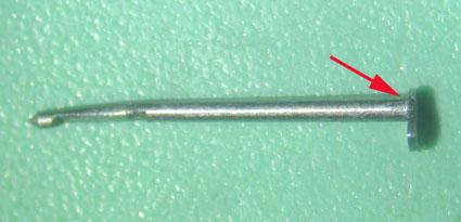

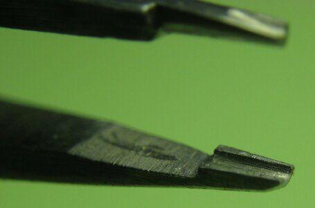

Today I received from Cousins UK the size 00 Dumont overcoil raising tweezers for the  'tiniest' hairsrings - see below. When the insert for adjustment of the hairspring thickness is fully closed there remains a gap that is larger than the thickness of a typical 11.5 lignes hairspring. The last photo shows this gap and the tip of the hairspring.
As supplied, because the hairspring is not held firmly enough in the gap, the tweezers twist the hairspring when the raising bend is made . Conclusion: for these hairsprings, and anything smaller, the end tip of the tweezers must be re-worked to close the residual gap. Swiss made but not Swiss quality.
On 6/5/2020 at 3:56 PM, nickelsilver said:
That's a shame, but looks like and easy fix with an Arkansas stone.
This 1200 grit diamond wheel produced a nice square end to the tubular section. But I then had to countersink the end of the tube by a small amount because the sliding inner part has a radius in the region arrowed. Finally I had to dome the end of the locking screw. As supplied it was flat and tightening the screw increased the gap as it pushed the inner slider outwards. I wonder if these tweezers are second sourced from India?
