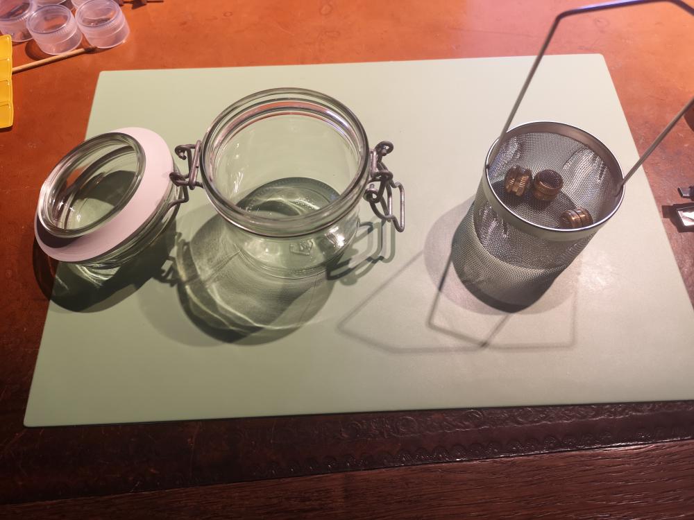

With regards to making the basket I had a similar idea as HectorLooi posted above with his photos (link to video is faulty) in the sense to use something that is commercially available.
For a basket I found this on Cousins and it had a snug fit into a glass jar. Probably too snug as I note the real machines have a stainless steel mesh around the container walls to act as a wave/current breaker. Off-cuts of stainless steel mesh can be sourced fairly cheaply. Pots like this can be sealed off really well.419111418_IMG_20210214_0944331.thumb.jpg.f2ef6eeaaa6b4a78d8b9cae567e8530c.jpg1802805749_IMG_20210214_0944531.thumb.jpg.7b5ff2c5bafb0f0f7e6536cb21e00086.jpg
I suspect the basket would need a lid to avoid the parts becoming unintentionally airborne but if that lid is made of plywood for example it could serve as a float in an ultrasonic bath?
I have not got a drill press but a cordless drill which has a reverse could work or a small electric motor powered by a 9v battery? The amount of torque required is minimal.
