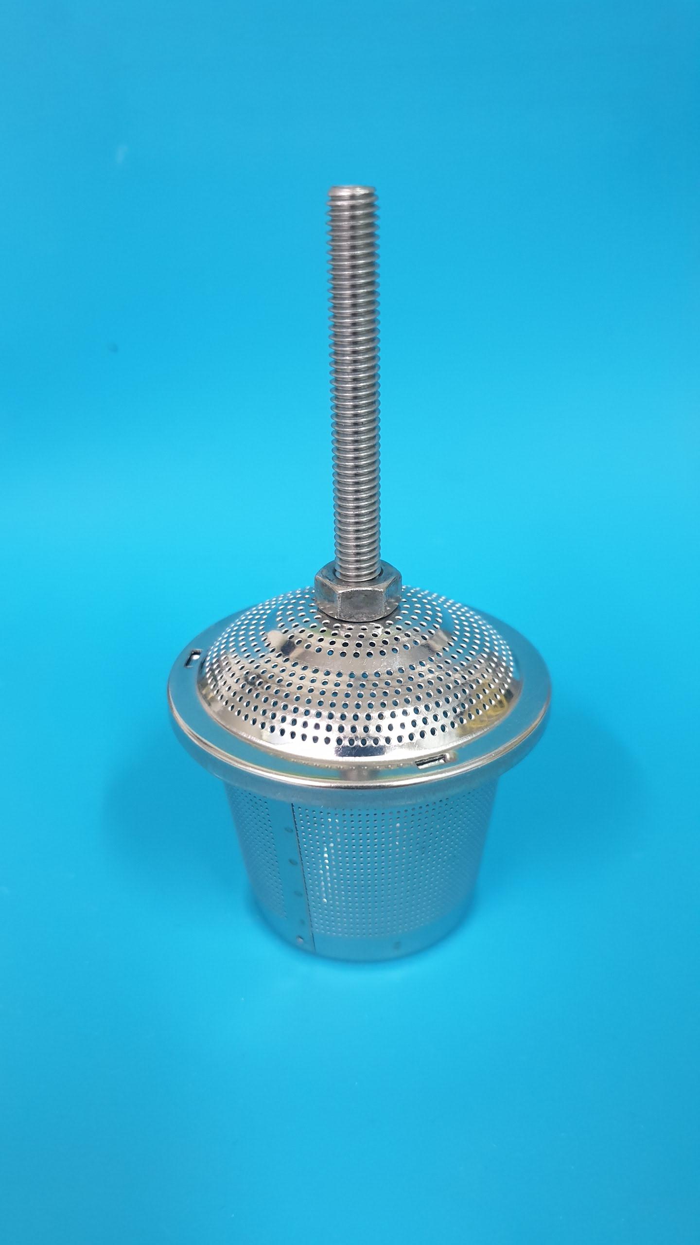

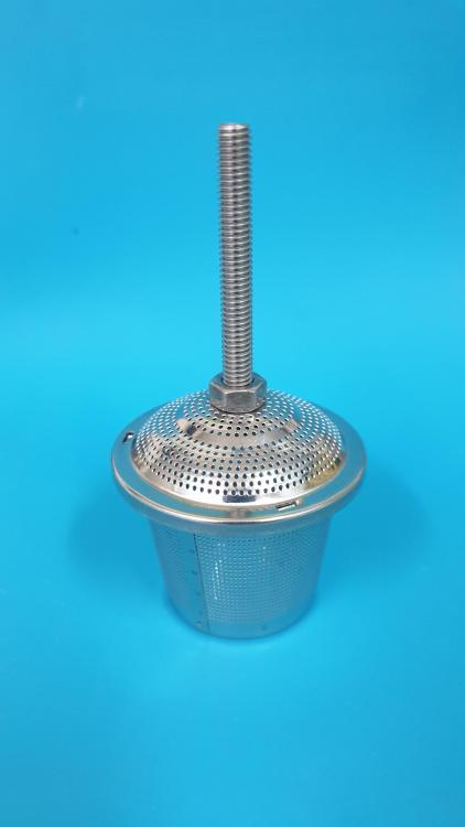

Just sidetracking a little. Here is a cleaning basket which I made from a tea strainer. I fix it to my drill press and spin it in a jar of cleaning fluid. Works pretty well.
You know, I wonder if I could adapt a micro-mesh single-serving reusable coffee filter to the same purpose. I keep ending up working on large (50 & + mm.) Swiss pocket watch movements that would not fit into smaller cleaning holders.
But they might fit in a coffee filter.
You gave me an idea, sir! Thank you.
Could we have dimensions here please?
2 hours ago, luiazazrambo said:
Okay, so what now? Do you keep your coffee warm now or do you clean watch parts? :) We are thirsty!
Haha. I don't drink that much coffee anymore. It gives me the shakes. Sometimes a late afternoon cuppa will keep me awake till 3am. :startle:
I'm still waiting for my star shaped stirrer and larger tea strainer to arrive from AliX.
The base is about 30mm, the opening of the basket is 50mm and height with cover is 50mm.
