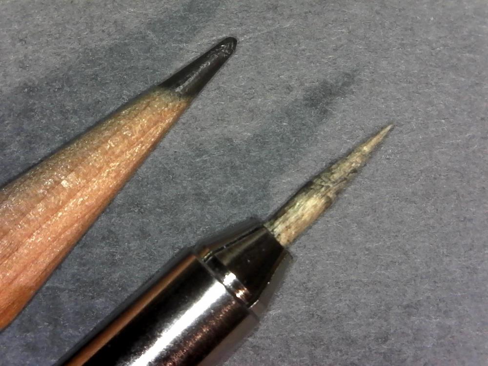

Try getting yourself a couple of mechanical drafting pencils and a sharpener. These can really put a fine point on pegwood as shown in the photo compared to your standard No. 2 pencil out of a desktop sharpener.
sharpener.thumb.jpg.49a5bddfbb81972d6d199761fc1e9100.jpgS20191103_0003.thumb.jpg.76a33e311b2158f993c53203317b1278.jpg
